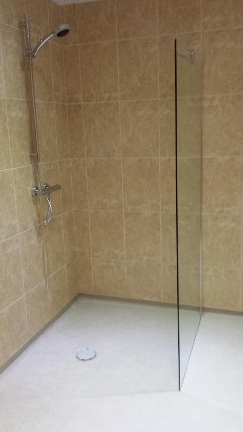

Use them everytime now, they have a rotating waste hole so you can avoid joists, they can be trimmed and can be fitted direct to joist without underboarding
So you liked the Impey tray NGI. Great arent they. Have you tried the Impey tanking solution?
victoria plumb its a great place
, always go for the thickest screen glass you can (think thats 8mm) 10mm is the best
