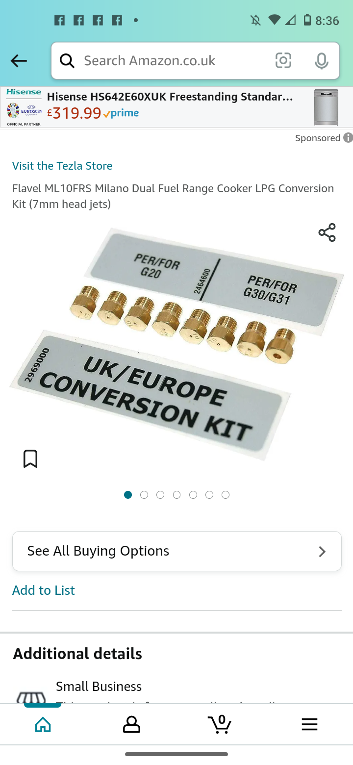

I'm not at home. Im away working but had someone pop in while I'm away who said I need to buy these. They where supposed to come with it when it was bought and changed from natural gas jet to an lpg jet but wasn't changed.
He's a gas engineer!

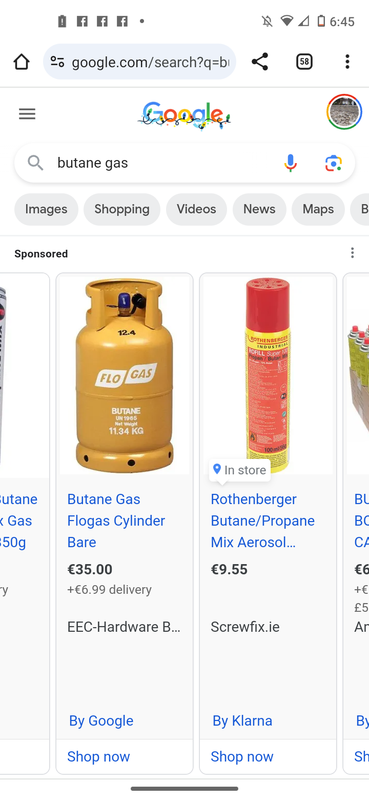

When you say you use LPG, do you mean the big 47Kg bottle outside or the small canisters you get with camping stoves?
Either way, you need to get a fully qualified engineer out to examine the whole appliance and let him decide what the problem and solution is.

I think they are 11kg. The ones you can lift and put in back of car.

11.34kg butane bottled gas. Same as in picture.

If it has the natural gas nozzles in the rings and you are running it on lpg the mixture is absolutely guaranteed to be wrong.
Get it fixed before you use it again.
