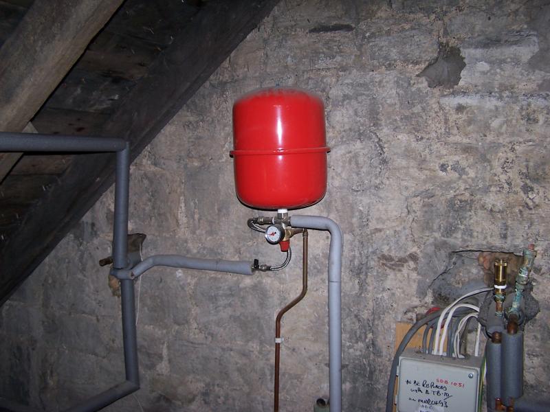

What is this and what does it do?
11 May 2008
2
Hertfordshire
Can anyone help me identify this piece of kit - found in the loft of our new house. Only suggestion received so far is "water pressure balancer" - if that's right, how should I use it?
expansion vessel with filling loop attached.
you have a pressurised heating system and that is how you fill it up. should have between 1 and 1.5bar pressure when system cold. a 1/2 to 1 bar pressure rise is normal when hot
whats that on the right hand side? looks like two aav's right beside an old fuse box!
