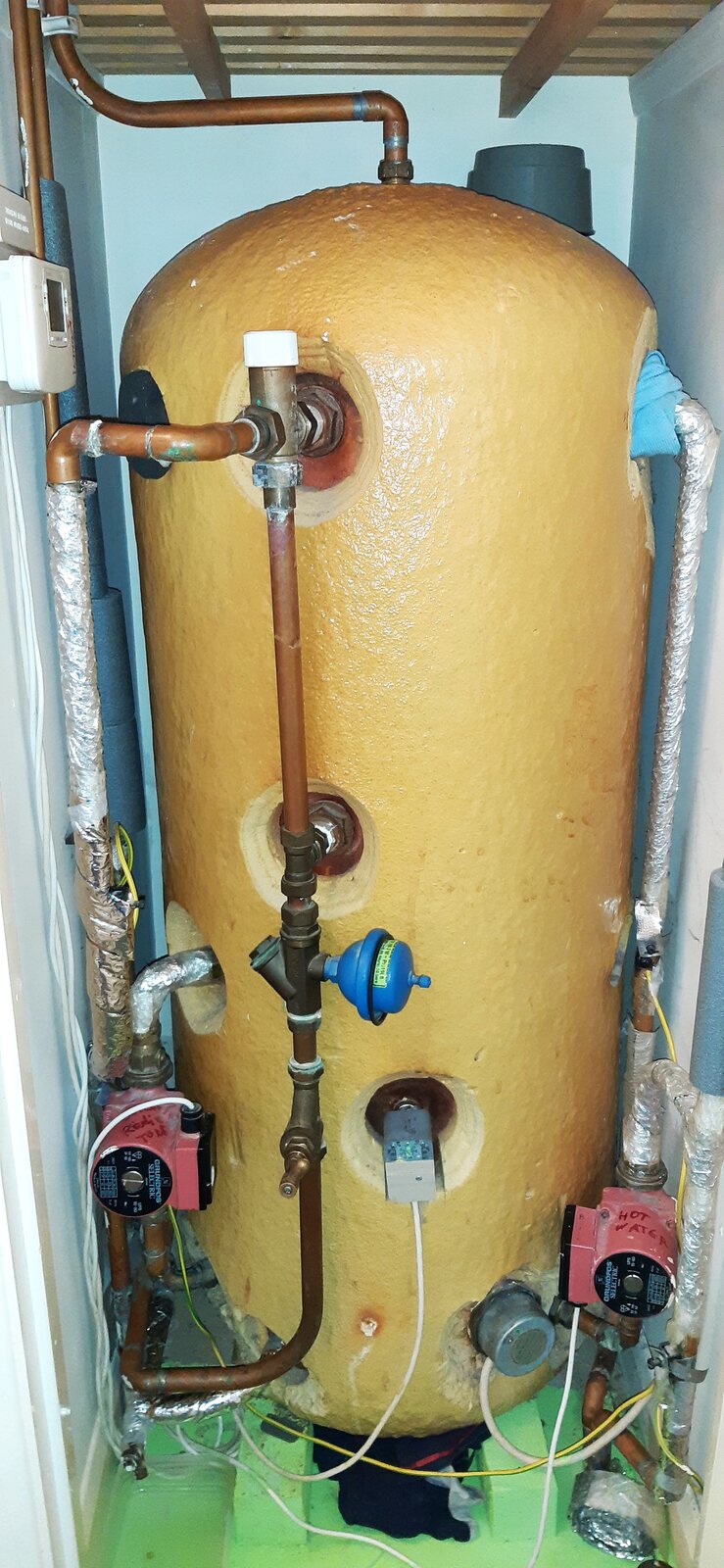

This is my cylinder, it is 35+years old and has worked flawlessly until now with very powerful high pressure water, 2 showers on no prob. Anyone know the model? Btw it can run the whole system on electric only if boiler is broken.
But we have a weird problem now, took me a while to diag - the blending valve - white cap thing on top has failed and it does not let the how water come out, so even though its full of hot water you only get cold water come out. I have located and ordered the part Overtrop XC007.
But how do I change it? Water does not seem to drain if I close the cold inlet gate valve and open hot water taps. There seems to be no cock anywhere to let air in the system from top. No drain holes apart from the one bottom left - which is infact for the primary water. The pipe on top of boiler seems to be just the breather pipe of the primary water circuit - as I found by knocking - which goes through the cylinder for some reason (probably used for internal pressure safety venting).
So I wonder if I stop the cold, open hot taps and and try to remove the blending valve - will I get a 50l splash of hot water from the tank head above it ?
Also I'd really like to know the exact path of waters in this tank, say why the radiator pump pipes on the left go in and out of the tank, when the right pump is the one heating the water.
