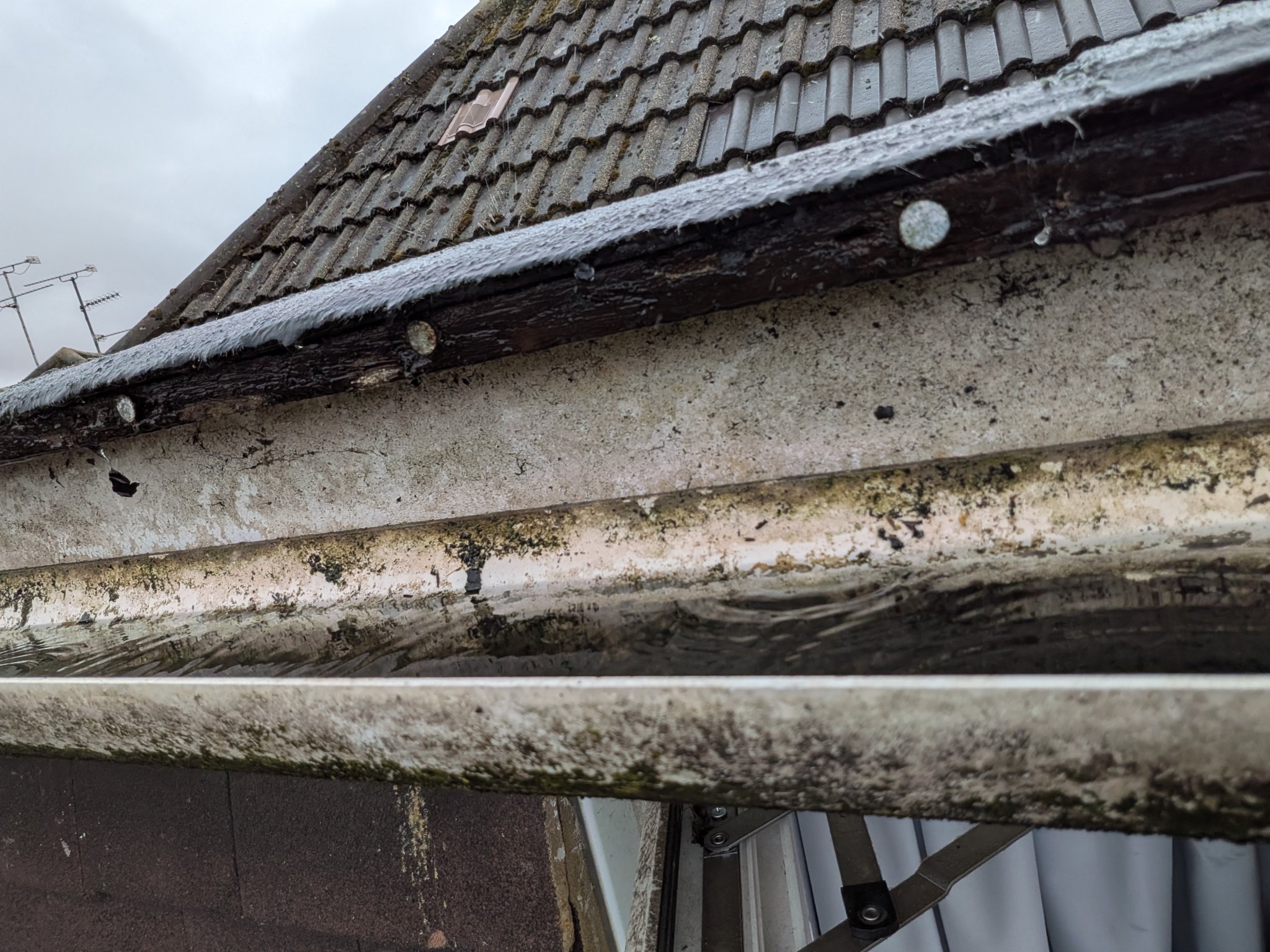

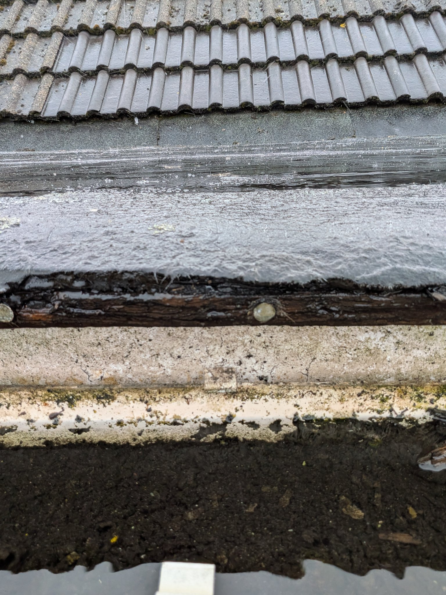

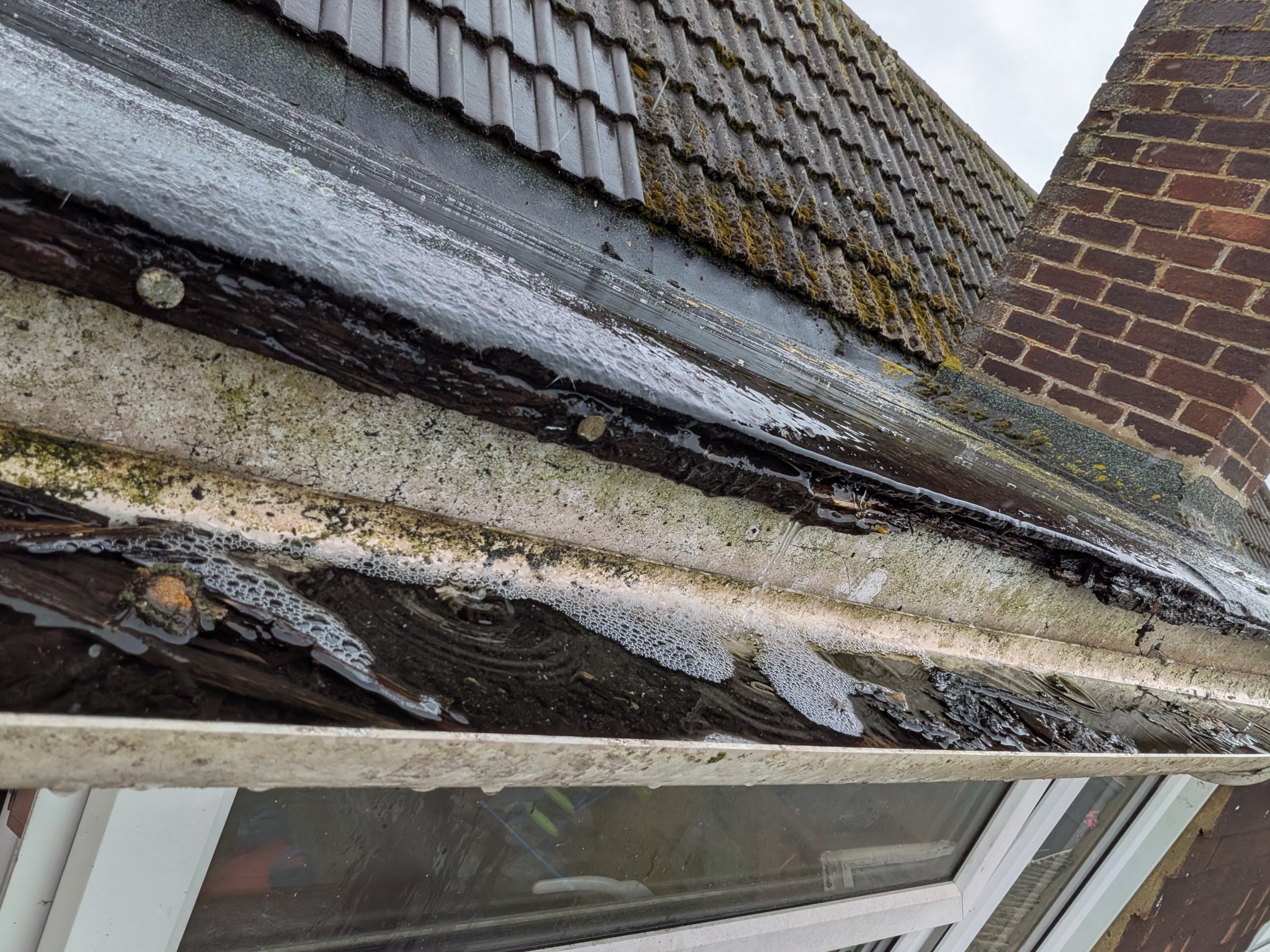

Hi
The edges on my flat roof have ripped as they were poorly installed.
I need to know what product to buy and how to install it...
It needs to half go over existing felt and half go over the timber on the drip edge.
Any help is very much appreciated

From what you’ve described, the damaged edge really needs to be repaired with a compatible roofing membrane rather than just covered with sealant or flashing tape.
If the existing roof is felt, I’d normally cut away any loose or badly torn material first, make sure the timber and existing felt are clean and dry, then install a new strip of suitable bituminous roofing felt/membrane. It should overlap well onto the existing roof covering and continue over the timber at the drip edge so water can’t work its way underneath.
Depending on the type of felt you already have, this could be done with a compatible cold-applied/self-adhesive membrane or a torch-on repair. I wouldn’t recommend torching directly around exposed timber unless you have experience with it because of the fire risk.
The important thing is also to find out why the edge ripped in the first place. If it wasn’t properly bonded or mechanically secured, simply sticking another piece over it may result in the same problem later.
If you can upload a couple of close-up photos of the damaged edge, plus one showing the whole roof edge/drip detail, I can give you a much better idea of the correct repair and what material you’ll need.

All of that sounds sensible. Could you advise on what products to buy to apply it without torching it?
The issue occured because whoever put it up originally just folded the felt over the timber board with no batten so eventually it tore at the edge. I will replace the edge board and fix a batten for the drip edge to prevent this happening quicker than necessary. The rest of the roof is pretty good condition otherwise.
If you still need pictures, let me know and I'll take some later.
Many thanks
