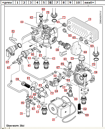

Can any boiler engineers tell me what part this is called please? So I can order a new one from Glowworm.
Its just in front of the heat exchanger, a plastic housing that goes to the hot water pipe.
Stated leaking last night, a microscopic hole/split.
What you can see is my Mad Max temporary seal. :oops:
Trying to see if I can get hot water over christmas temporarily. Tried sealing with Araldite resin and waiting to see if it will hold once its gone off.
Worse case scenario is no hot water over Christmas, :( heating is ok. I got the cold feed turned off.
Oh the boiler is a Glowworm 35Ci

Looks like it's your Sani-block

Selected Product:442311
Quantity Job reference
(optional)
Description GWORM 802131 SANI BLOCK
Manufacturer's product number : 802131
Retail Price
(Excluding VAT ) £148.174
Pic coming.
Hope your araldite holds!
Part 88
They're altered it because there were so many splitting.
Not nice to change...
:( I have found out about the split!
Maybe my araldite will hold better than the original! lol
