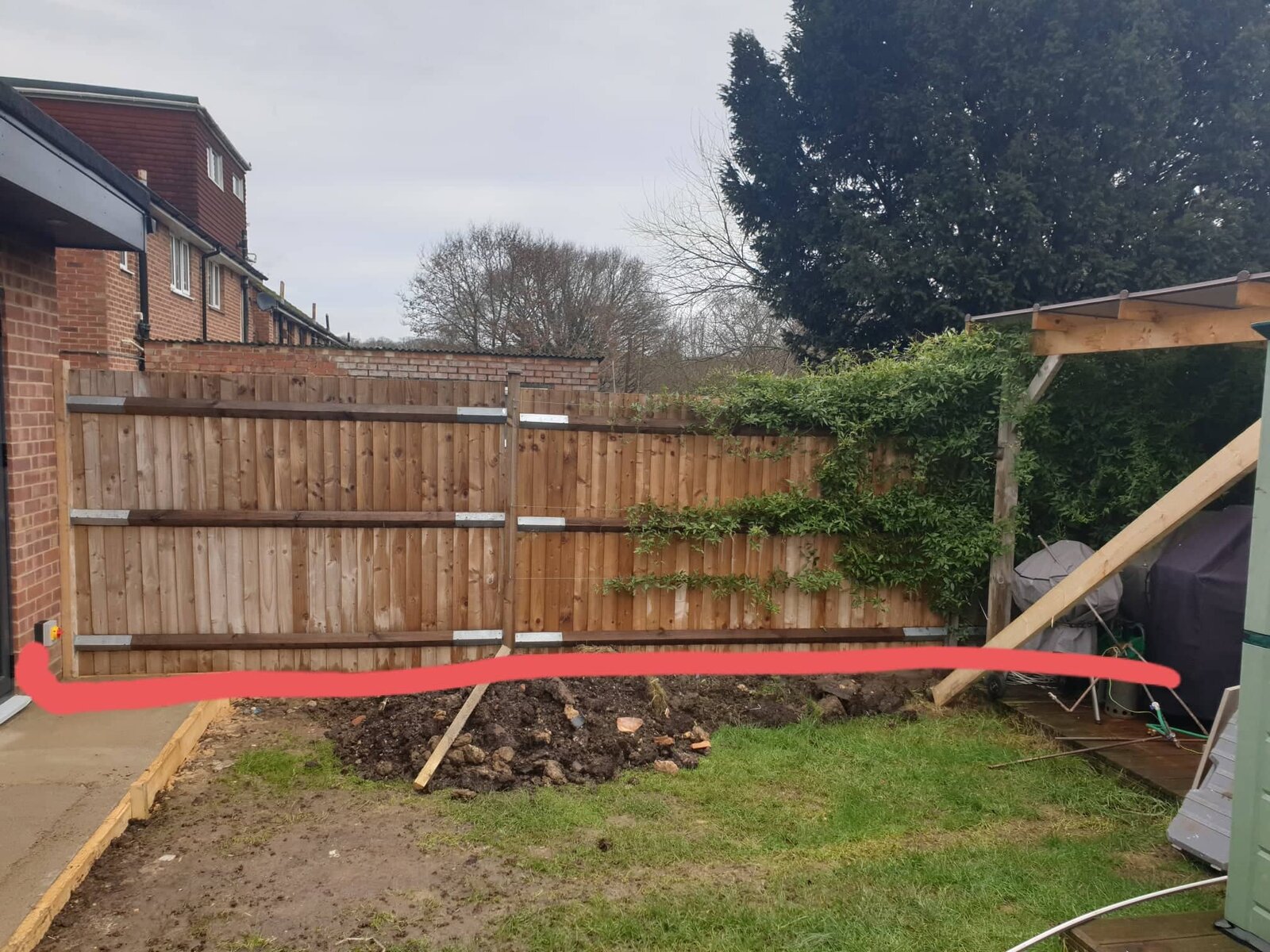

What size armored cable do I need to put a supply for a 32A hot tub to my decking.
We have a 32A feed going to the outside wall that we had terminated at an isolatior.
Now I need to run the armored cable to the bottom of the garden where the hot tub is going to go.
It about a 10 meter of cable run.
Thanks for any help.
What power rating is the hot tub? 4mm should be ok has the circuit got RCD protection or does the hot tub come with it's own device?
Only ever installed one hot tub & the manufacturers instructions demanded 4mm even though 2.5mm would have sufficed. What do your installation instructions say?
Not bought the tub yet but want to make sure that I dont under rate the cable.
Most we are looking at say they need a 32A supply.
And yes its RCD protected at the fuse box.

As has been said, if it needs a 32A supply, then it needs at least a 4mm² cable. However, you're right in that distance is also a factor (because of potential 'voltage drop' issues) - so if it were a very long run of cable, bigger cable than 4mm² might theoretically be needed.
As has been implied, if the circuit is protected by a 32A MCB in your CU, then the cable would have to be at least 4mm², no matter how short/long.
