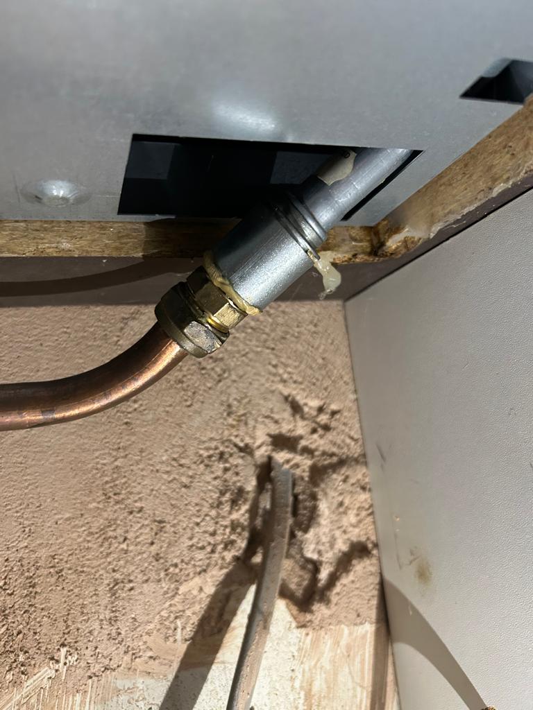

What sort of fitting is this? Bayonet?

Daughter is fitting a new kitchen, or rather her long suffering husband is.
They've comne to take the existing hob out and come across this. We suspect it is a bayonet type but the gas putty points at another direction.
The chap who had the house previously was, and employed, every bodger known to man.
The gas is isolated by a valve, so assuming the silver fitting is spring loaded, once the putty is broken should it just pull back and llift off?
Cheers.

Gas cookers (that you can drag out to clean behind) usually have a rubber gas hose with a bayonet fitting.
Gas hobs are fixed, and do not. It is not a DIY connection. You need a gasman.
They're replacing the hob with a range cooker that will have a rubber hose with bayonet fitting. Just wondering if this is a bayonet that has been gummed up with paste. Definitely will be getting a Corgi reg guy in if any permanent joints need doing.
Fair enough. What do you reckon a plumber would charge to fit a bayonet fitting to existing pipe? They're based in Derbyshire.
Hobs have to be on a rigid connection, that will need to be disconnected by a Gas Safe Engineer.
Impossible to say what anyone would charge to provide a Bayonet Coupling without seeing the job. Also would depend on the outcome of the required tests on the rest of the Gas installation in the property.
It's not just fitting a hose, it will also be testing tye gas installation
With and without your new appliance.
The pipe may need altering so as the cooker goes fully back.
A stability bracket or a chain will need to be fitted.

Currys aren't going anywhere near it. Ringing a guy tomorrow to alter pipework, commission the new range cooker and associated testing.
