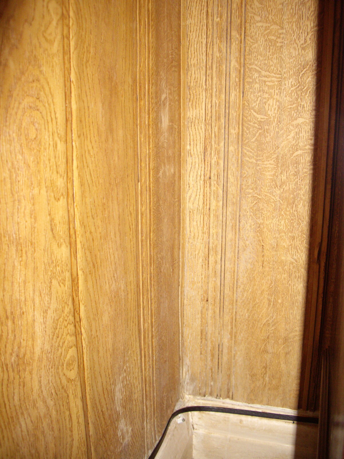

I'm looking into decorating a living room where one wall is cold and subject to damp. It's a gable end in an old house with some sort of wood panel paper that's plastered on to the surface. Mould has got hold of the surface at the bottom in each corner beside the chimney breast so i'd like to get it sorted asap.
I've talked with a chap who recommends removing the plaster back to brick, replastering and then using a specialised paint to cover the wall which will allow the area to breathe. Is this a good idea or should i tank the wall instead as the wife would rather have wallpaper in the room.
It's a cavity wall with about an inch between the inner and outer wall.

That's all very interesting but i ran a dehumidifier a few days ago and removed about half a litre of water from the room. I wipe down the affected area once a week to keep it under control but ideally i'd like to solve the problem.
What would you recommend - removing the paper and replastering then painting the wall, or tanking then papering wall?
Warm wet air meeting a cold surface will condense.
So you solve the problem by some combination of reducing the humidity in the air and increasing the wall temperature.
So either removing the paper and replastering, or tanking then papering, whilst all very interesting, will not solve the problem.
What's the state of the wall on the outside?
An inch is not a useful sized cavity, it may not technically have been built as a cavity wall. External render, painting or treatment may be required if it is an exposed location, facing the prevailing wind.
Also, what's the external chimney and stack like? Is it capped or in use?
Well, the paper is in poor condition and really needs to be replaced so i'm looking for the best way to do the job - my question is whether or not to have a specially formulated paint applied to new plaster or a tanked wall, papered. The old paper has a kind of plaster backing that adheres to the wall so it's going to remove some of the old plaster when taken off, i'd have thought.
The outside wall had some kind of plastic applied, then painted years ago. I don't know the process or treatment to give a name to it but the gable faces south which i don't think is a prevaling wind. It's just in a shaded location where the wall stays cold all year round. Even in Summer it stays cool to touch. The chimney isn't capped nor is it in use and a plan to put a vent into the top of the blocked out chimney recess is in the plan.
