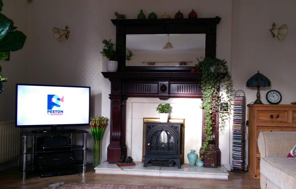

What it says, really... it's a bit dark and oppressive, dominating the room.
Anybody know if these are made of solid wood, which might look better stripped?
Or better still, has anybody got direct experience of actually doing anything with a fireplace like this?
Thanks :mrgreen:
It's possibly in two parts. I'd be inclined to remove the mirror, and use a multi surface paint on the lower part. You'd need to find somewhere discrete to maybe drill it and see what it's made off, but I doubt if it's strippable.

Depends how old it is. If its old it could be solid mahogany, if newer it might be mahogany veneer over chipboard. I think it looks lovely with the overmantle on it as well.
it's large and grand, but to my eye it says "modern repro." The finish is very red but unfigured. If it was old it would probably have been painted white by now, and might have been grained pine when new.
How old is the house?

It's Vintage 1994, and these houses were quite expensive when built, so might well be mahogany - even the garage rear door is :eek:
Yes the top bit comes off, but I've kind of got used to it now, like those Victorian fireplaces everybody ripped out and threw in the skip back in the 70s, then paid fortunes to salvage yards to buy them back in the 90s...
It's just so DARK :eek::confused::mad:
if it is solid (I doubt it) it will not be mahogany but might be "mahogany" some tropical hardwood such as Meranti or Sapele that can be dyed and look quite nice.

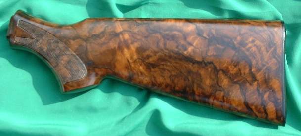

Figure is the shape and colour of the "grain." It may be dead straight, or it may have burrs and swirls. More figured wood is more prized, and may be used for cabinetry veneers (also for expensive gunstocks, musical instruments, and the like).

AH gotcha - I used to shoot a lot, and "burred walnut" was the thing to have.
If I remember correctly, it was taken from near the base of the trunk, where walnut had a habit of producing thousands of little side-shoots, which made for lots of swirls in the wood... I expect this is plain though.
If it's red wood, well, guess I wouldn't want to strip and expose it, really... wouldn't go with the rest of the room. SO I suppose it's leave it as it is, or paint it... inertia will probably prevail...
