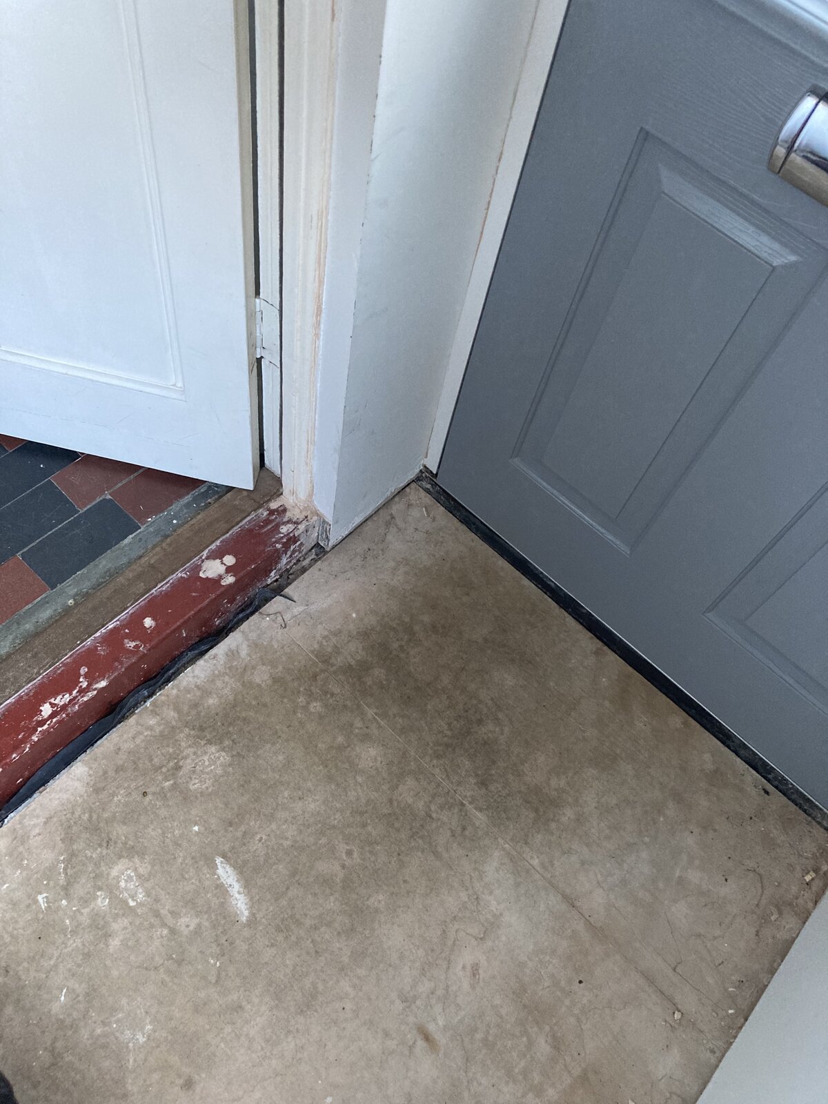

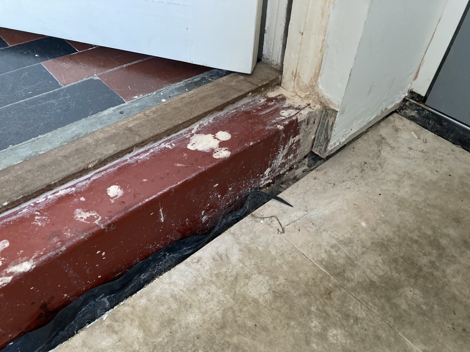

Any suggestions for how to finish this?
Want to have a recessed mat behind the front door but don’t know what to do to finish the little step into the house.
Walls either side of the little step have had plasterboard added to them.
Paint it or tile it.
You can also buy aluminium angle strip and cut to fit as a cover

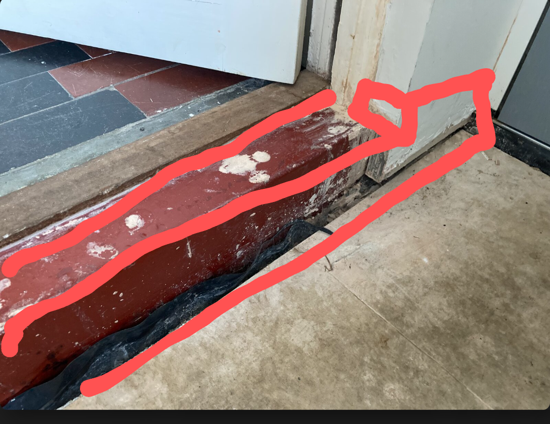

My concern is that it’s set back slightly from the wall each side (which I plan to add skirting to). I can’t visualise how I’ll deal with it being set back
Pack out the front with some wood then cut skirting to height at the door opening only and run skirting straight across.
Then you only need to cover the top
