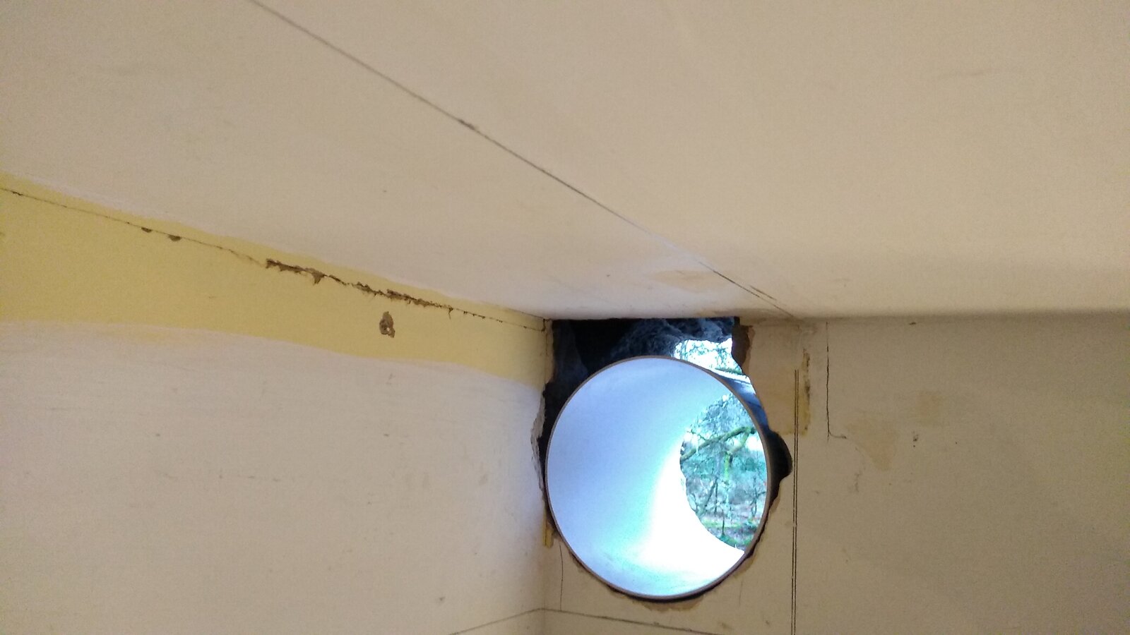

I'm in the middle of putting up a kitchen extractor. The cooker is on an internal wall, so the ducting takes a right hand turn above the hood and runs for a meter and a half or so to the nearest outside wall. The previous hood had small rectangular ducting that exited bang in the corner there the two walls and ceiling meet. The new ducting is round and much larger at 6"/150mm diameter.

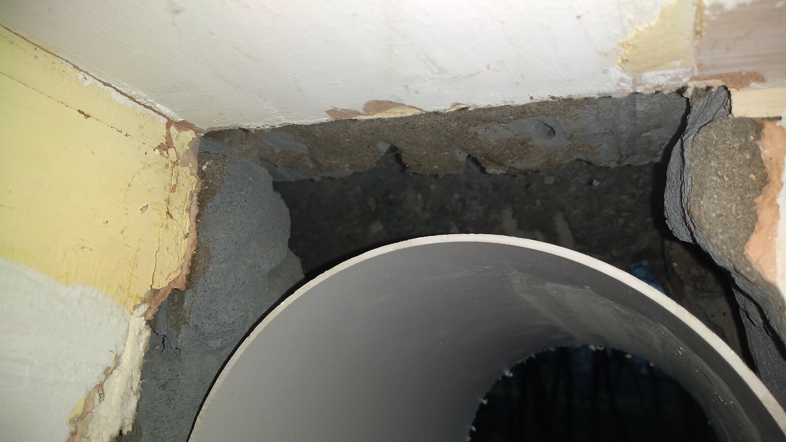

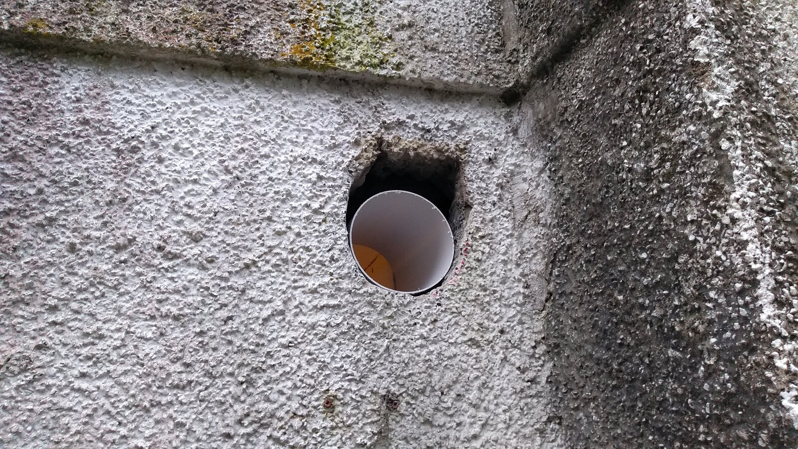

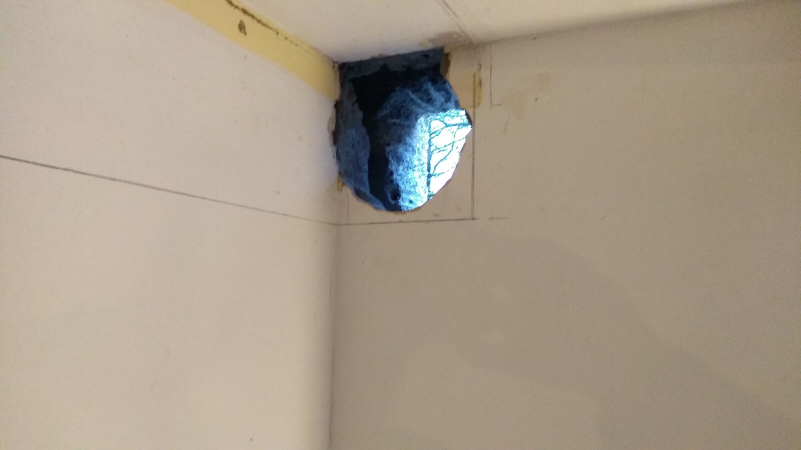

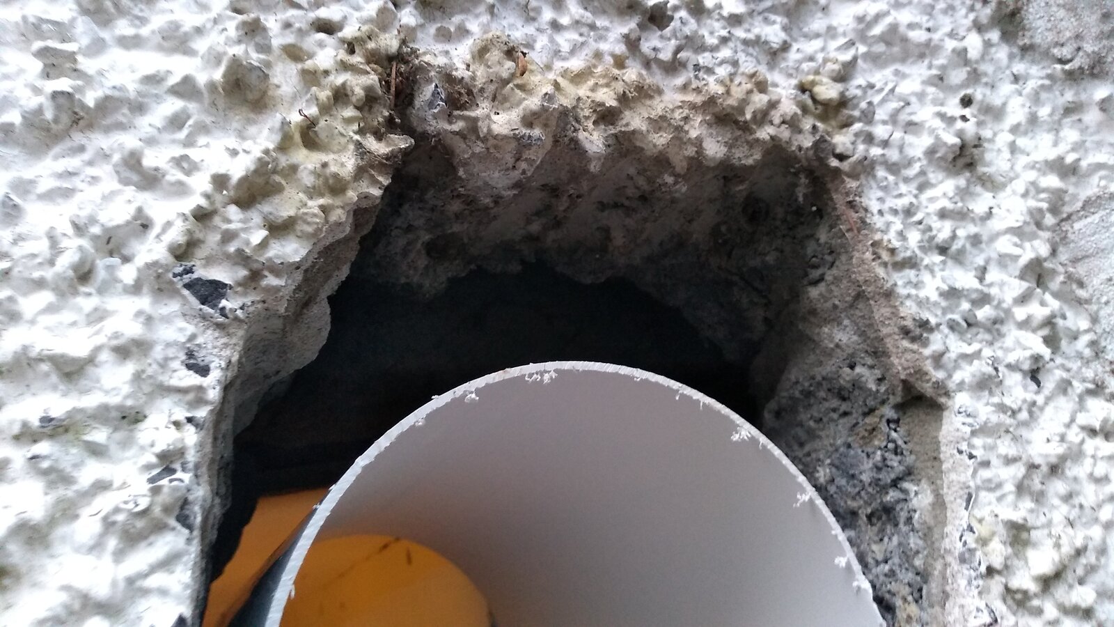

I've made the hole in the wall, but because of the previous rectangular hole I'm now left with three quarters of a nice round hole, and a quarter of a large gap where the previous hole was. I feel reasonably sure none of that make much sense, so there's plenty of pics below from inside and out. As you'll see, it's a cavity wall.
I'm guessing/thinking I'll need to fill the large gap with the ducting in place, but let me know if you think otherwise.
But more to the point what's best to use? Mortar? Expanding foam? Or???
And does it matter if I bridge the cavity seeing as it is right in the corner and the ducting bridges it anyhow?

Many thanks for the replies.
I'll go with that suggestion then and use expanding foam in the central parts of the hole. That will be easiest too because it will be very difficult to reach those area with sand/cement or anything else. I'll then finish on the outside with sand/cement and on the inside with filler.

As it is a cavity wall, you want to prevent mortar or other material falling down inside.
You can do it by stuffing mineral wool loft insulation into the gap, followed by a piece of cardboard (it is easier to pick off fallen material from the smooth cardboard)
If you are doing a neat job you can build up the wall with layers of mortar, packed against the pipe, and you can rotate and pull out the plastic pipe after each has stiffened. At least the outer wall should be mortared for weather resistance and reasonable appearance. Do the outer wall first. With a 6-inch pipe you can put your hand through and smudge it with your fingers and a filling knife if you do not have ladder access. A trowel and brush will be rather awkward.
if you set the duct with a slight outward fall, rain and condensation will trickle outwards.

That's some good points RE the cavity. I guess I thought that a small amount of bridging in the top corner wouldn't do any harm but am I wrong? Do I need to avoid it totally and at all costs?
RE the insulation to stop mortar etc dropping in the cavity. Would it be ok if the insulation stayed in place permanently? It would only be a small piece. I know there should be an air gap and it shouldn't bridge, but it would be a lot easier if I could just plonk it in and leave it there...
I try not to bridge the cavity at all.
My house has CWI so I roll up the quilt into a sort of collar, larger than the pipe, and stuff it into the cavity. it is then tight enough not to get dislodged by bits of rubble or mortar, and will hold them so they can be picked out. But it is easier to clean a bit of cardboard.
the blown fibre loose fill cannot be relied on to hold rubble or dust, but the collar can. I leave it in place. While you are working you can wriggle the duct free to clean out dropped mortar and tidy up the inside. If you have a bit spare I suppose you could make a half-pipe which would be easier and would collect its own scraps. Occasionally I have twisted and pulled the duct out from the mortar afterwards, if the jointing spigot is too tight. It seems to me that the outside brickwork leaf needs to be filled best, to keep the weather out.
the insulation will also prevent a cold spot, which might attract condensation.
