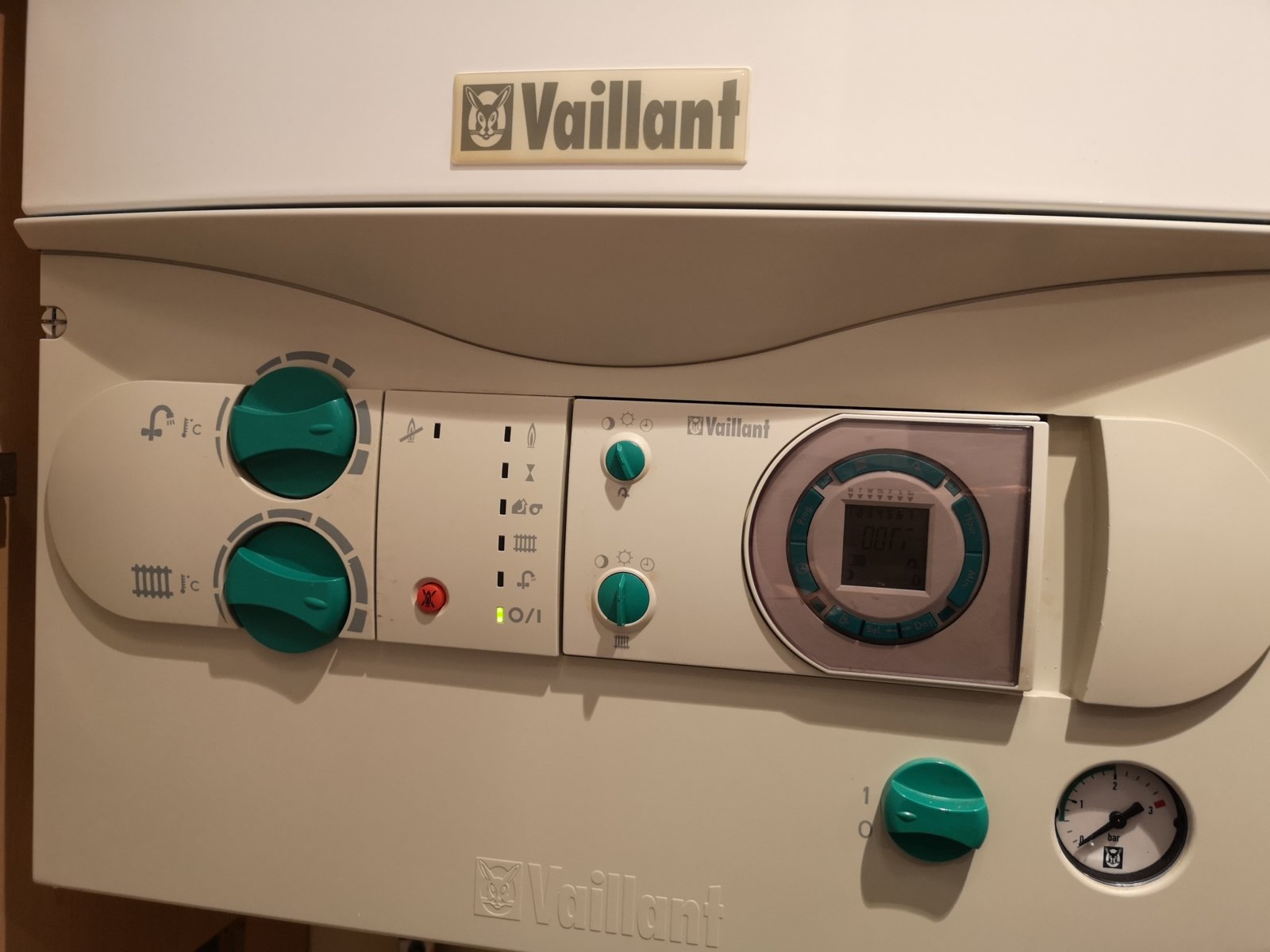

What type of Vaillant boiler is this?
14 Nov 2019
Hi,
I have just moved in and am struggling to find the user guide for this boiler. Could you please help me with this?
Chris
Well, its obviously an older combi and it has no pressure so needs topping up before it will work at least. They often have a label stuck on the bottom with the model designation on it.
Think that's a Turbomax Plus. Rotate the two big plastic screws on the edges of the panel by quarter of a turn and it will fold down. The data badge should be on the back of that
