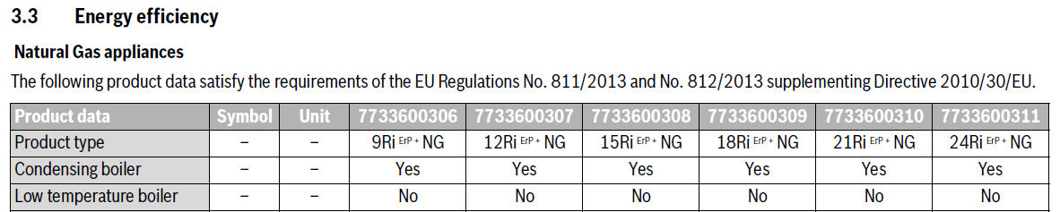

I got a Worcester Greenstar 24Ri boiler with my house and I'm looking into making it as efficient as possible before taking the plunge at some later date to get a smarter boiler like a two pipe Intergas HRE 18 SB with weather comp and PDHW. But short term, I want to resize my radiators upstairs to accommodate low temp heating. (downstairs is UFH that runs on 55deg max). The smallest CH pipes I have are 15mm feeding the radiators. Plenty of 22mm pipe otherwise, so other than a few undersized rads, I should be able to run low temp heating at 55deg. The 24Ri is a basic regular boiler that doesn't even have clear markings for flow temp output. Just a dial with markings of 35degree min and 82 deg high. Max output is 24kW and (I might be reading the installation manual wrong) min output is 8kW. Not sure how much modulation this boiler can actually do or if it's just full power on or off for timed intervals, depending on what temp flow you set the dial to.
Looking through the manual it explicitly says the boiler can't be run on a low temp system. See image below. Anyone suggest why this may be? I was planning on measuring the surface temp of the flow pipe to get a gauge of where 55deg flow would be and manually setting and monitoring temp to keep it in that region.

I found this definition. It sounds like it might be something to do with EU Regs:
Low temperature boiler: A non-condensing boiler designed as a low temperature boiler and tested as a low temperature boiler as prescribed by the Boiler Efficiency Directive (i.e. the part load test was carried out at average boiler temperature of 40°C)
https://bpec.org.uk/downloads/CE30%20-%20Domestic%20heating%20by%20gas.pdf
So you reckon it might just be a bit of beaurocracy? EU regs consider a "low temp boiler" to have an average flow temp of 40deg and be "non-condensing"? So because the 24Ri is a condensing boiler its not classed as as a low temp boiler?
Doesn't make sense to me why a low temp boiler has to be definied as non-condensing. But anyway, the 24Ri should technically be able to run a system at 55deg flow right?
Ultimately it comes down to what is considered to be low temp. If the boiler wasn't able to run @ a 35deg flow temp then the boiler wouldn't be able to be adjusted down to that temp by it's controls, to me it really is as simple as that. My understanding though, when a low temp heating system is mentioned, is a system that can be run between 55>35deg and will constantly condense.
Of course that will have a significant impact on the radiators output, if the heat loss calcs and rad output sizes were originally calculated and surveyed @ ΔT50
“low temperature boiler” means a boiler which can work continuously with a water supply temperature of 35 to 40°C, possibly producing condensation in certain circumstances, including condensing boilers using liquid fuel;
Rads are sized for ΔT50 so I'll have to upsize but just confirming the 24Ri boiler would be alright to run at 55deg max flow before I commit to buying larger rads. I assumed the boiler would be able to until I saw that line about low temp boilers in the manual. But shouldn't be a problem cause the boiler can be manually set to temps between 35deg>82deg and is condensing.
You should have no problem In running the boiler at 55C if the dT is 10C to give a return temp is 45C, you will have T30 rads with 51.48% of their T50 rating,. At 8.0kW output, the boiler flowrate must be 11.47LPM, 0.69M3/hr. If you run with dT of 20C, flow/return, 55C/35C, then you have T25 rads with 40.61% of their T50 rating. At 8.0 kW output the boiler flowrate will only be 5.73LPM, 0.344M3/hr, requiring 1/4 of the pump dP at the 10C dT.
