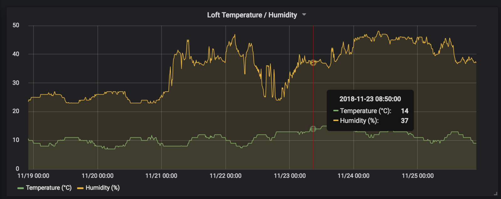

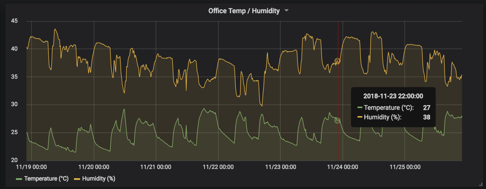

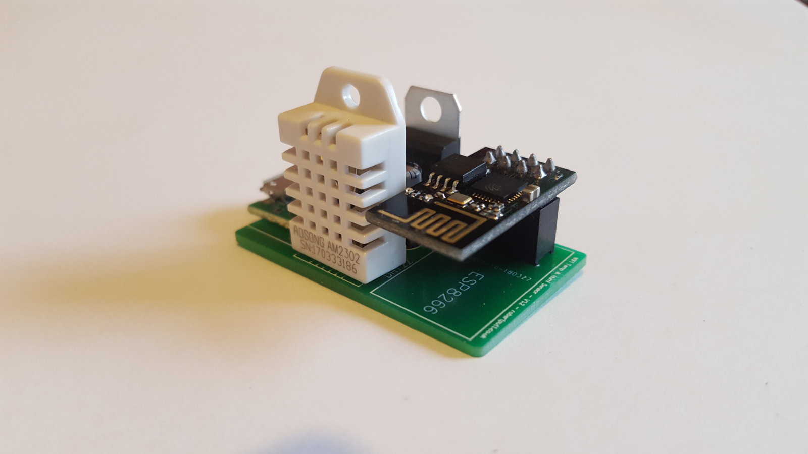

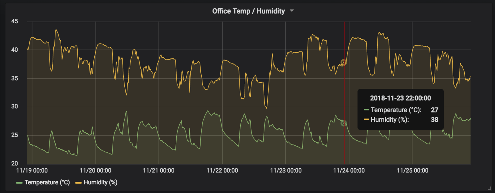

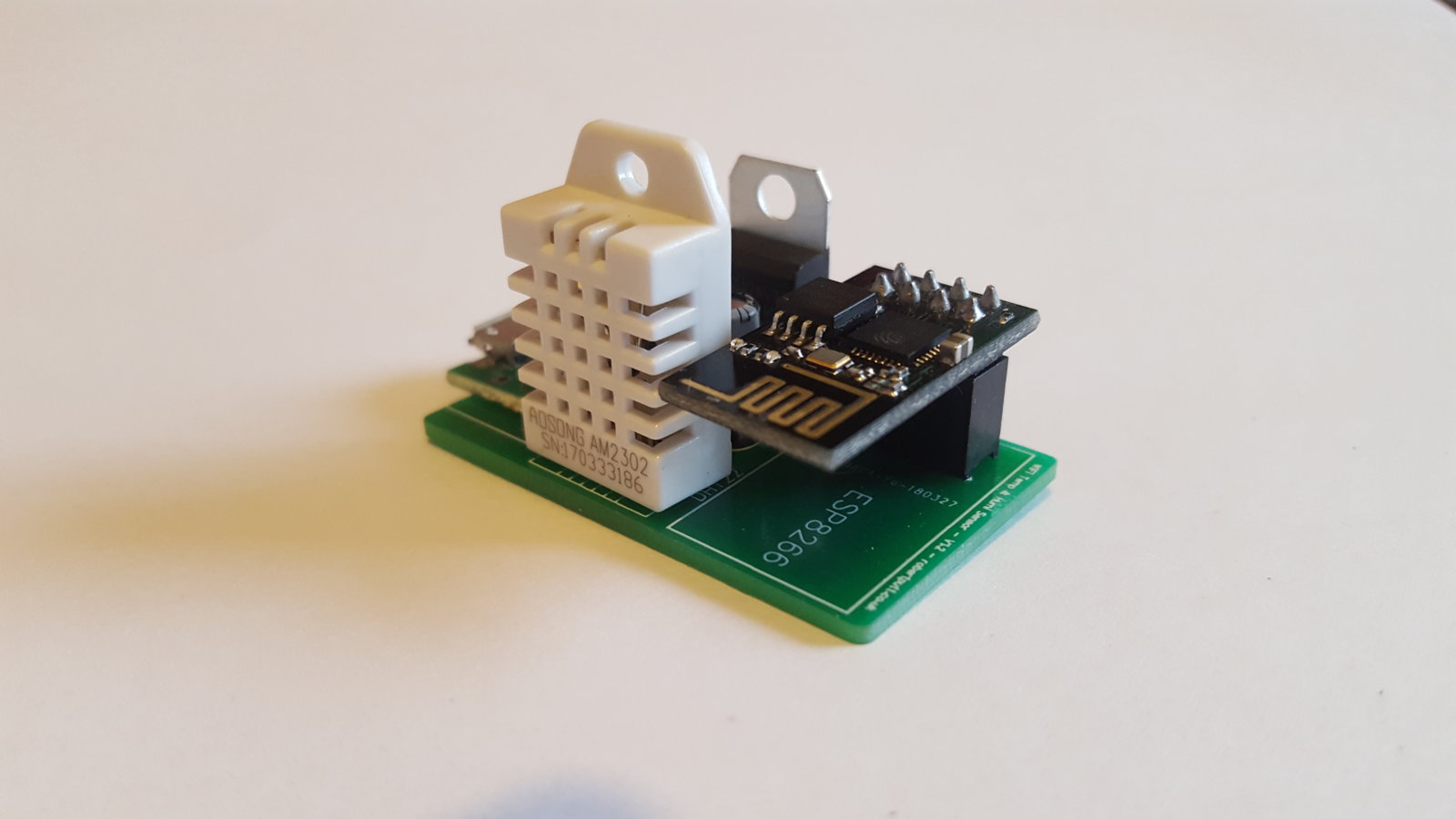

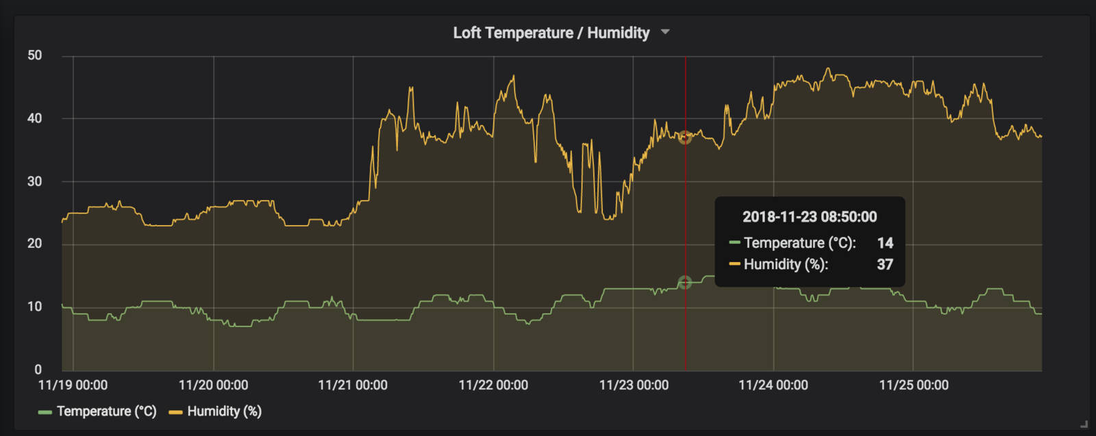

Evening All,
Just wanted to show off some little WiFi Temperature and Humidity sensors I have been making as part of my DIY Hive / Nest equivalent. The idea of these are to act as room sensors and then plan on having WiFi enabled radiator valves. Currently I only have the sensors up and running, they connect to my home automation server and post their readings periodically and the results are graphed.
Now for the exciting bit, the cost price of these bad boys...
- ESP8266-1 - £3.70
- PCB - £2
- DHT22 Sensor - £4.50
- USB Micro Breakout - £0.26
- Capacitors - £0.20
- Voltage Regulator - £0.40
Total cost to build: £11.06
Let me know if anyone is interested in further details about how to make these. The PCB is optional and the previous version of the sensor was built on prototyping / veroboard.

Fantastic.
It looks like you're trending RELATIVE humidity.
How do you connect these items to your HA server? What is their power source (batteries/mains adapter/CAT5?)

Morning,
- Yep it is relative humidity, the sensor comes pre calibrated and seems reasonably accurate, the spec sheet seems to think ~1% I have no way to validate it but all of these sensors left in a box with some silica gel all seem to concur with each other so I would say thats good enough for "finger in the air rough estimate" home use.
- Power is supplied by the USB micro port, it isn't used for programming the device (that is done with one of these... https://www.amazon.co.uk/Pinzhi-ESP8266-mod-prog-Programmer-Uploader-Black/dp/B078MC52NB), I power mine from either a spare phone charger and cable or I have a few sockets around the house with built in switching USB power supplies on the faceplate. You could in theory run them from a USB battery bank, but the circuit design does not allow for a super low power mode so I expect you'd only get a couple days use out of 1 charge on a small power bank. (maybe we can change this in a v2 of the board if people have a battery powered use case)
- My home server is complex, it's a Dell R210ii (a rack mount server) and it runs ESXi. On top of ESXi it runs my home router, Unifi for my WiFi access points, Shinobi for my CCTV, Emby for streaming my media to my smart TVs and my home automation server which is running Influx DB, Grafana and some custom Python stuff. Yes this is totally overkill and not the norm, so please ignore it. In reality your home automation server for something as basic as a bunch of temperature sensors could just be a Raspberry Pi.
- The home automation server in my case receives HTTP requests from the sensor and stores the results in InfluxDB via a simple Python Flask app, the firmware could be edited for MQTT, HTTP, HTTPS etc... it depends on how you want to set it up really. If you have no clue what any of this means thats fine, I did consider doing a kit version of this if there is enough interest which required 0 configuration out of the box other than editing your WiFi settings and then going to a website to view your sensors. Of course this would need to pay me a little bit of labour for pre-flashing the ESP8266s and taking the bag of bits to the post office.
