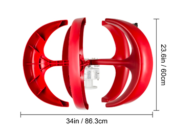

Hi folks, yes I have scanned the search facility but the posts appear to concern the large versions of wind power.
What I'm seeking is a small lantern style wind generator (AC current) just to provide 150w for powering a battery charger for my leisure batteries.
I was considering solar, but whilst long periods of sunshine are rare at this time of year wind is in abundance where we live !
Any recommendations appreciated.

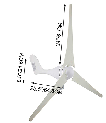

I'm not sure what you would regard as 'small', but something to generate 150W is not going to be physically 'tiny' - as per the two items linked to by Justin ...
Kind Regards, John
Thank you Justin, but I see the unit is 24v & I need 230v AC to power the charger.
John ... sorry, I used the term 'small' to differentiate between my requirement & a full size WG capable of off-grid power for an entire home.

Maybe I'm misunderstanding, but it sounds as if the second one linked to by Justin is specifically designed to charge 12V batteries ...
Fair enough. Do you know (I don't!) how physically big they need to be before they require Planning Permission?

Are your batteries like the ones in caravans and yachts? If so, the truth is out there.
For diy-ing I assume you want to build something different.
The electricity bit is almost trivial. To charge eg a 12V car battery you need about 13.8V dc. Enough excess voltage to give you a useful current considering the resistance. Vevor makes several models with different output V/A combinations. They will be able to suggest the model for your particular battery. You wouldn't convert what comes off the generator ( voltage will depend on rotor speed) up to 230VAC just to supply your charger - no converter is 100% efficient. Low voltage boards for changing voltage, and charging, are very cheap now.
Those turbines have regulated outputs - fair enough, they have to provide something nominally useful!
The size of the things I picked above are about what you want in terms of watts so give you a size and price, and
this isn't quite what you want but it's close enough to be a guide

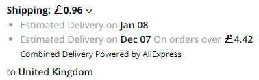

Shipping: £1.97
To United Kingdom via AliExpress Standard Shipping
Estimated delivery on Dec 03
Not so bad - it is China! Most things arrive at the short end of the estimate. Popular things are in the uk already.

Are we looking at the same thing? I'm seeing shipping to UK as £0.96 but, if the order is less than £4.42 (which one of those would be), delivery would be by January 08. Am I missing something?

Aliexpress - there are several shipping options you can dig for, they highlight the cheapest which is of course slow.
