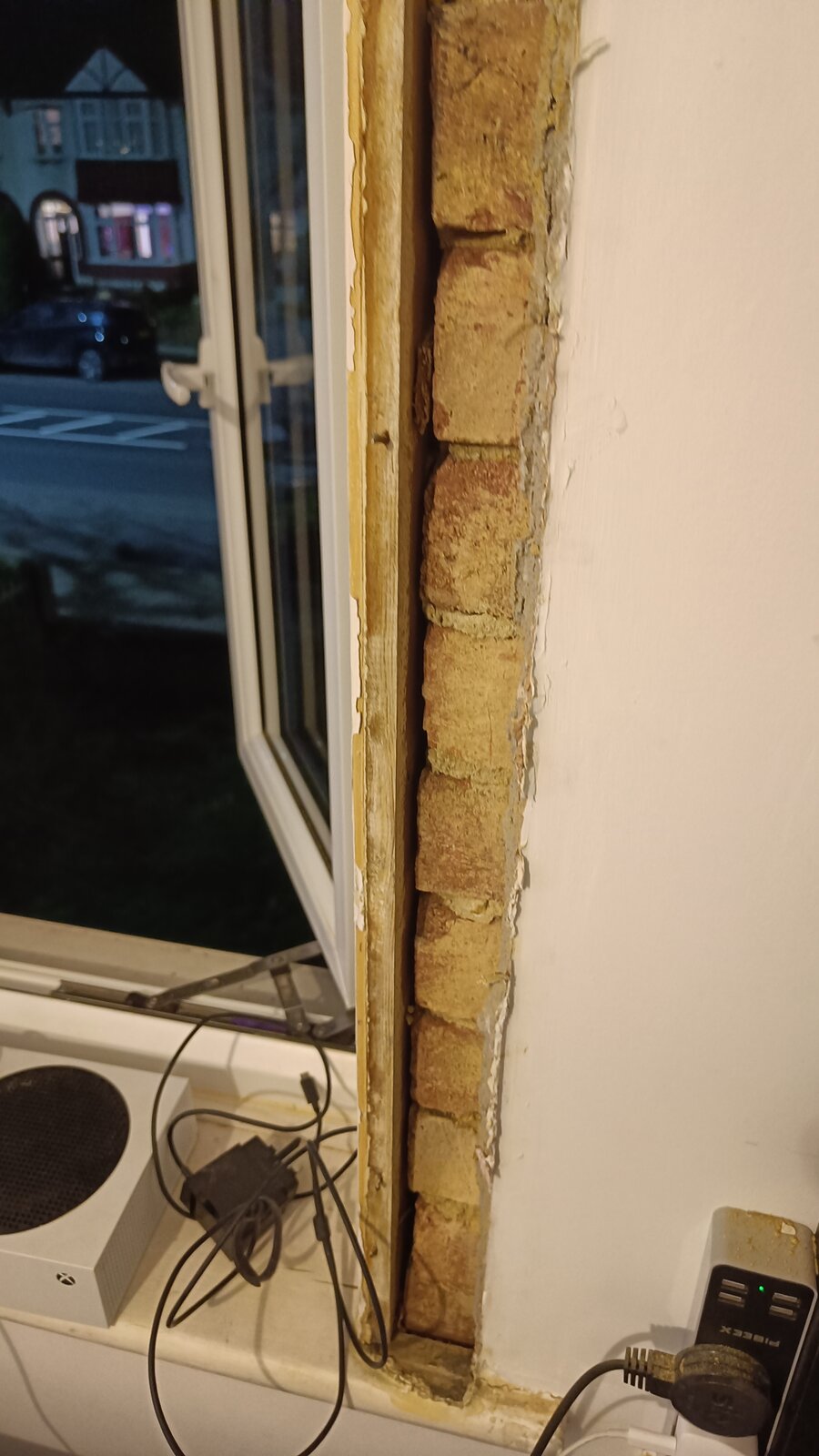

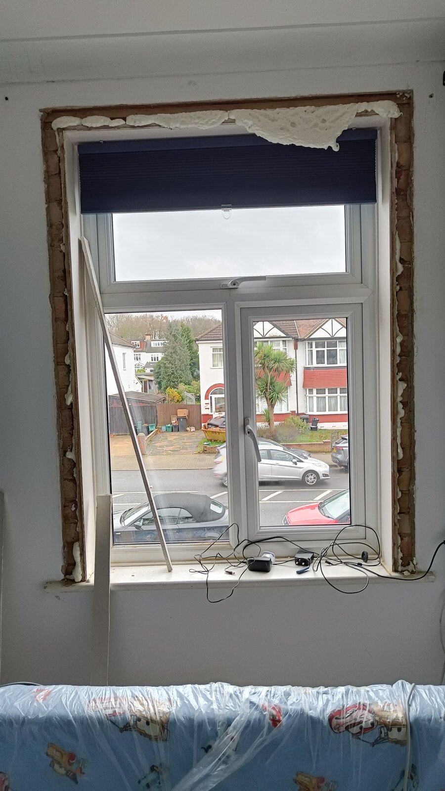

Hi,
What would you recommend for filling the gaps between the brick the frame. My goal is to minimise the sound leak, second is of course heat loss.
I'm inclined to use boanding coat rather than foam. Any advice

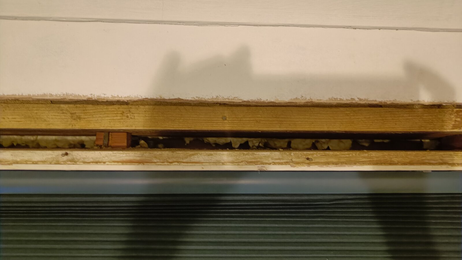

I have no idea what to do for the top one, add another wood piece in between, foam or bonding?
Plasterboard cut tight. Seal board edges and wall with PVA and stick in.
Plaster over
Would help if you filled that small gap with foam if you had any.
Agree; expanding foam it up completely then place your strip of plasterboard in place, using the foam as adhesive to bond the plasterboard
Ok. So plasterboard rather than a bonding coat. Does plasterboard have a better sound blocking capability than bonding coat?.progress update

It's a brick wall which Is good and blocking sound. Glass it terrible at blocking sound so I don't think there will be any difference in sound blocking qualities
