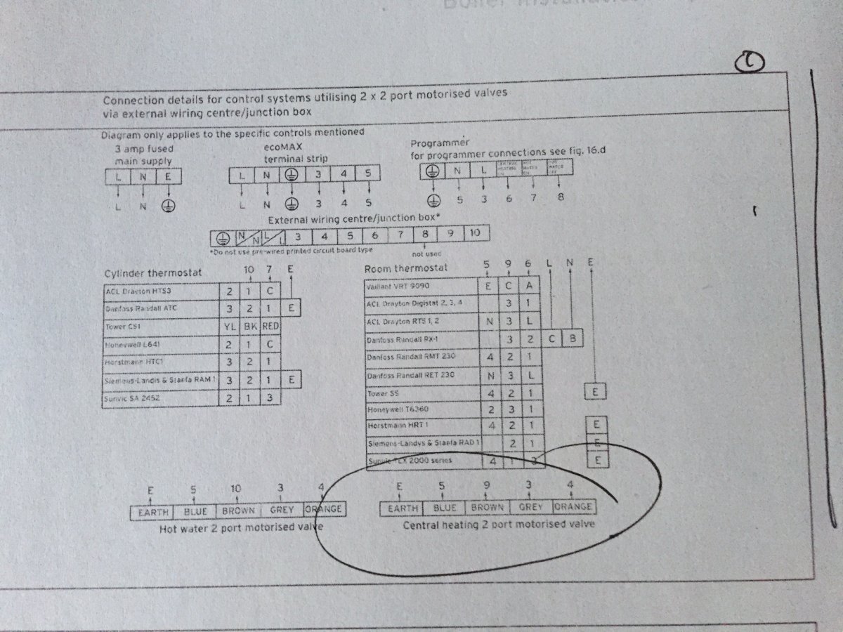

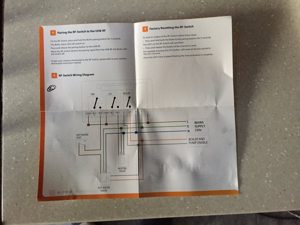

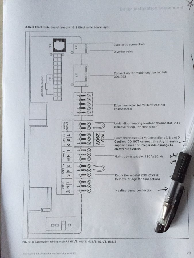

I have a Vaillant ecotec 828, a single zone wet ufh with manifold/mixer, a heatmiser rf switch and heatmiser touch programmable thermostat.
My plumber has plumbed in the manifold and fitted two motorised valves - one to the central heating feed from the boiler and one one to the ufh feed from the boiler.
The wiring centre has been fitted and the wireless programmer/thermostat communicates with it. The heatmiser touch is able to control 2 channels (HW and CH) but currently set to run 1 channel (CH ) only.
The radiators are controlled by a clock fitted in the boiler and TRV's - there is no room thermostat.
The wiring centre which has the following terminals: HW- CO2 NC2 NO2, CH - COM1 NC1 NO1, Boiler - LS LR, and - N E L
I have attached diagrams for the RF switch and the boiler.
I wish to do the following:
1. Able to have the UFH off and run the radiators only, and vice versa
2. The UFH and CH should only run the boiler when their timer is on/the UFH thermostat needs heat.
3. The UFH and CH should be able to turn the boiler off and on independently
I would very much appreciate if somebody could please provide some advice I can pass on to the plumber and the electrician on how to wire the two motorised valves with boiler/wiring centre to allow the separate control we are hoping for.
Thanks!
boiler terminals from manual.JPG boiler terminals.JPG rf wiring centre terminals.JPG
CH zone valve will be opened via room stat (in your case clock/no interlock) which in turn will switch boiler via MV end switch.
UFH pump (circulator) will be switched via MV brown core which in turn will switch boiler via MV end switch.
Not rocket science...It says a lot for the 'plumber/electrician' when the client has to trawl the Internet in order to explain how to carry out the controls wiring.....:rolleyes:...which I don't believe for a minute as I guess you are carrying out these works yourself..good luck..:LOL:
A relay could be used in order to eliminate any voltage back feed should the circulators be fed via MV end switches although I would imagine this would just confuse the issue so carry on as above.

I have read somewhere that it may be better to stop using the timeclock fitted to the boiler but instead use the heatmiser 2 channel switch to control CH and UFH (one on each channel). There was also mention of feeding both MV orange wires to the same terminal in the boiler. Unfortunately I cant find the forum/post where I saw this.
If anyone can help, would be much appreciated.
Standard precedure to use MV end switch (orange core) to trigger boiler.
