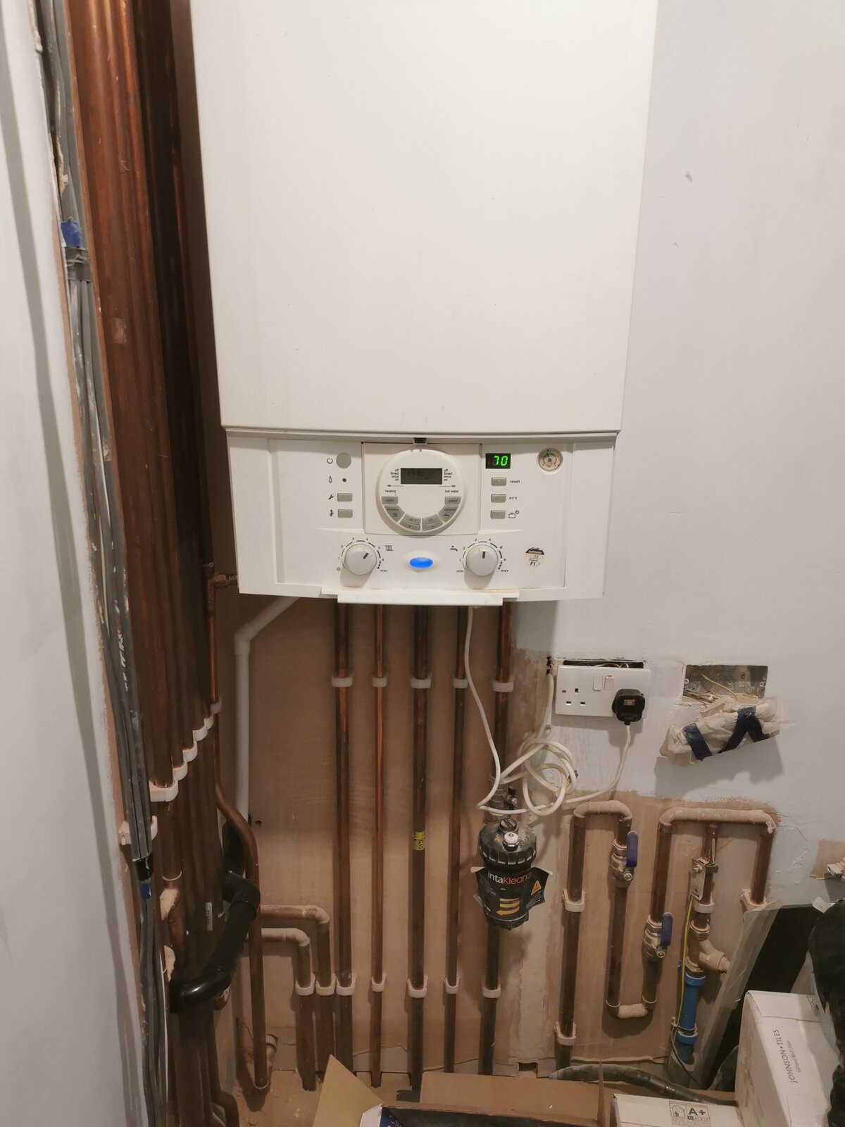

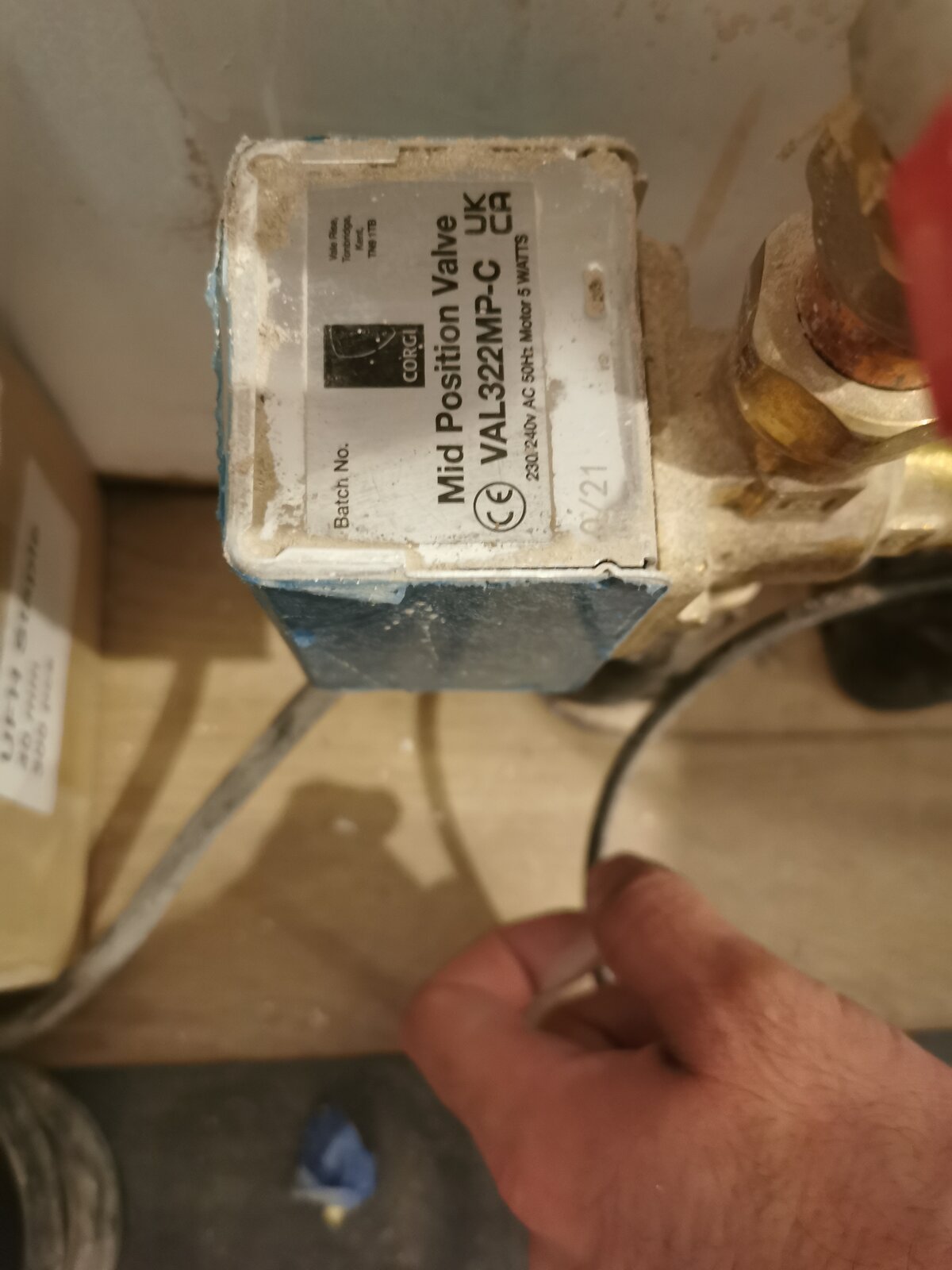

Strange setup that - UFH would usually have it's own 2 port - therefore the other circuit (rads?) would have that 2 so an extended S plan (+). A 3 port would be a strange way to do it. It may actually be a diverter as there is no HW cylinder rather than a 3 port mid pos.
So the usual would be, stats control their own zones UFH actuator, they would normally be hardwired or wireless through a UFH controller, that would then send out signal to the 2 port and from there to the boiler. Same with the rads if on their own stat.
Your wiring then wouldn't be an S plan wiring rather possibly a type of Y plan. Would need to see the setup and codes/numbers off the valve
As above, two 2-ports would be much more normal here. Could probably make it work but it's slightly odd.

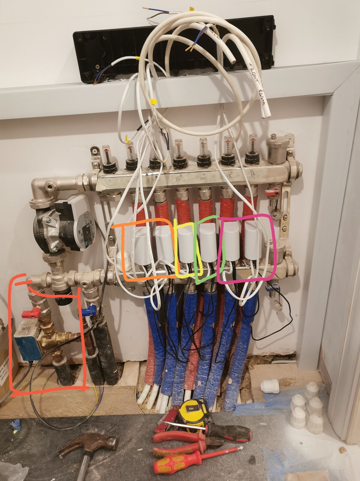

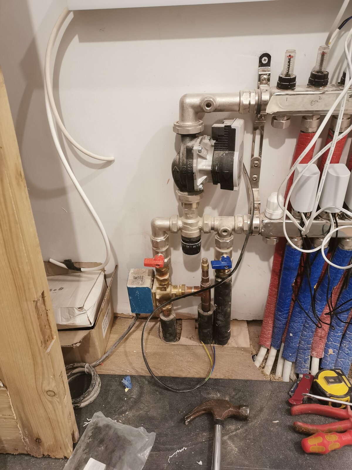

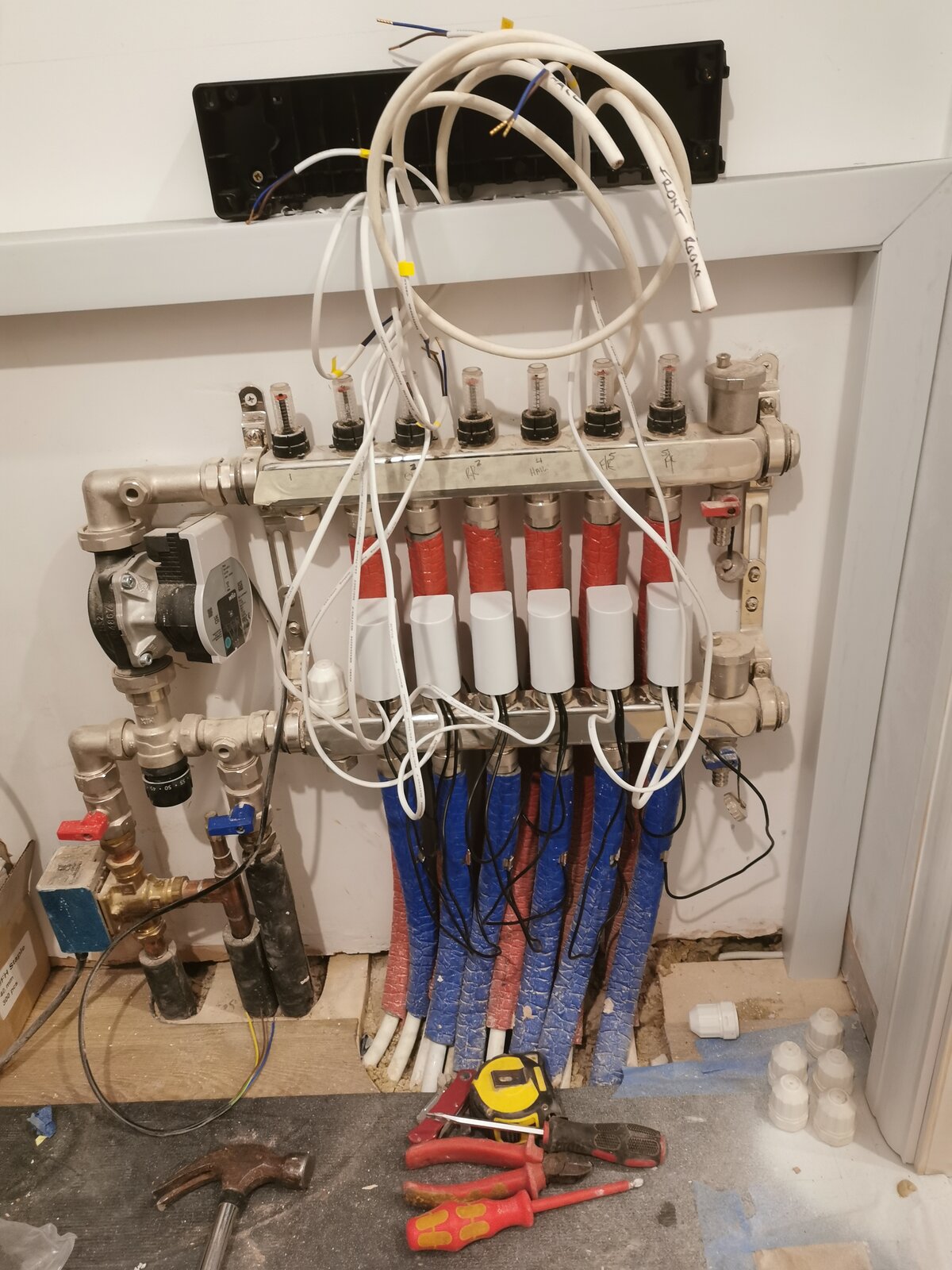

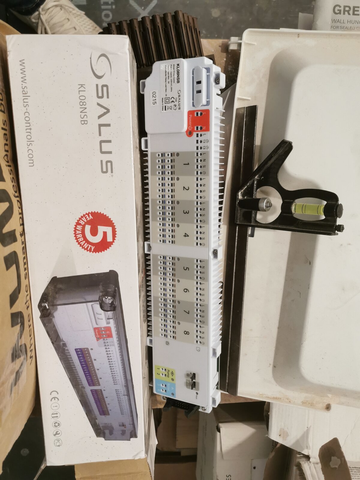

Photos attached of what I've been left with.
The coloured boxes are the valves that will run together in each zone/room

I'm trying to relate this to the standard Y-Plan wiring for a mid-position valve. It seems you only have two signals - one from the UFH wiring centre and one from the rads thermostat? Don't you need a third signal to use the third position on the mid-position valve?
I'm not sure, I'd assume so yes... Could I use a timer to do this? Again have not a clue..
All I know is it's how it was left and I've run out of money to get it done.. so really need to get this heating going
What does the installer have to say about this? I suspect your inability to pay wont help, but they are the person to finalise it.
edit - thats a right mess.
