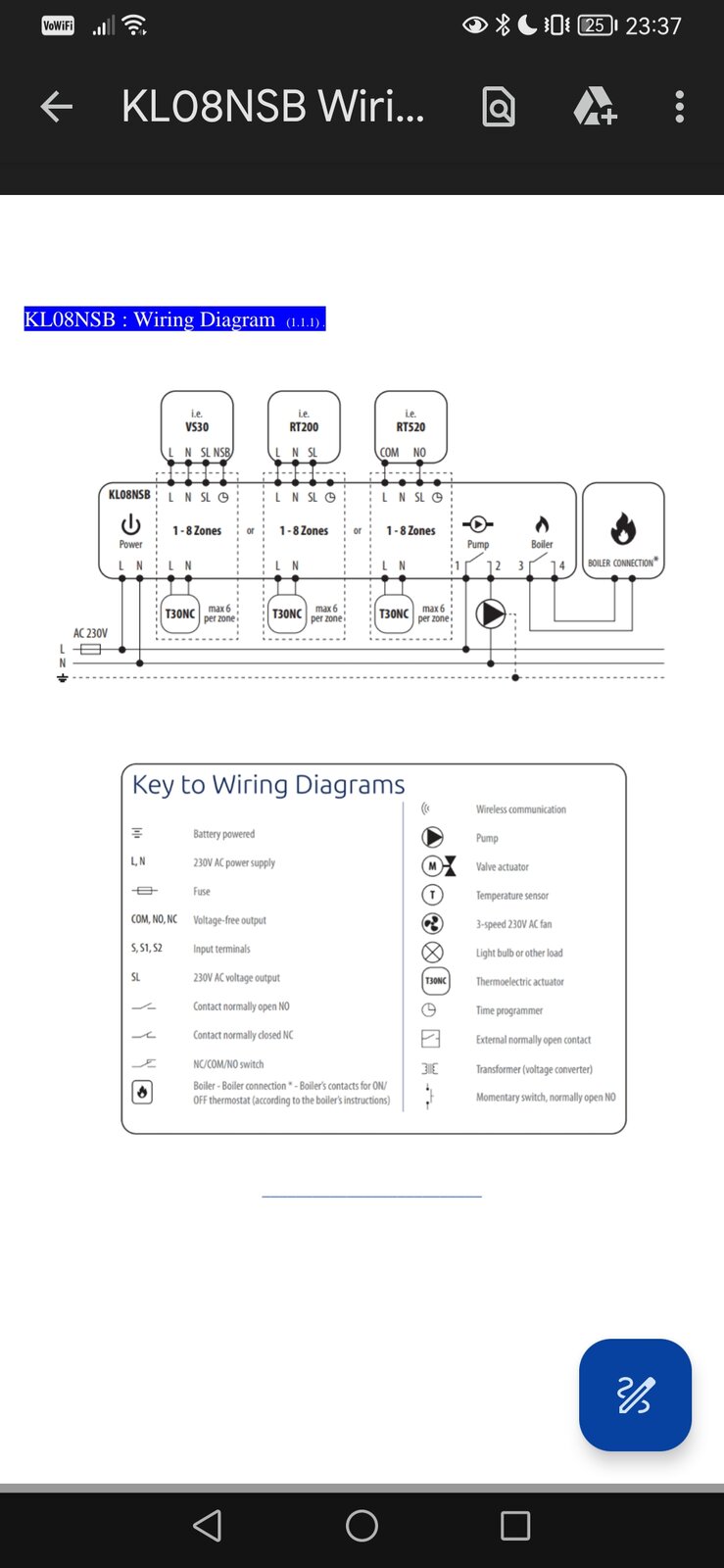

So I've managed to get 2 zone valves plumbed in, one for my CH, one for my UFH. Now on to wiring.

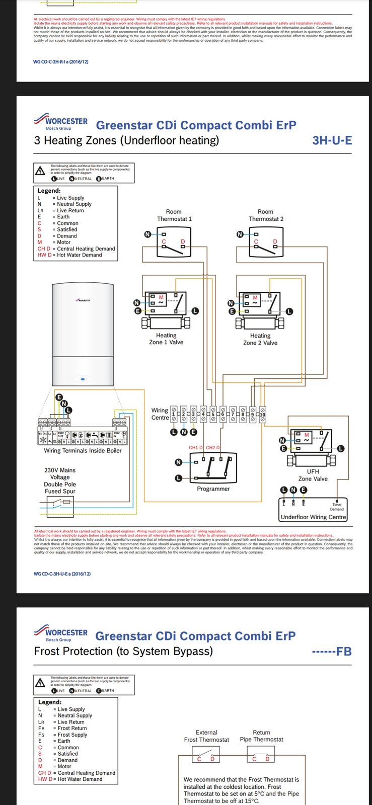

I am using a Worcester Bosch 35cdi combi. Wiring diagram attached.

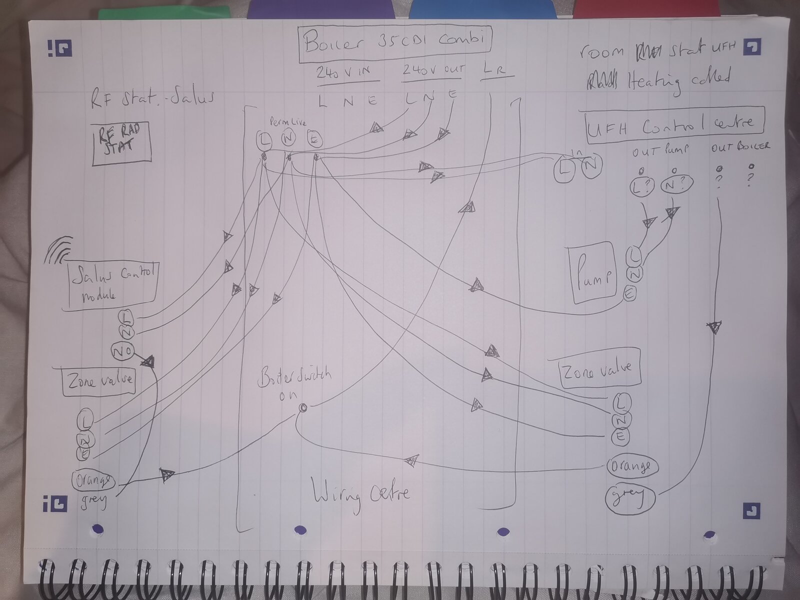

I have also drawn what I think is the right wiring plan, but would like a little look over help please, anything a miss?
I've excluded a timer as there's no need for it in this case (I think - combi HW), the salus stats themselves have timer setups for CH/UFH
Also wondering what the 2 wires are out of the UFH control centre for the "boiler" on, as the worcester only seems to want 1 wire to tell it to switch on according to its diagram....

I can't take in the sheer wonder of your diagram!
But I can see that both zone valves are wired to the permanent live. So they will both be always open, whatever happens.
Try to draw something based on that second diagram. Hopefully then you or someone else will be able to understand it!

Thanks I can already see where I made error with the 'brown' live, it should be connected to what comes out of my ufh controller, and the grey wire should be connected to permanent live 240 volts on the valve.
Any idea on this though?
your first diagram is correct but the colours are dubious, all grey wires on all zone valves are conncted together with a permanent live, all the orange wires are connected together and go to LR on the boiler, the thermostats switch the brown wires on corrosponding zone valves, it is the valves that control the boiler, as a side note you will regret buying Salus , they are dire

The part labelled permanent live with the permanent neutral and earth - do they not go to boiler in? Or is it a supply from the boiler?
