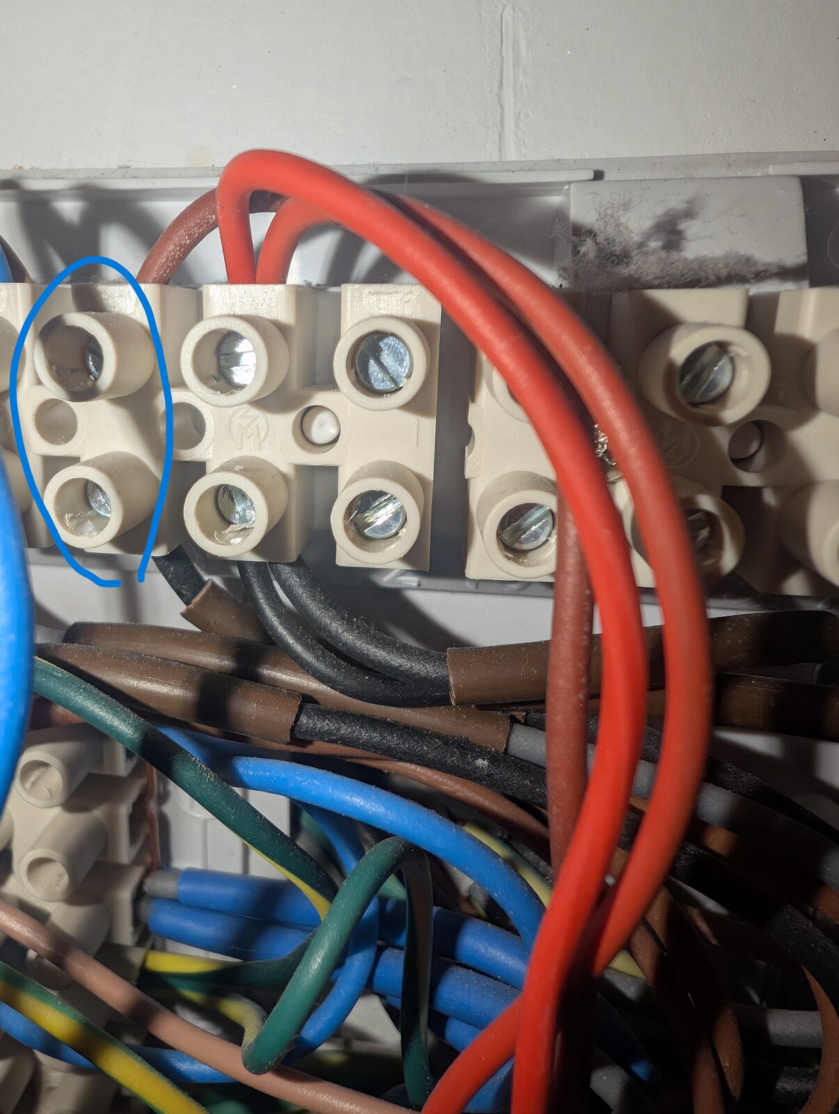

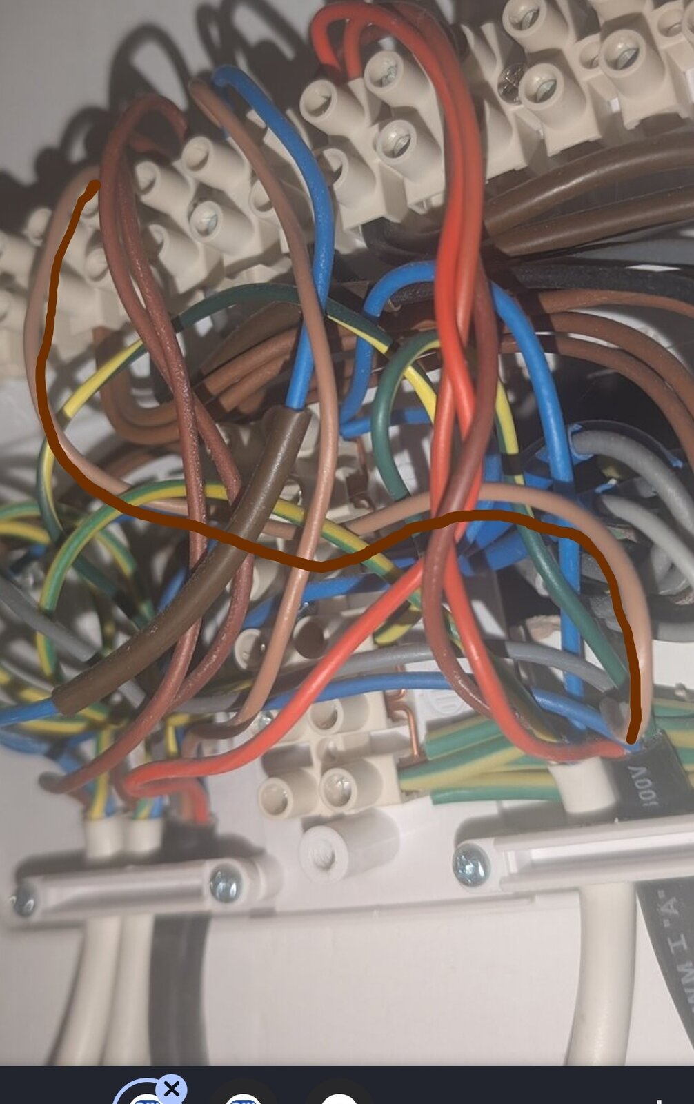

This is the one, right? I know the wire is black, but it's got a brown sleeve, and that brown wire coming in from the top is definitely the brown wire from the CH valve.
I double-checked with a multimeter that the thin brown wire was live when the UFH was calling for heat and not otherwise. I couldn't run up and down stairs fast enough to see whether it went live as soon as a UFH thermostat switched, or only after the motorised valve hit the microswitch. There relevance of which being:
If I connect that thin black wire to the connector above, the UFH doesn't run. Motor doesn't start, valve doesn't open, LED lights on the wiring centre don't light (neither pump nor boiler).
Want to take a look at the UFH wiring too?
Yep, that did it. UFH now energises the CH pump and the valve whatever the state of the CH thermostat.

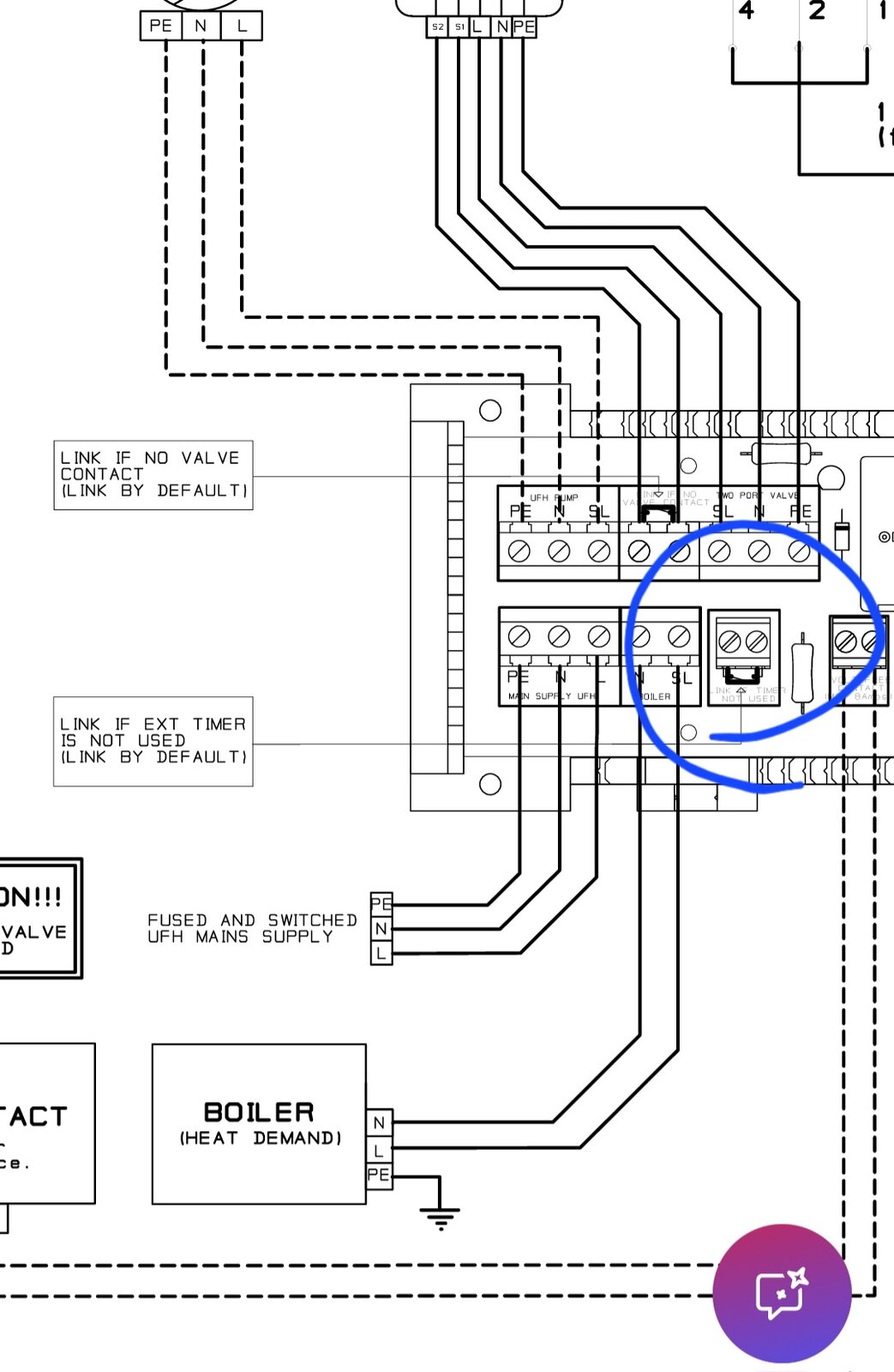

Firstly, we now know that the black wire is the call to heat from the UFH - if you can trace the cable it comes from, how many wires are in that cable that we can potentially use to control the UFH.
Secondly, your UFH wiring centre has a timer link here....
It may be possible that a smart control bridging this link could add some more control over your UFH, without switching the whole lot on and off as Trojan was concerned about.
Aha. That might be the ticket. At the very least, a hardware switch would make it easy to turn the IGU off for a couple of hours when there's no-one home. Because nobody would bother to go to all the thermostats. A light switch would do that.
And a simple WiFi light switch would me to work it remotely.
I'll take a look tomorrow. Presumably those contacts are jumpered at the moment.
