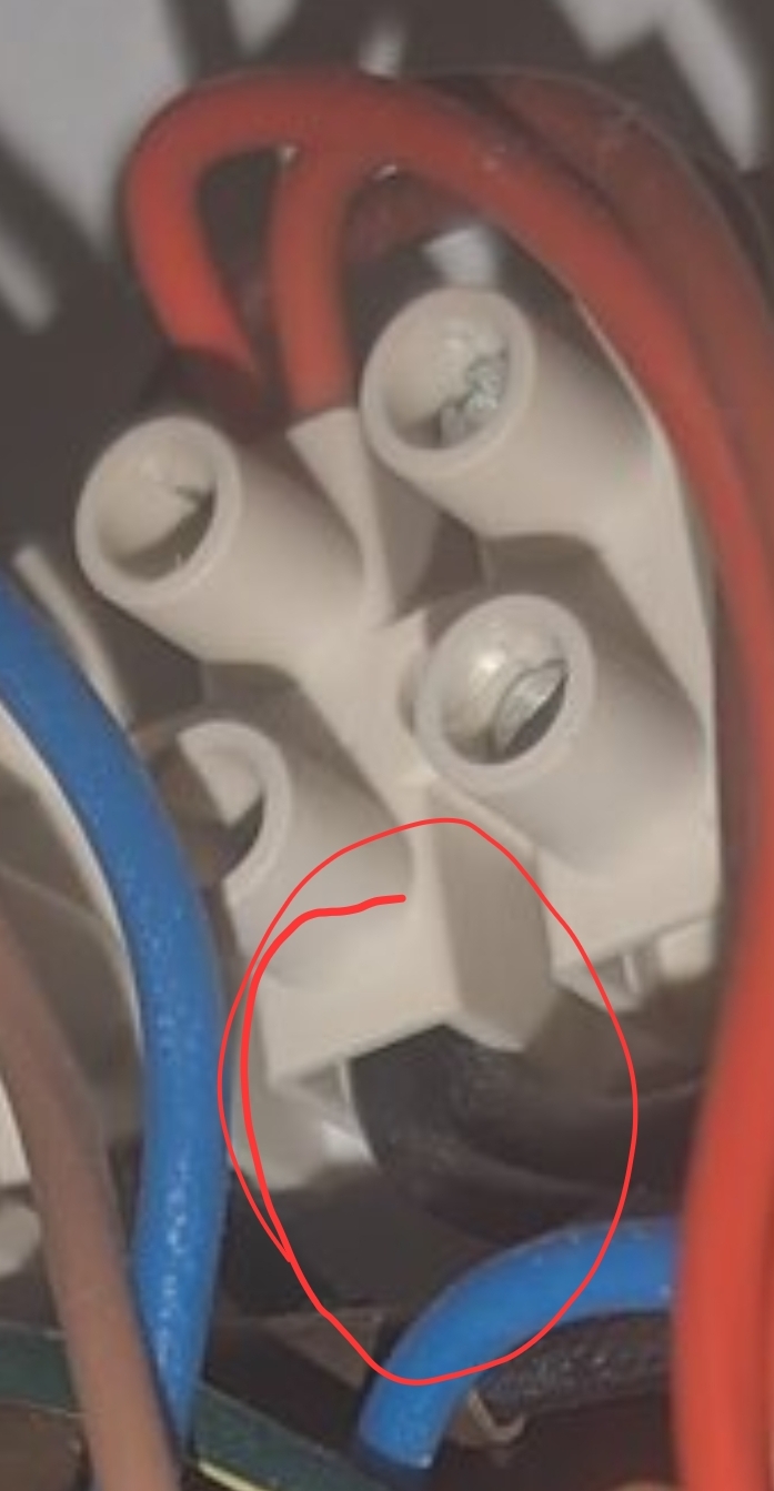

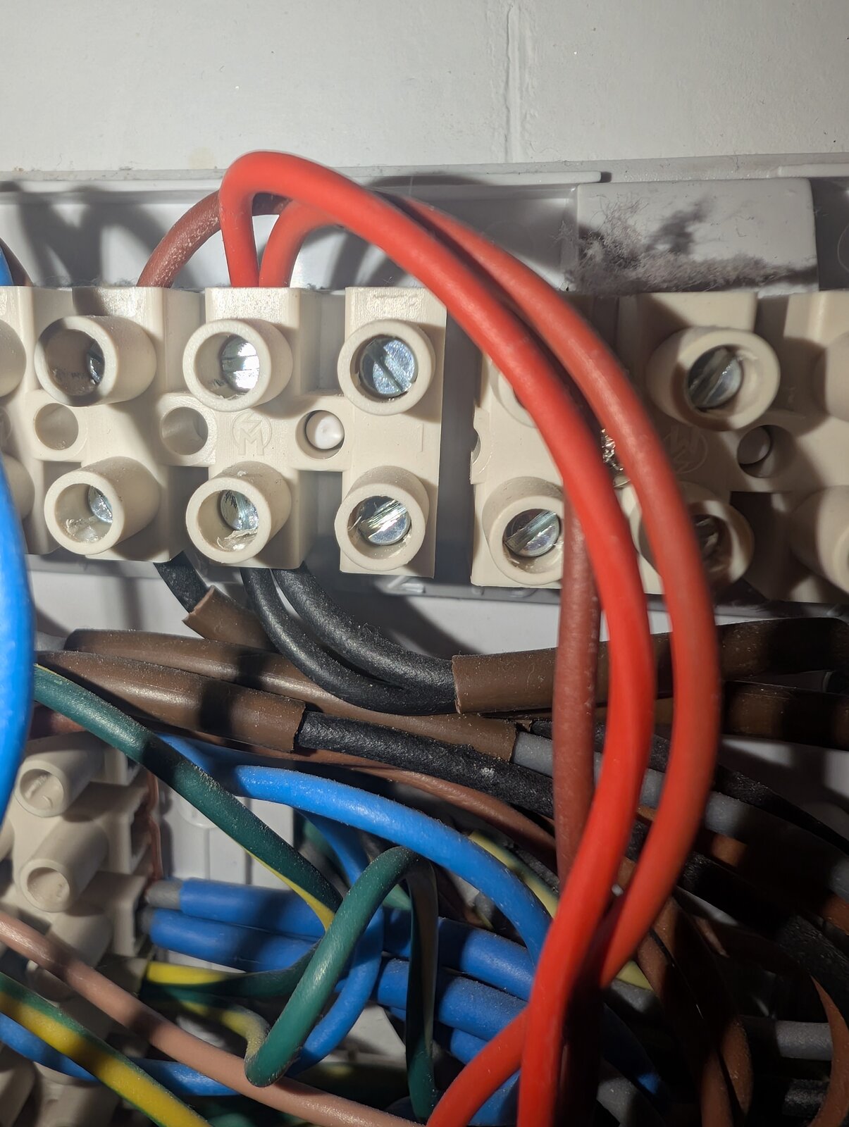

Are there 1, or 2 black wires in this terminal connection?
I think I only see one?
If there is one black wire, that connects to and fires the boiler; the connection from the UFH call for heat to the boiler is made elsewhere, and I'm afraid I don't think there's much more we can do for you, unless we can find that connection.
If there are two black wires, it's possible that one is from the UFH.

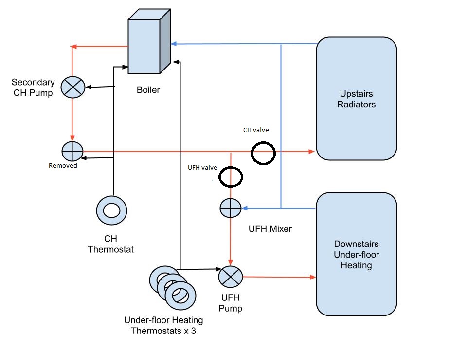

What I would have suggested was doing away with the call for heat from the UFH and taking the CH thermostats call as the power for the UFH zones and pump. Depending on how it's wired though this may cause the ufh thermostats to lose power until the CH thermostat calls for heat which is less than ideal and would require further wiring mods. Would also mean that the UFH could only run while the radiators were calling for heat.
Really what you want is an extra zone valve and repositioning of existing central heating valve.
Folks, this is awesome. I've been trying to get a grip on this problem for literally 15 years.
There are two black wires.
So, are you saying that those two black wires are the call for heat from the UFH and the CH thermostat?
If so, we're close to the key to my problem
+ The CH thermostat fires the motorised valve and the secondary pump when it calls for heat.
+ The UFH only fires the boiler, not the CH valve or the secondary pump
If the UFH calling for heat did everything the thermostat did, then that would solve the issue that my UFH doesn't get flow unless the whole house is cold. That would make the smart device question much easier (and I might not need them at all).
Yes, that's what I have now. The UFH doesn't get flow unless the CH thermostat calls for heat.
I think you diagram is how it was supposed to be installed. There is a UFH valve where you drew it - I missed that off my diagram.
There is one radiator (in the 4th bedroom) that is hot whenever the boiler is running, regardless of any thermostat or valve. I'm assuming that those pipes were where the UFH was supposed to be connected, as a third circuit. But somebody connected the UFH to the 4th bedroom radiator pipes and vice versa.
Not quite. When either of the two zone valves are active and in position, a switched live is sent down the orange wires.
One of the black wires that is connected to the orange wires in that terminal block will fire the boiler.
We don't know what the other black wire does, especially given the complexity of your system - it could be another pump connection for example.
But given your description of the UFH - it fires the boiler, but doesn't power the valve - a switched live from the UFH wiring centre is getting to the boiler somehow, and this may possibly be the place.
Assuming you haven't got a multimeter and you feel like experimenting; we could attempt to disconnect one of the black wires (with power safely isolated), and temporarily connect it to a spare unused terminal in the wiring centre.
If the boiler doesn't fire when the rad heating is called for, the disconnected wire goes to the boiler. Swap the wires back around.
If the boiler does fire when rad heating is called for, turn off the rad thermostat and see if the UFH thermostat still starts the boiler. If it does, then the UFH connection is somewhere else and put both black wires back in their original position.
Only attempt this if you are confident you understand what I'm trying to suggest! :)
