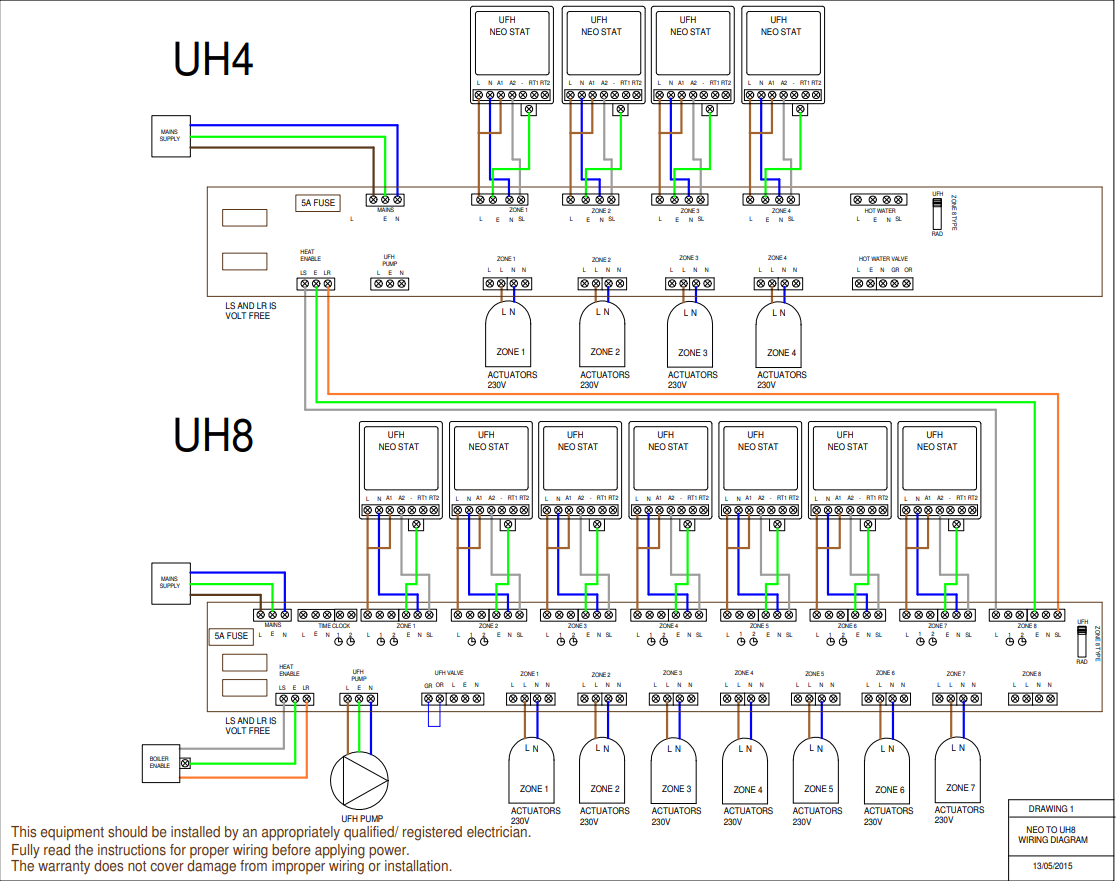

Hi all
My house is being renovated and as part of phase 1 we had UFH installed downstairs, next to the boiler. This is all set up and running, but I'm now putting a manifold on the 1st floor and one in the attic. I'm a bit confused as to how to wire the Heatmisers and how to connect them to the boiler. I've looked online and found the attached schematic on the Heatmiser website. For the 1st floor and attic heatmiser, do I wire them both into the ground floor zone 8 ports as shown in the schematic? Or should 1st floor go into zone 7 and attic into zone 8? And what cable is best to use?
Thanks for your help in advance!
Cheers
Auric
