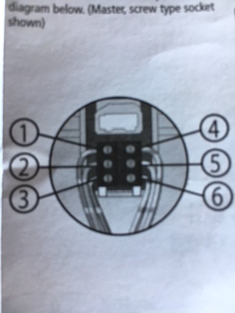

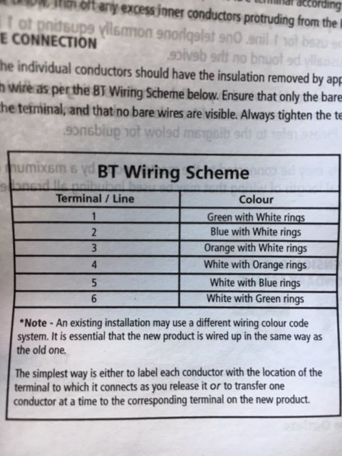

Hi guys,
I was wondering if somebody could help me with the wiring to new socket.
I have a leaflet with the new socket ie Blue with white band goes to number (on new socket) but it's not so much the 3 with coloured bands on it is the blue and white solid wires which it doesn't mention on the leaflet. If I post some images I am hoping somebody can tell me what goes where? Much appreciated.

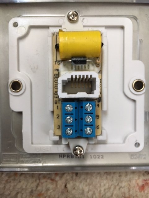

The Blie and White wires are the incoming pair ( the telephone line ) from the telephone exchange.

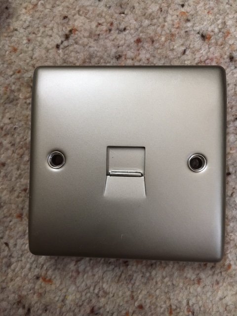

The socket you are replacing is the BT master socket which is the property of BT.
The socket you are intending to connect is a Master Socket ( it has the ring capacitor ) but is NOT appraoved for direct connection to a BT ( or other supplier ) telephone line.
It is not approved becasue it does not provide any means ( other then disconnecting wires ) of disconnecting the internal wiring ( which can be DIY ) from the incoming pair. This disconnection is necessary when you ask BT to investigate a fault on the line.
If you realy must use that unapproved socket then Blue in terminal 5 and White into terminal 2, with the bi-cloures as in the diagram....That might work but do not call BT when it is connected unless you are prepared to pay for their visit.
