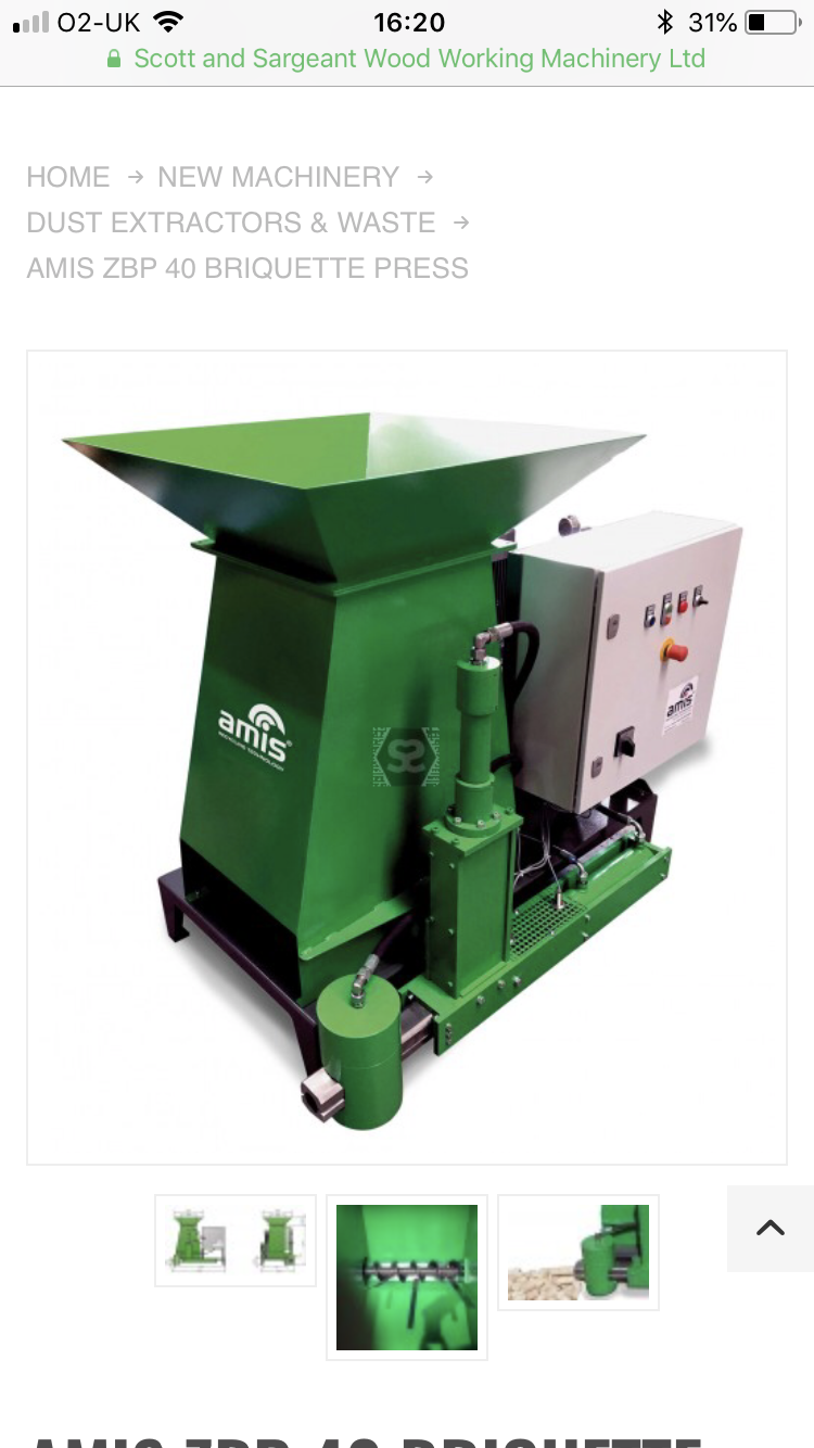

Here’s a picture of the machine that makes them, you tend to find the more sawdust in them the more crumbly they are but they do burn well if sometimes a little hot

They are just compressed shavings and dust held together by the resins in the shavings
That's amazing info! Thanks mate! :-)
