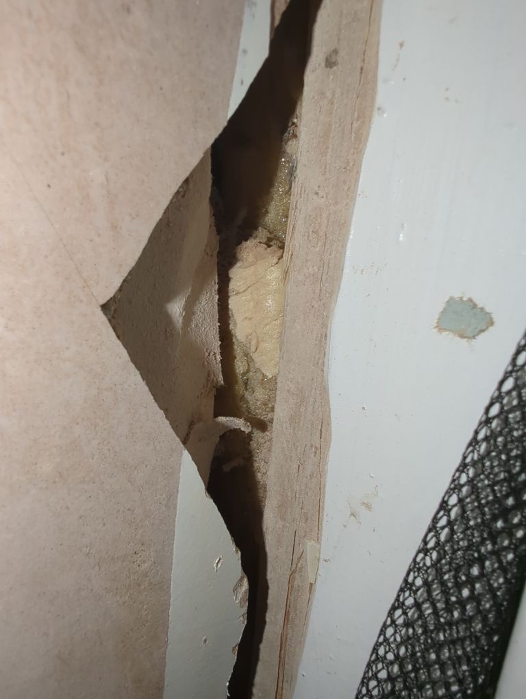

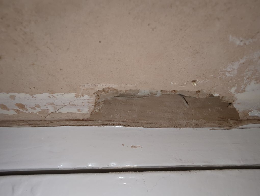

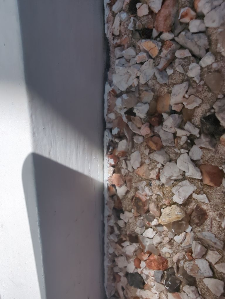

As you can see on the attached pictures there is exterior insulation and on the inside the wooden frame is quite deep.
I cannot fit it from the outside (not to destroy the insulation) so the frame has to be installed from the inside.
I have hacked off some of the plaster and there is 0.5cm deep on either side.
On the top there is like a plasterboard and the frame goes at least 2cm deeper. Again I would have to demolish more of this to get a similar size frame.

Can’t see anything useful on pics , too close and no reference point.
The current door and frame measurement are of no use, only the opening size .
True. The pics only show the door frame is deeper not flush with the opening.
