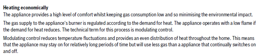

I have a WB Greenstar Compact CDi ErP Combi boiler. I believe it uses the EMS Bus for actual modulation (ie. controlling the flow temperature), but the manual suggests it can modulate without mentioning a requirement for EMS (in fact the manual doesn't mention EMS at all):
It says the boiler is regulated according to the demand for heat. My question is, how does the boiler know the demand for heat, and choose to turn the flame low? The thermostats (Drayton Digistat +3) just have a live supply and neutral supply, and live switch;
So surely they can only tell the boiler to turn on/off? Which would mean the thermostats are in charge of any "modulation" by way of PWM signal, cycling the boiler on and off and not controlling the flow temp.
Is that correct, or is the boiler capable of something smarter that I'm missing?

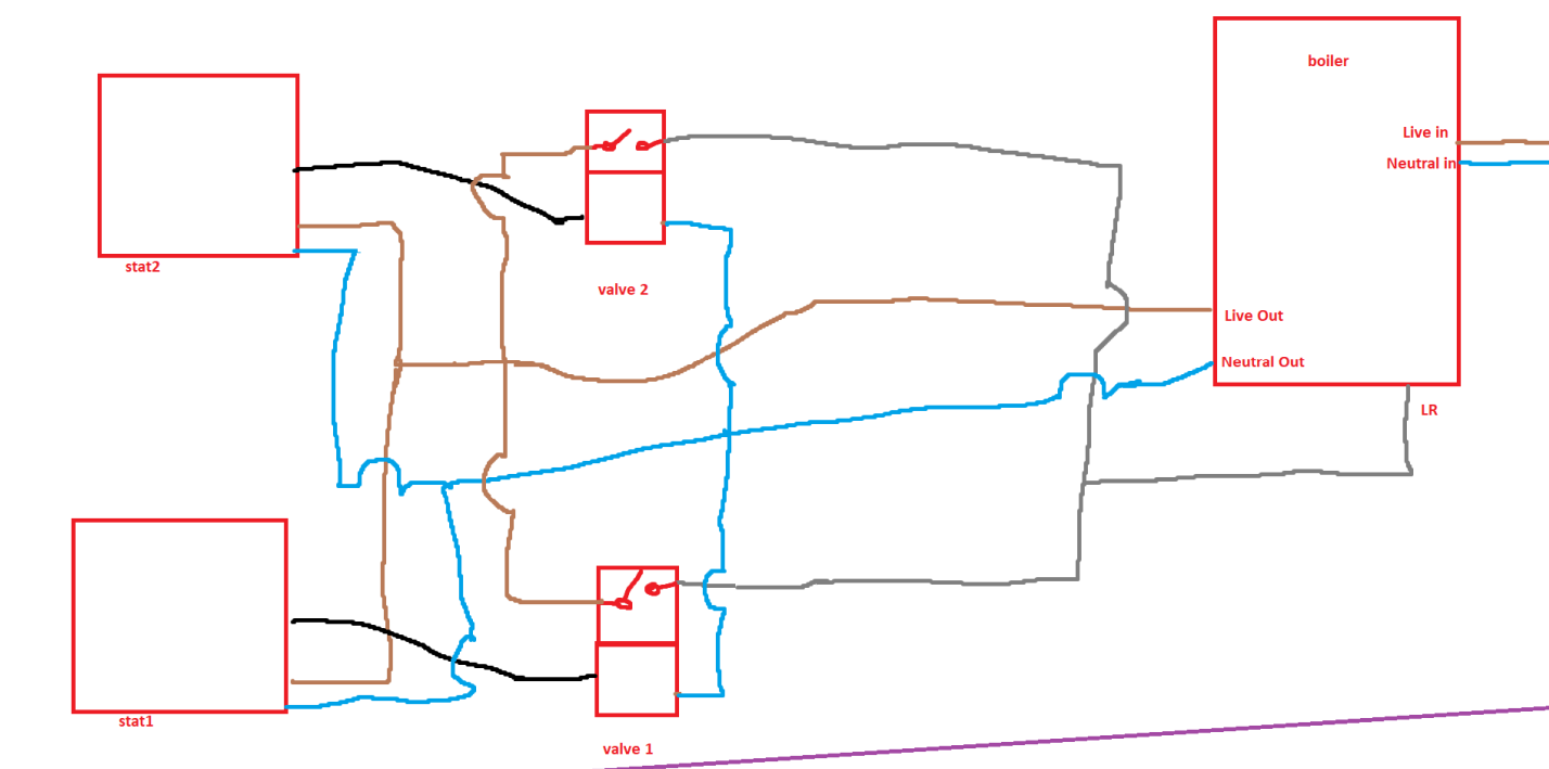

PS I actually have multi zone, so I believe the thermostats will be wired to a zone valve, which when open will send live return to the boiler.
