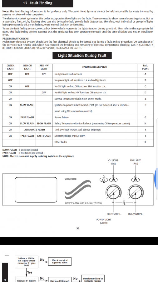

worcester bosch highflow 400 rsf stopped working
There is nothing in the manual about reset switch location
Really?
your boiler is different,as you know.
Only reset is via turning the heating thermostat knob fully anti clockwise then back to previous set position.
Nothing for the user to reset inside the case.
Hope that helps,
Thank you rules&rulers. That really does help. Ive turned the switches to do the reset but unfortunately that hasn't cured anything. I think I will need to call someone out. Thank you for being really helpful and respectful you really helped to clear things up regarding looking for a switch!
