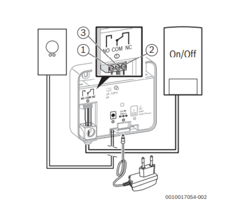

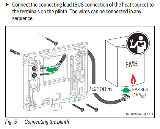

I'm having a Worcester 8000 Combi fitted this week and asked for Easy control thermostat to be fitted as well. Just been looking and am I right that the thermostat needs either a 2 wire back to the boiler or a power supply unit and cable to the stat from a socket. As it will be a nightmare to put a cable in back to the boiler and there's no socket where the thermostat is at present.
