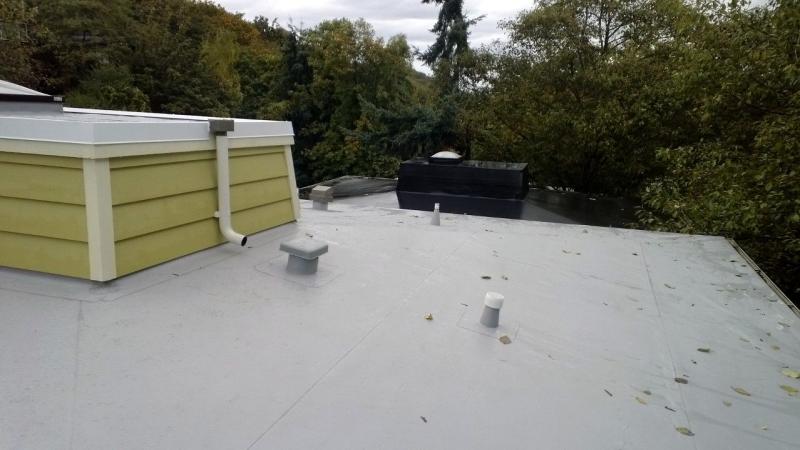

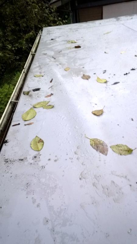

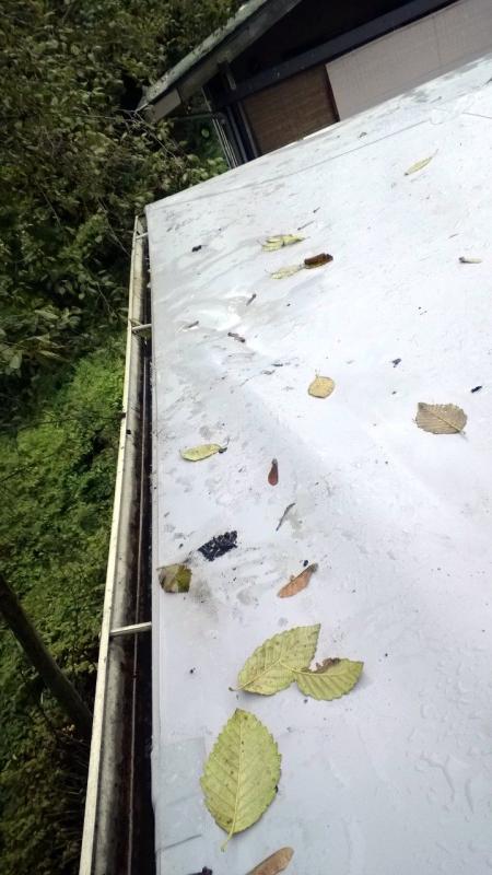

I recently had a new TPO roof installed.
When the contractors were done, i climbed up and noticed a whole lot of wrinkles.
Can someone please help me understand how bad this is, and whether I should expect the roofing company to fix this.
See pictures for examples.
Thanks a lot!
[/img]
There is moisture under the TPO finish covering - presumably its been built in from when the covering was laid.
Typically, moisture infected or damaged roof decking ie. the ply sheets or similar, were not replaced or repaired when the TPO was laid.
Why was the original covering replaced? Before replacement, did you have signs of moisture stains on ceilings below?
Whatever, the roofing contractor is liable for returning and making good.
