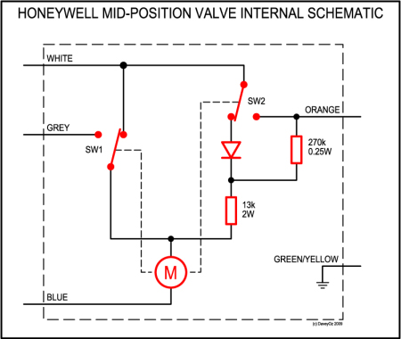

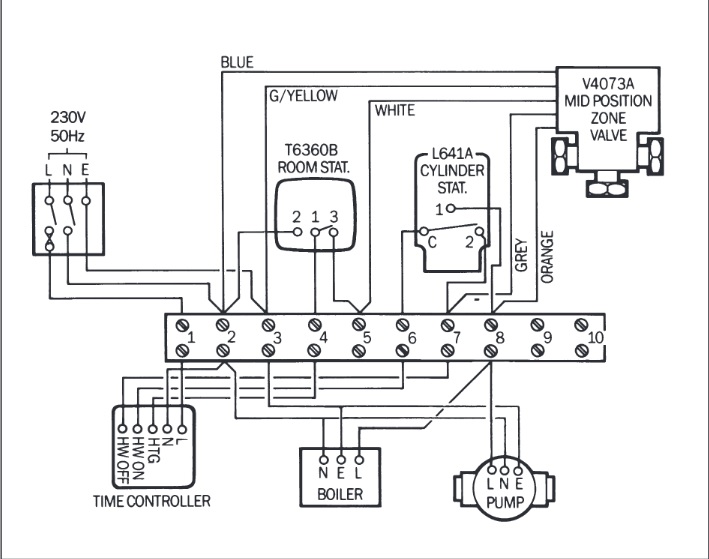

The Y plan Y-Plan.jpg does not move the valve for DHW or send any supply through the valve, mid-position-valve.jpg with the bleed lever going slack then valve must be going half way at least, but bleed lever only takes it half way so you don't know if going all the way or not.
The grey wire when powered makes it go half way only, and the boiler is powered from the tank thermostat, so in theory if grey wire removed and made safe then it should motor all the way, so I would try removing grey wire and see what happens.

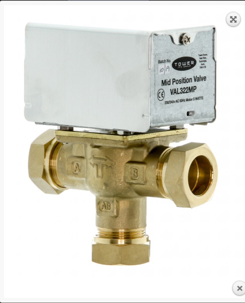

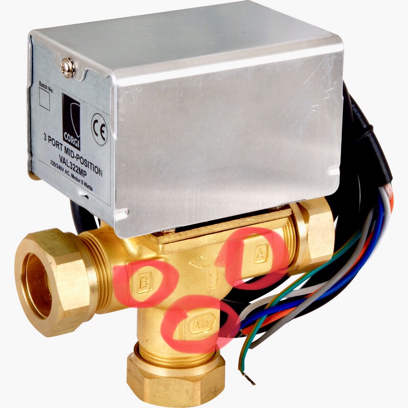

Jon,
What @ianmcd means, is the letters are stamped on the valve body. Ab is flow into it, A to air (heating) B to Bath (hot water)
Jon,
What @ianmcd means, is the letters are stamped on the valve body. Ab I suspect flow into it, A to air (heating) B to Bath (hot water)
Only on the plastic heads , the one he has is a Honeywell copy they dont have the position indicator
Thanks, however when I rad his original post, he said he’s got a tower valve , which going by the photos it’s stamped into valve body?

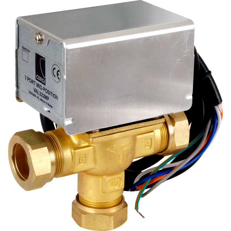

FWIW the original valve was a Tower part, the replacement head I bought from Toolstation is a Corgi one but it seems to fit OK, wiring the same etc.

Again mate, not dealt with many of these, so am I wrong in thinking that the lever moves to the sections labelled or is that for piping purposes only?
