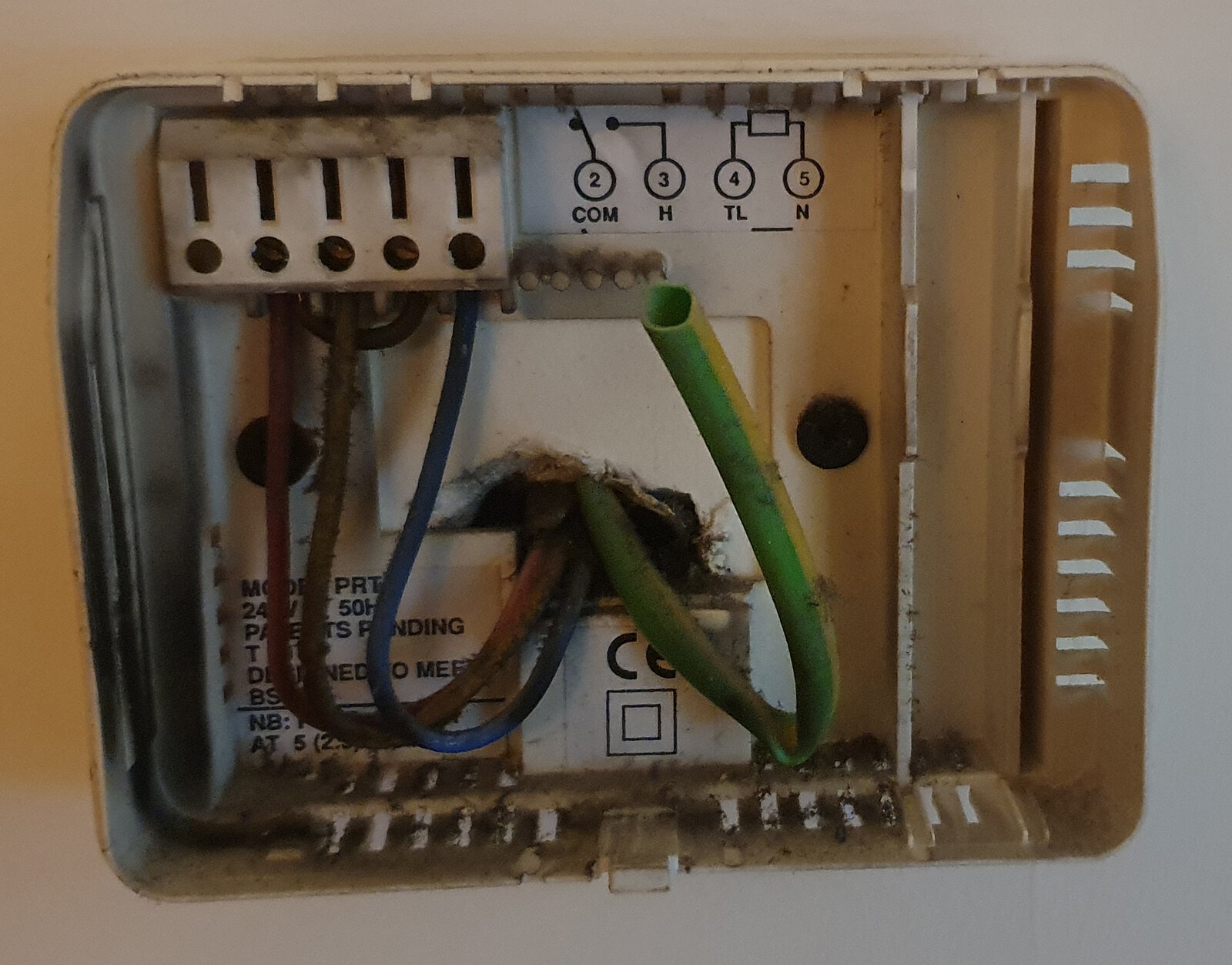

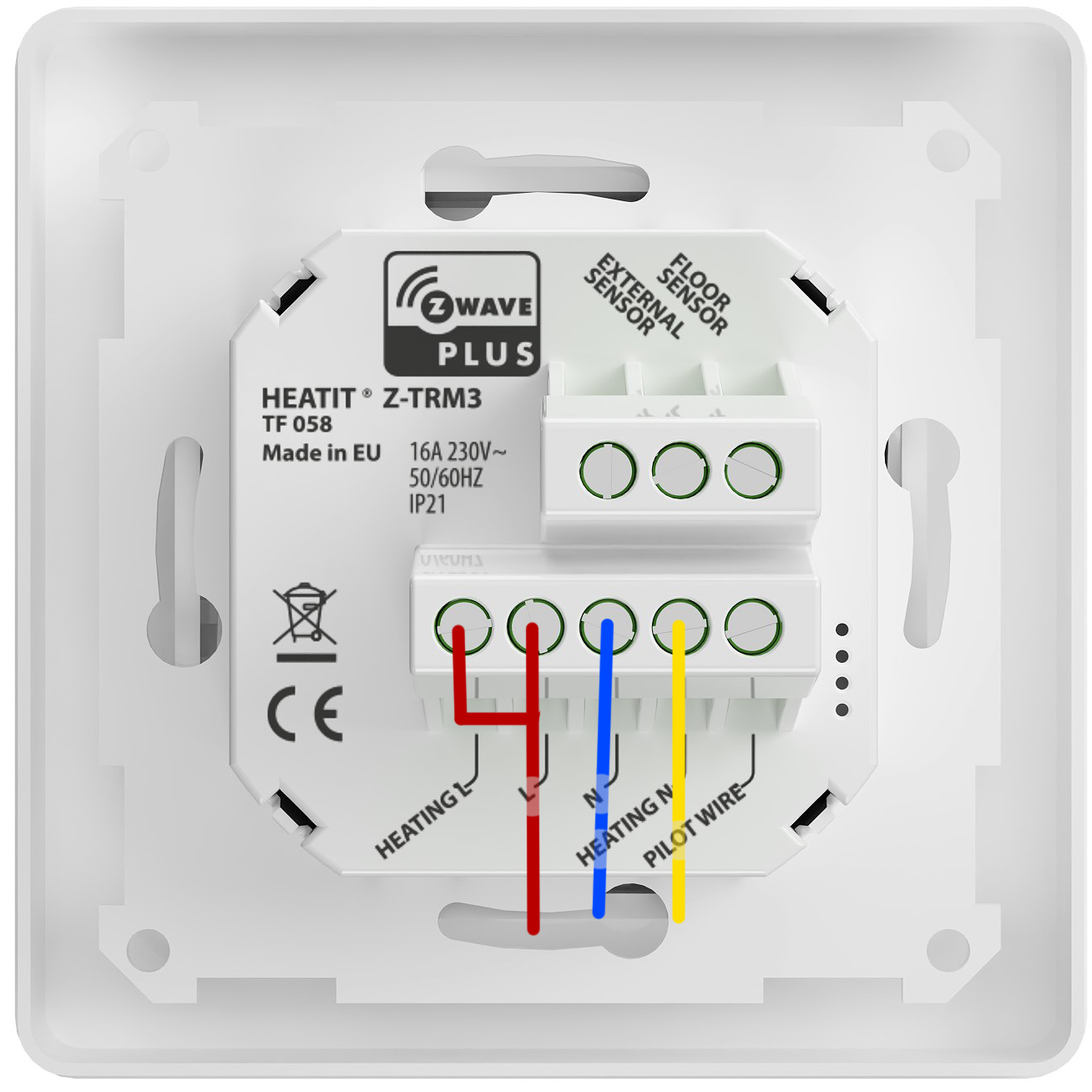

So I've got a new Z-Wave smart thermostat. Does my wiring look right from my old Potterton Prt2 Thermostat?
Old:

New:
Yet to hook it up. Does this look right?

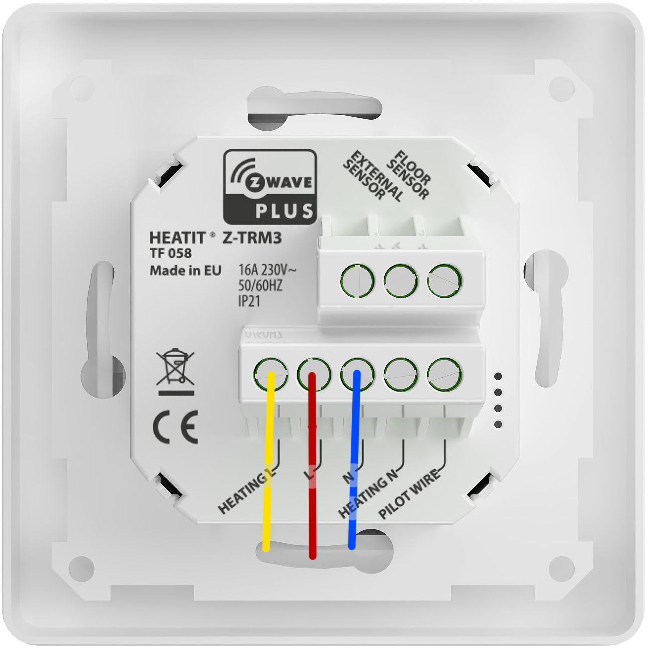

I'm afraid, not quite.
Your new stat is designed predominantly for electric underfloor heating - it provides double pole switching, i.e. a live and neutral in, and a switched live and neutral out.
To replace the existing Potterton...
The Red wire in terminal 2 (COM) would connect to 'L' on the new stat.
The Blue wire in terminal 5 (N), would connect to 'N'.
The Yellow wire in terminal 3 (H), would connect to 'Heating L'.
No extra links are necessary.
The Green and Yellow earth wire would be left safely isolated in a separate terminal block.

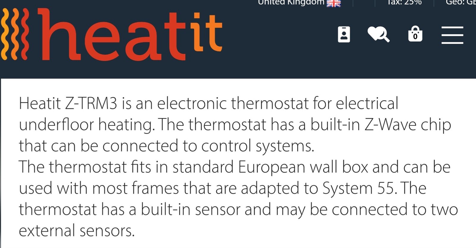

So is there no internal heat sensor built into it? I will have to get a sensor connected to top right to get a temperature sensor to it?

You're a great help RandomGrinch. Thanks a huge amount. It was really hard to find a decent looking Z-wave thermostat that would work in the UK. I've basically got to use this one or go with something ugly in my front room.
Right right. I see what you mean about double pole switching as well. Did some reading and I feel I understand your solution now as well. Which is a lot better than just doing what you're told isn't it.
Just dropping the full name of this thermostats for some poor soul searching through google:
Heatit Z-TRM3 White RAL 9003 Z-Wave Plus thermostat 16A
