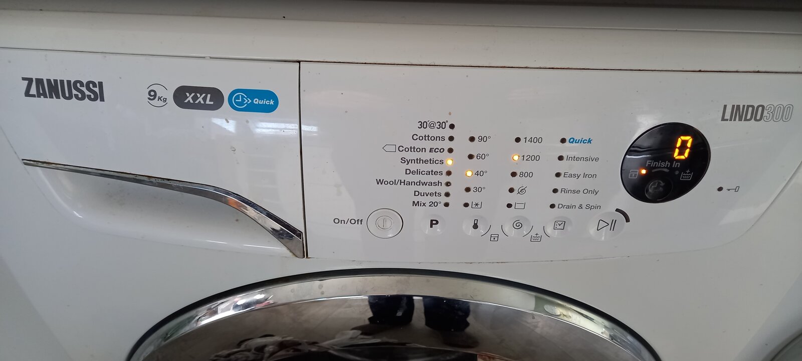

My 10yr+ old washing machine has packed up.
The pic shows the indications, and no matter what I do with the buttons/door/power they remain unchanged.
The door will open and close ok.
The wife is now using it as excuse to buy new......but not on my watch if its fixable.
It has never let me down before so am keen to do what I can.
Any thoughts?
Cheers
Doug
Cheers both
I have tried both Diagnostic Mode and Child Lock, but sequence does not change the indications as shown on my pic.
It seems that the programmer has 'frozen'. :(

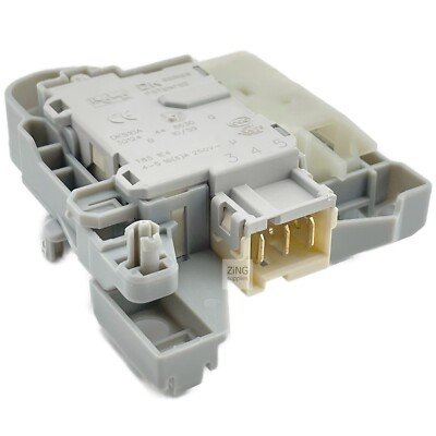

If it does not work in diagnostics then possibly worth trying a new door lock, presuming the actuator has not snapped off the door.
but check it's the right one for your model. click on blue highlight

Lid off....checked all connections....PCB showing no obvious damage.....no change!
During this time my wife has checked out Which? and already has her eye on a replacement.
The machine has served us well and now is the time to bite the bullet and admit defeat.
