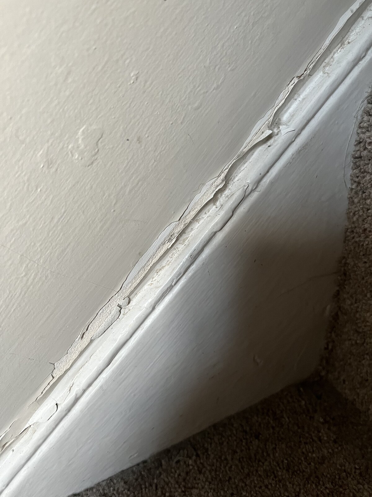

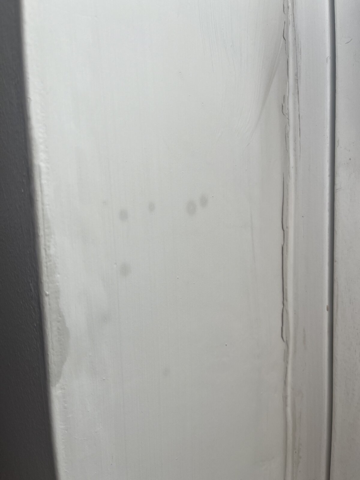

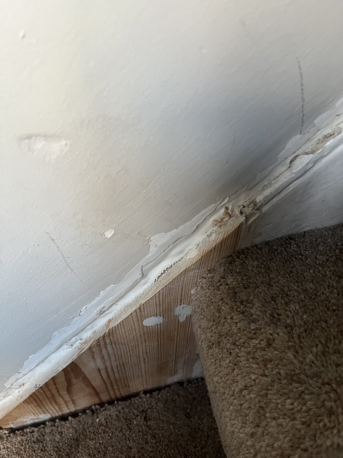

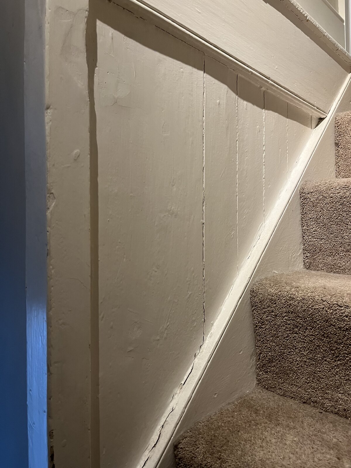

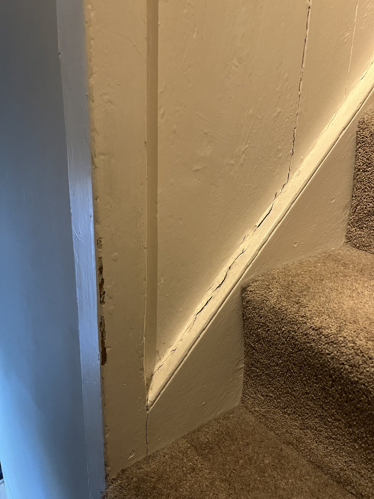

The old skirting board on the staircase seems to have been painted over many times. You can see it’s peeling away from the wall (no idea why?!!) also the panelling up the staircase looks to be painted each time. Would sanding this all down be ok, or does it need to something stronger like paint stripper? Am I going to need to lift the carpet to get to it all?!

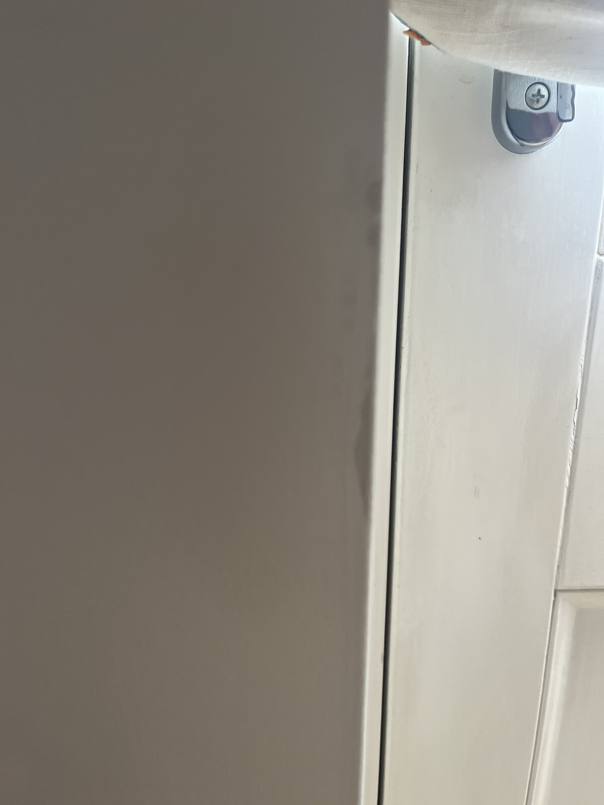

I had to have some of the skirting replaced (see photo) can that be painted straight on it or does it need priming?
Image 1.- Try 80 grit paper wrapped around a cork sanding block.
Image 2 and 3- it looks like there may be some bounce where the timber wall meets the timber stair strings. Use a sharp utility knife to cut through the paint where the wall meets the top of the stair string. You should then be able to lift the chipped paint out. Backfill with the Red Devil.
Image 4 - yeah you need acrylic primer/undercoat.

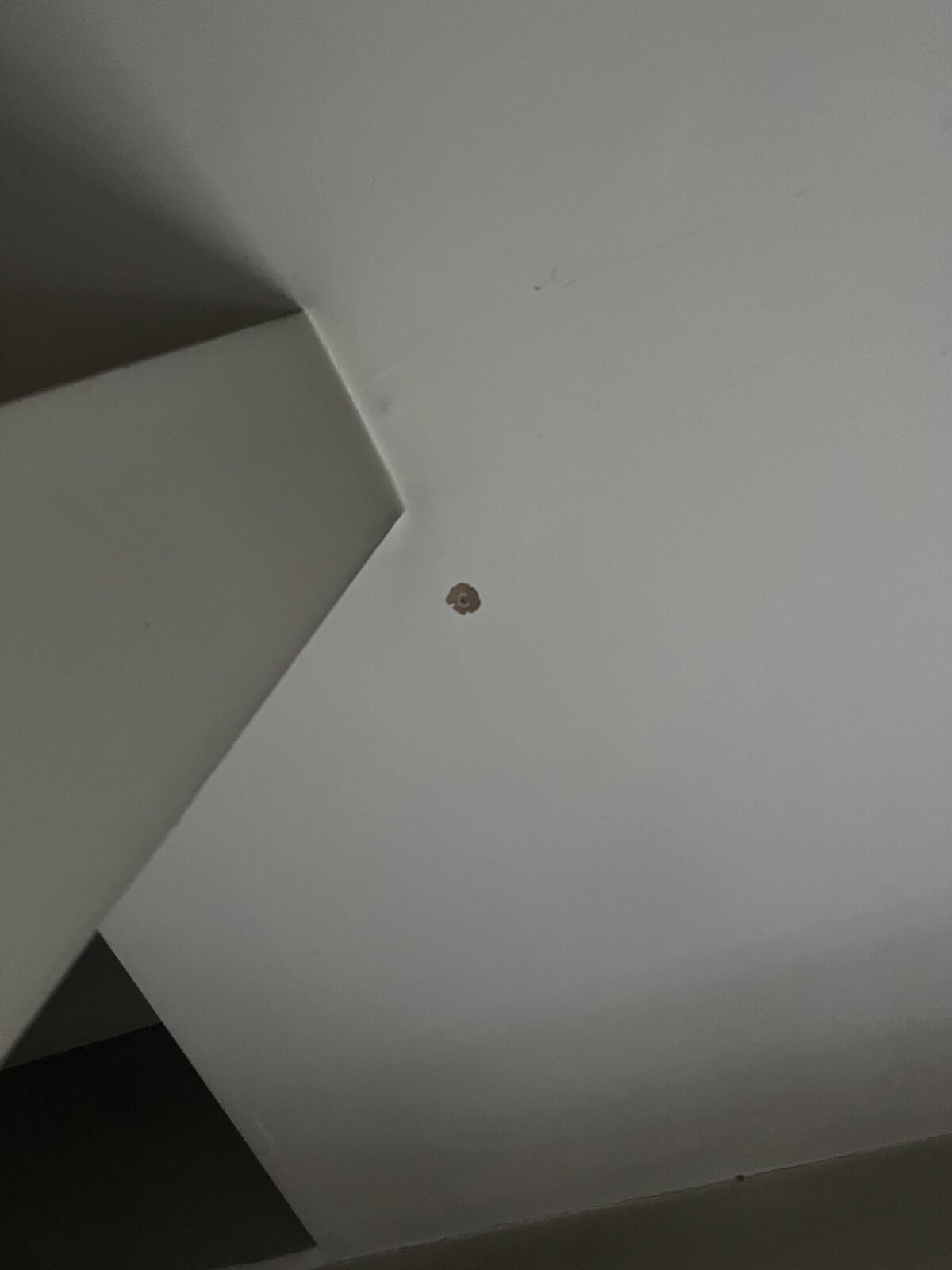

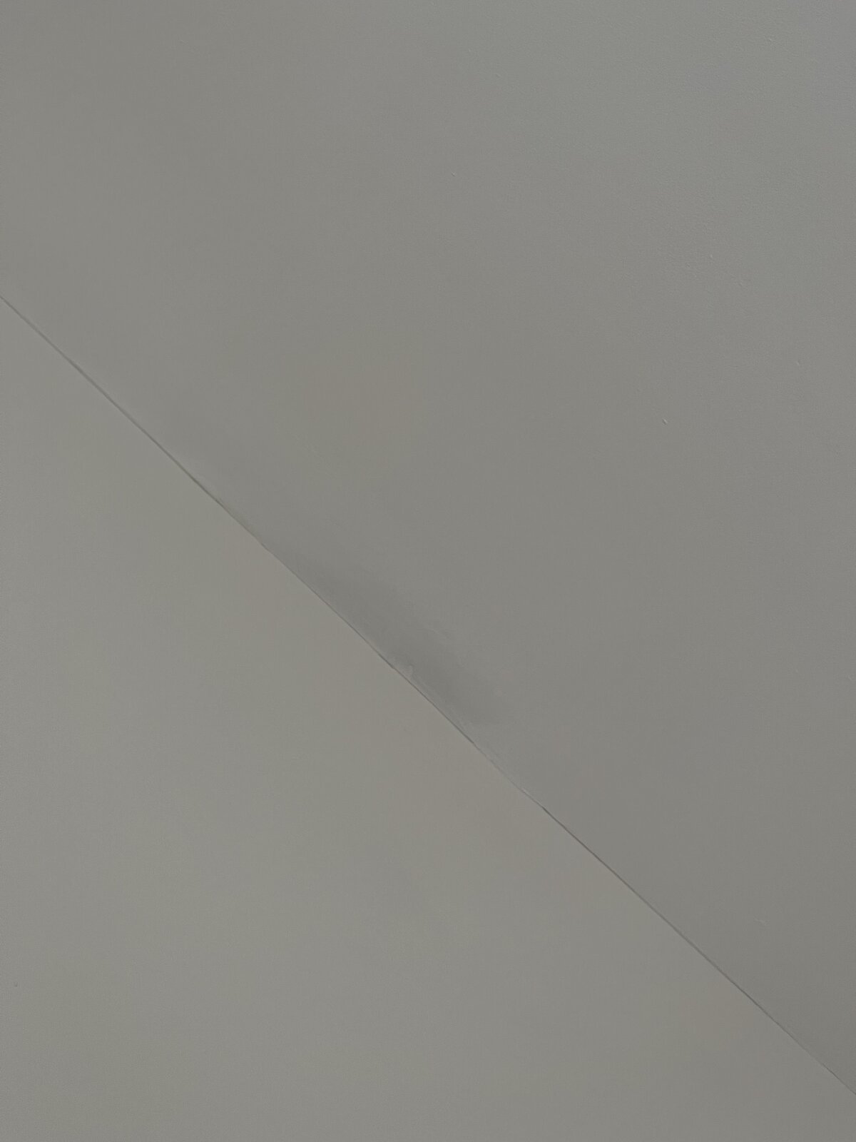

there are chunks of plaster have have dropped out of the ceiling in the kitchen, mostly around screws and there’s long cracks. See photos. What do I need to use to fill them?

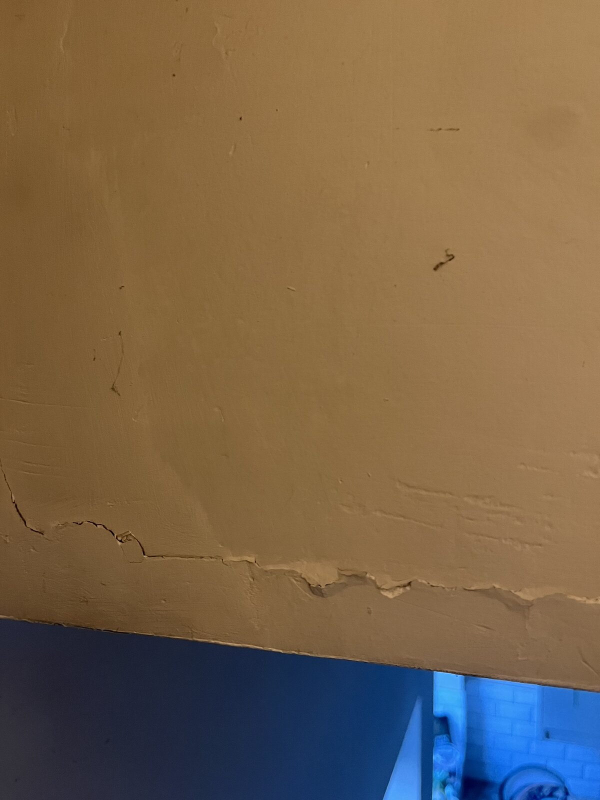

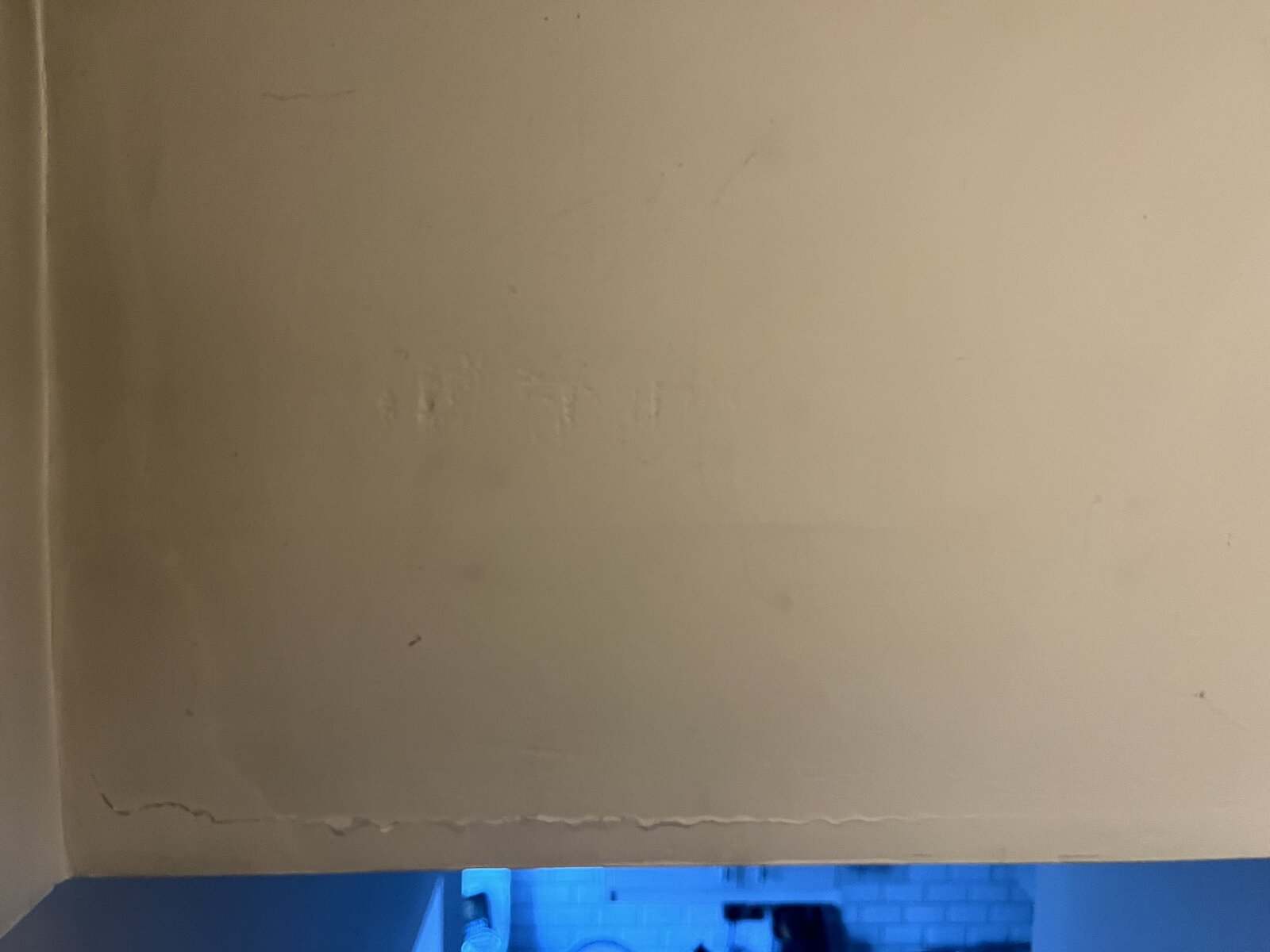

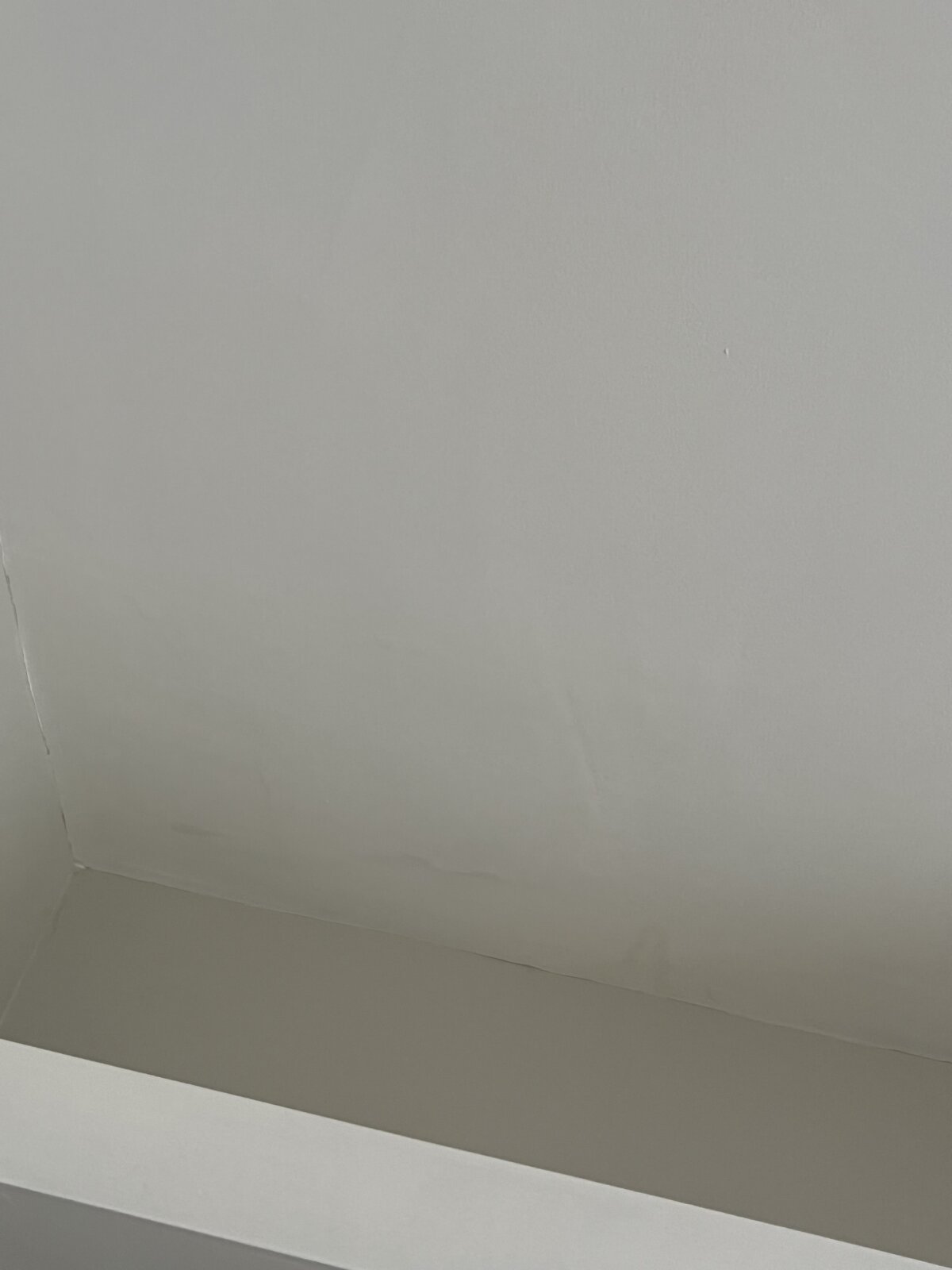

Then there’s this where it’s coming away from the wall. What’s the best way to deal with this?

Popped screws in plasterboard. In most cases they were either driven in too deep or not deep enough. You can try using a hand screwdriver to tighten the screw, if when you push the plasterboard you still see very slight movement, you may need to use a new screw next to it. Unfortunately, the plaster is much harder than the plasterboard. On the balance of probability, you will need to use a countersink to bury the head under the plaster skim.
The cracks in your images look as though they are at the edges of the angle bead. It may well be the case that the timber framing has shifted very slightly. They can be problematic if the angle bead had not been screwed hammered in properly. Faced with that, I would gingerly chip away the damaged plaster. I would then use some Toupret Flex and Fill filler. It is like a caulk but has (mocro) fibres in it. It will shrink back (like all waterbased caulks). The next day, I would fill it with the Red Devil filler (or whatever you have).

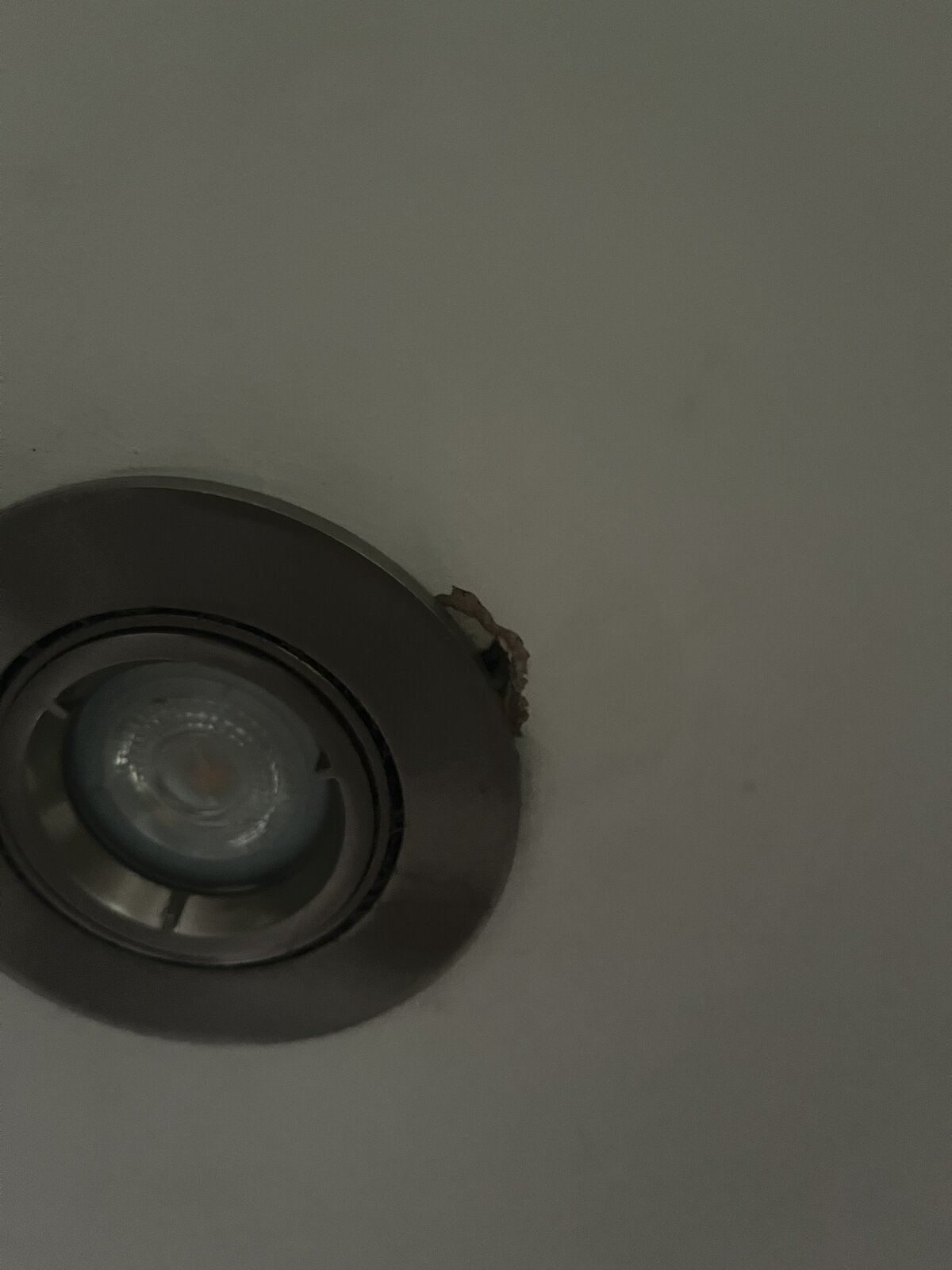

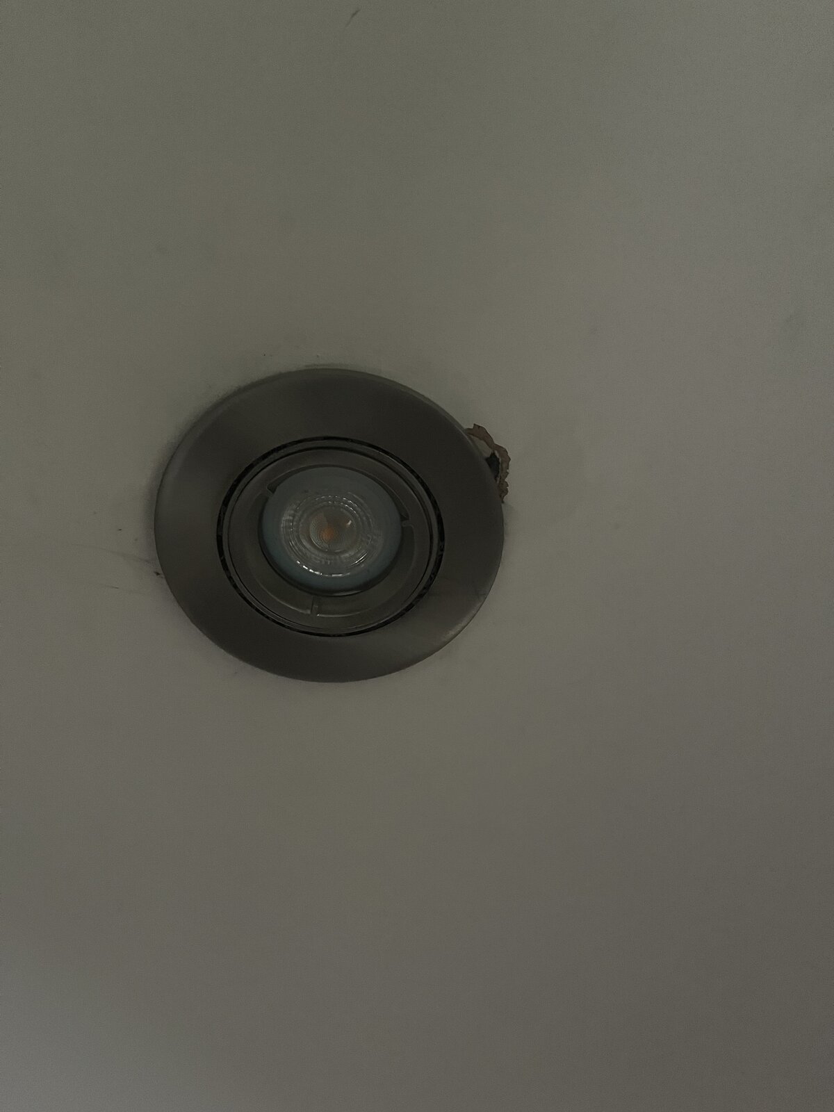

There’s damage around a light fitting when they have to be completely replaced. What can be used to repair it? Is it easy enough to do? Or does it need to be someone who knows what they’re doing?

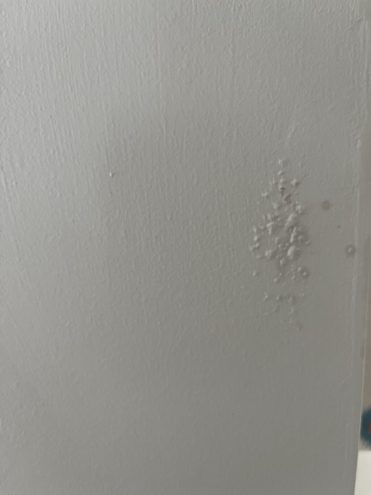

I’ve noticed hard bubbles appear in the room that was redecorated in December. I think the spots are possibly damp as the guttering has been leaking down the wall. Can the hard bubbles be sanded off and painted over?

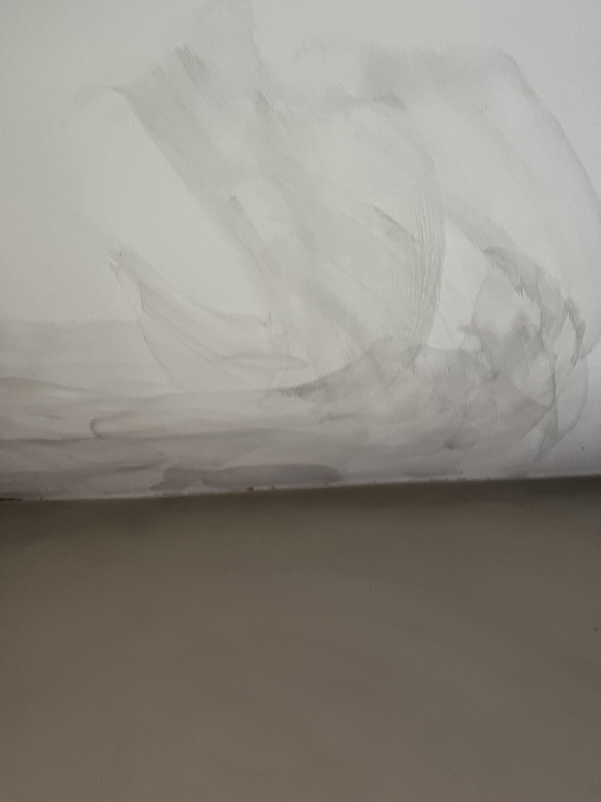

Also, there’s some patches on the ceiling that need touching up that the decorator did in December. There were water stains in the ceiling way before I moved in from the bathroom above, but when he’s painted it, it’s like the dirt has been smeared. I asked him what he used and its armstead trade. I don’t really want to spend £20 on paint to do touch ups that I will never use again (but seems easier than to ask him to come back and do it himself)
can I just buy any small pot of Matt white or is it going to be noticeable?!

The hard bubbles are probably down to water damage. Assuming that the water ingress has been resolved- on the balance of probability, yeah, you can knock off the high spots, sand back, then fill prior to painting.
The image of the damage to the side of the spotlight. That is very common. I come across it quite often when I "drop" light fittings to repaint ceilings. Those fittings often use mouse trap type springs to hold the lights in place. Unfortunately, it is often the case that the electrician uses a hole cutter that is nearly, but not quite the correct size, then the plasterer skims and there is a slight overlap.
You might be able to drop the light fitting, fill and twist it by 90 degrees. If you don't twist it, the filler may fall out as you push the fitting up.
