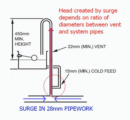

SO, now I'm slowly catching up with the concept of SURGE. Apparently "surging" is the fancy plumbing term for the problem in my system.
Looking at the recommended installation diagram, the top of the open vent loop was shown at a minimum height of 450mm above the head in the F/E tank. This step is presumably to stop a surge getting up and over the top of the loop. The figure of 450mm is no doubt empirical.
But the height of the surge anticipated by these recommendations will be governed by a number of factors, and as I'm pointing out here, one very significant factor is the ratio of the diameters of the system and vent pipes. A surge in the system bore (28mm in my case) will be amplified when it enters the smaller 22mm vent pipe - by my calculation 1.6 times the velocity. Yet the best guide to this that I've seen is the note "22m (MIN.) VENT" on my boiler installation diagram posted above.
This should make it clearer:

As a topical update to this thread I finally got round to replacing all the 22mm pipe in the vent T-off with 28mmm and the surging stopped. Some here may be surprised, some not. I wasn't - just very relieved (mostly of cash) .

It's not tha ratio of the diameters which matters, it's whether you can accommodate the surge volume in the normally-empty part of the pipe.
So if you can't go up, you can go sideways.

As I said above, that was tried before the F&E tank was raised but the plumber who did it was skeptical and didn't really "go for it" with the height. In hindsight, increasing the head by a metre or so damped the surge a bit and combined with the higher inverted U that was retained from the first experiment got the job ticked off for them.
As for the ratio it goes both ways. Sure it's a matter of accommodation, but the narrower the bore in the vent the higher any given surge will climb. Also the velocity multiplication factor was playing a large part in the water managing to get up and over the bend - hard to explain but what you could see coming out was more of a squirt than a pipe-bore full. Using pipework having the same CSA has calmed that completely.
