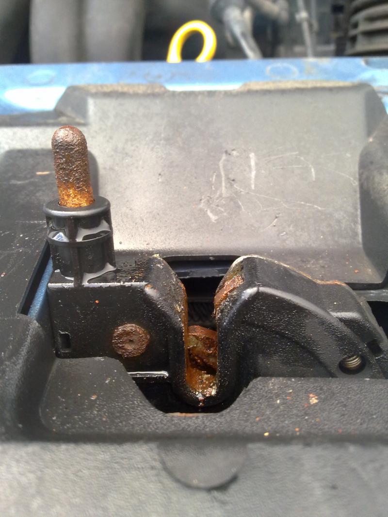

Hi,
**first of all, this topic is specific to those who have a MK1 focus (1998-2005). Most threads and forums i have read for help on this issue, all across google, deal with the MK2 focus from 2005 onwards, and as such I wanted to share my experiences trying to fix my 03 plate UK ford focus.**
firstly, i am one of these focus drivers who has recently gone to open my bonnet (to jumpstart my girlfriends car) and discovered that by turning the key left and right as usual, the bonnet on my MK1 focus would not open at all. slightly embarrassing!
typically, this happened on the coldest week of the year. anyhow, for the last two weeks i have read scores of different articles online, to try and find out how to fix this problem myself but have found that as I tried each of the different methods to get into my bonnet, none of them seemed applicable to my car, which is when i realised i was reading mostly advice for the MK2 focus.
from what i understand the MK1 has the same or a similar issue with the bonnet catch / lock seizing as the MK2 does, where you cannot get into the bonnet using the key. from driving my car to three or four local garages for advice, the consensus was that the only way to get into the bonnet was to book it into the garage, where they would have to either drill out the lock / attempt to take out the grill without breaking it / get it up on the ramps and try from underneath, all of which for me required taking it into a garage and paying.
i did however after a week or so of perseverance, manage to get the bonnet open on my focus, and am now at the stage where i can attempt to fix it my self. out of all the methods i tried the only method that i think worked was to keep twisting the key left and right, whilst pushing on the bonnet and pulling to try and free it. when i did free my bonnet, it appears that the latch / mechanism had seized - see picture below.
i am lucky as my lock barrel is still working, as when you look from above when the bonnet is open the plastic connector shaft between the lock barrel and the lock mechanism (latch) rotates left and right as per the key movement but it appears the shaft has somehow come away from the locking mechanism.
the cost of a new locking mechanism is £24 + vat from my local ford dealer which i have ordered but now i have to do the hard part and sort it out! the garage seemed fair and offered to fix it for £75 inc. vat and inc. the part, which in my opinion is good for a ford garage (half an hours labour) but as i have zero money at the moment, have opted to fix it myself and swap out the new latch mechanism.
this is the part i have ordered: http://www.fordpartsuk.com/shop/focus_mk1_bonnet_latch_rhd_models_only_2016.htm
to take the top shield and upper grill off took seconds, 3 self tapping screws to prize out for the shield, and two clips to unclip, 2 x 10mm (i think) bolts and a small crosshead screw to remove for the upper grill.
the challenge now is that the two bolts that hold the bonnet latch / locking mechanism in place appear to be crazily close to the radiator. i will take some more pictures tomorrow when i have another go at trying to locate the bolts but at the moment, have no idea whether i will be able to get to them to get them out.
if anybody else has experience of swapping a ford focus mk1 latch it would be really useful to hear your comments. i hope i don't have to take out the radiator!
thanks for reading, and hope this is useful to someone, i will update more as i make progress!

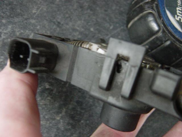

hi ff,
had the same problem, wasn't broke just the plastic X had popped out.i used this link to solve it,and has been O>K> since.hint put masking tape on leading edge of bonnet to save scratching it.
http://www.diynot.com/forums/viewtopic.php?t=98674
and thanks to philgc for his post,
con.
EDIT sorry ff,just seen your post on that thread,still useful for getting the bonnet open though,

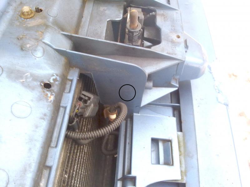

thanks Con,
went out just now to have a go, it looks like the latch is definitely in need of replacement, as i pushed the key barrel with a screwdriver so it was displaced a couple of mm out of its seated area towards the lock mechanism. the result was that the shaft went further info the lock mechanism, and although moved the mechanism slightly when the key was turned, did not have the impact it should have done.
wondering if there should normally be that much play though between the shaft and the mechanism, i hope the shaft hasn't snapped aswell.
also bad news on replacing the mechanism myself, i had another look and it appears you can't get to it because of the casing around the mechanism, so would have to try from underneath or release the cooling pack or such. see attached picture...
the black circle is the approximate location of the bolt (mirrored on the other side) and there's not enough room to get in between the radiator and that housing :[ so looks like i'm off to the garage to resolve unless anyone knows of any other methods. thanks,

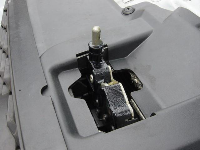

So, first things first - lets see if we can get to the latch from inside the car.

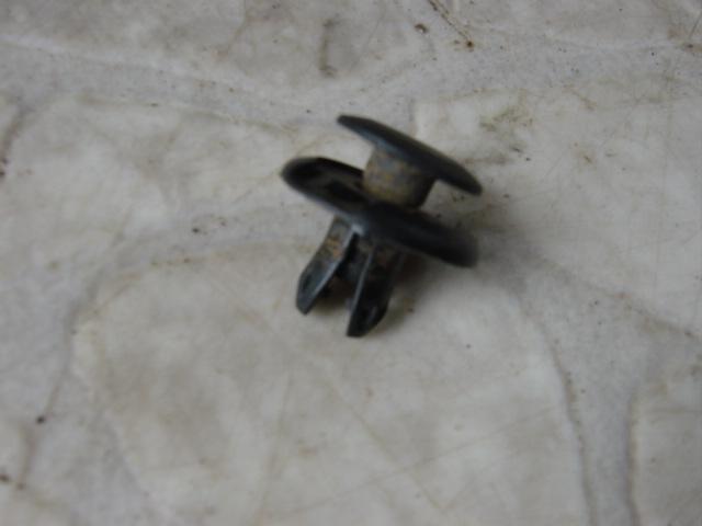

In order to even see the latch you have to unclip a protective plastic cover that is attached between a rail below the radiator and the front bumper. I can only describe these as plastic pop type rivets.
There are x4 of these. Inevitably I broke all 4, but at about 38p each (from Ford) this wasn't my primary concern.
Once the cover is loose, you can turn it back on itself so that you can get a good look up between the radiator and the front of the car. Use a torch or light beside you and you'll see the latch at the top of the opening The tricky bit now is to get your hand and arm betweeen the small gap that has been created between the plastic cover and the steel rail that it was attached to. You won't snap this as the platic is manufacturing to fold in this way. The gap is about 2", so any body builders out there are going to struggle with this. I have a nice long bruise along the full underside of my arm and a massive graze on my forearm from these endeavors - so be warned!
Ok, now that you can see what's happening and you can now get your arm into the gap, you can feel your way up, to where the latch is located. Be careful of the radiator fins - they are very delicate, and easily damaged.

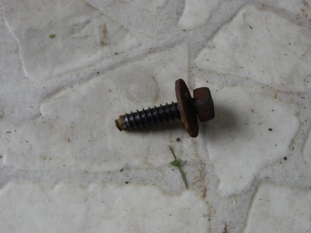

The latch is connected to the car body by two M10 screws.
You'll also notice (or feel rather) that the latch mechanism is "smooth". I didn't understand this at the time, and I'll come back to this again later on. However, for what its worth at the moment, this is in essence a steel plate that has been "wrapped" around the latch mechanism.
The same two M10 screws hold this cover over the latch and fix the entire assembly to the body.
Using a simple open/closed 10mm spanner carefully undo both of these screws. It's not the easiest task in the world and you have to go a tiny fraction of a turn with each movement as you go - to avoid contacting the radiator fins. It's tedious... and this is where you mess your arm up a little. Forewarned is forearmed! - No pun intended.
The reason we have to do this (again, a little hindsight here) is to get the surrounding plate away from the latch. Although the heads of the screws may be rusted, the screws are actually screwed into plastic, so its not as bad as it sounds. Its not like its rusted in to steel or anything. Good news there then. :)
Once both screws are out you will be able to bend the surrounding plate a little in order to remove it. It will simply drop down and out. Nice.
Important note: The surrounding plate that you have just removed serves no real purpose that I can determine other than to protect the latch from "prying eyes". Again, I'll be coming back to this later on.
You now have a latch that is no longer attached to the body of the car, but is held in place by the latch mechanism holding the bonnet catch in place.

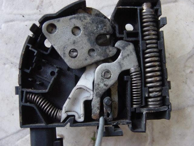

My thinking was fairly straightforward: Locking and latch mechanisms work on some form of pivoting. So, destroy the pivot, and the mechanism should fall apart.
To this end I found that the bonnet latch on the Ford Focus Mark 1 has three pivots. Two of these are accessible from inside the car, but the top one isn't. Lucky for me that you only need access to the bottom two.
HOWEVER, the latch does have a weakpoint - one which I'll get to later - but first, I'll take you through how I got mine off.

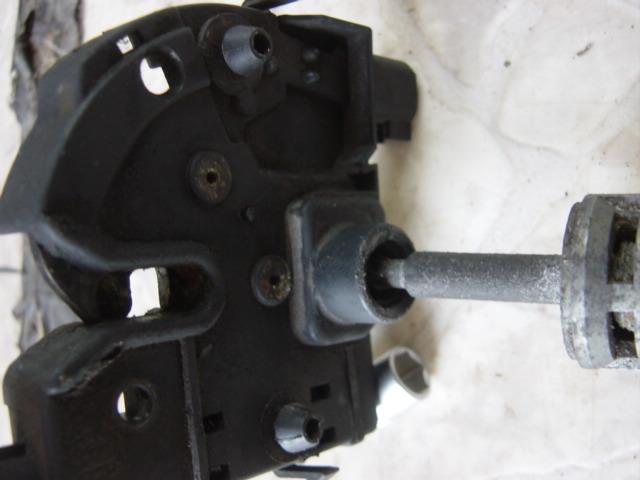

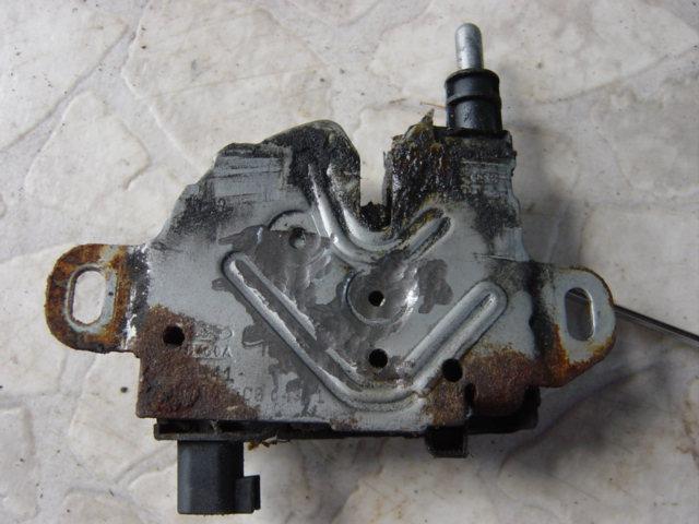

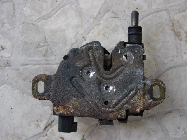

Taking a dremel tool with a stone wheel on it I ground off the bottom two rivet heads that you can access from inside the car.
Once I had ground off the heads I could see that the steel back plate came away from the plastic surround fairly easily and, as I guessed, the latch mechanism twisted and fell apart.. thereby releasing the locked bonnet catch. Success!
(This is a picture of the one that I took off the car)
But. Hang on ... that's all well and good when you're on a workbench with lots of access and you can see what you're doing. True. It's a different story when you're navigating small areas with a high speed dremel in one squashed up hand, trying not to damage anything else and going by "feel".
Difficult, but as I have shown - it is doable. There is however another way. Yes, yes, we'll get to that in a moment. :D
Anyways, once both of these privot pins were successfully ground off, from the latch in situ on the car, I was able to use a longish flat screwdriver to "pop" (or twist) the metal plate from the plastic housing, as I had done in the garage earlier, and the whole latch mechanism fell apart. The bonnet was now free and easily moved up and located in its open position using its rod stand on the LHS.
Ah!, but here's the best bit.

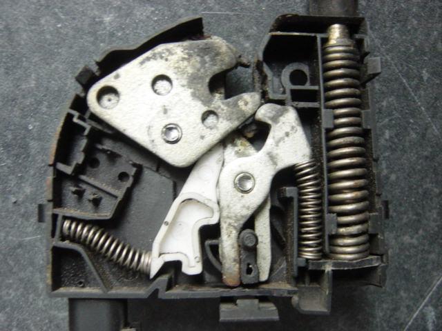

Once I had done all of this I figured that there must be an even easier way in. I mean, why surround the latch mechanism with a steel plate. It's not supporting anything at all. In fact, it looks more of a hinderance than anything else .... UNLESS ... its protecting something.

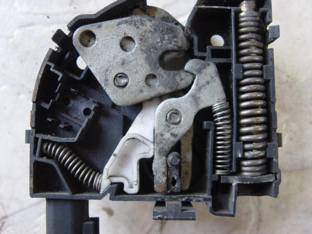

Having ground off the 3rd pivot pin from my scrapyard "test" latch I could now gain complete access into the inner workings of the latch... and lo and behold, there was the "access" point that I was looking for.
(internals in the "open" position)
(internals in the "locked" position)

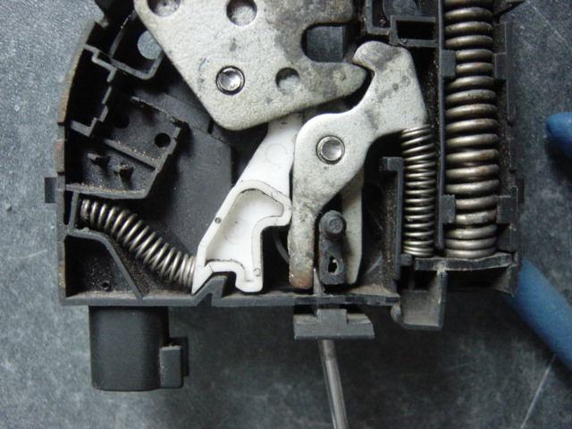

At the bottom of the latch, is where the lock connects with the latch via a steel shaft. This shaft is inserted into a cross shaped recess.
When the shaft turns one way (anticlockwise from the front on my car) there is plastic lever that moves the steel locking "catch" out of the way, thereby allowing the bonnet to pop up to the next position.

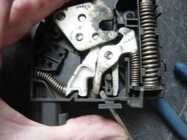

(internals with a screwdriver operating the "key" mechanism)
Inserting a small screwdriver between the plastic lever and the steel locking catch would therefore have the same effect as the normal key operation.
Ta-da! ... Eureka moment.

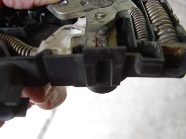

The bottom of the latch that you are looking at from under the car is made of plastic. Lets assume you either don't have the surrounding metal plate in place or you have already removed it (by removing the two M10 bolts).
Now, using the nib of a hot soldering iron, simply bore a hole through the plastic at the location shown.
This will allow a small screwdriver to be inserted into the latch from underneath the car.
A slight twist of the screwdriver or leverage towards the drivers side will then release the latch.
No grinding or dremel required. In fact, you won't even have to replace the latch (if you can free it up with a good soaking etc) as you won't have damaged the internal mechanism at all.
I'd like to think of this as the back-door entrance... and thinking about it, someone at Ford must have known about all this - hence the steel surrounding plate - which hinders tampering.
I'd also like to think that the majority of us would pre-empt this situation NOW and take the latch off, throw the steel plate away, and bore a nice neat hole in the plastic .. just in case... but I know we won't. That'd just be too much hassle. (lol) :D
For the rest of us, that don't take this route, there is a at least a one hour task ahead of you to rectify this situation.
In all probability, it won't cost you a damn thing. (other than perhaps those plastic "rivets") ... and that's well cool in my book.

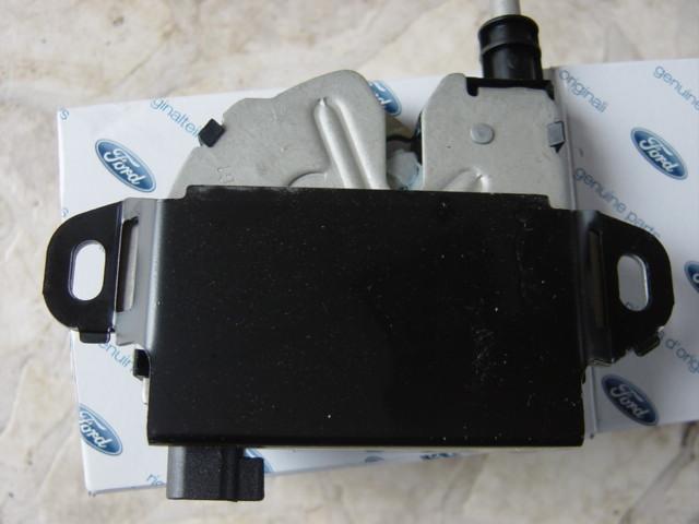

One sore arm and £45 later (as I had to buy a brand new latch from Ford due to time constraints) you all now have the answer to this problem.
NO real damage to your car.
(new latch in place)
