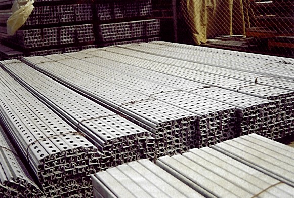

RF Lighting said:
Although in a domestic kitchen a more eloquent solution would be a 16A radial, with the microwave wired into a 20A DP switch.
Says he who has a uni-strut fetish :LOL:
Utter filth :LOL:
