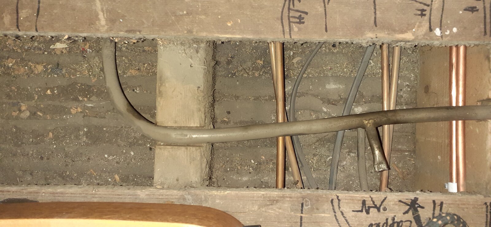

Hello, I recently bought a property and had British Gas come to service my boiler as I noticed the ceiling above it was slightly black and the hot water kept going on and off.
It passed all the service but was told I have a small gas leak of 2mbs so as it was in tolerance it didn't need to turn off my gas, and it was up to me if I choose to do anything about it.
I was quite worried but after some avid googling I realise 2mbs is a trivial amount of gas, I have a carbon monoxide alarm and a natural gas alarm which have never gone off and I can't smell gas. What should I do next? Should I get a second opinion and someone to fix it? Is it worth the cost?
No, 2mbar drop with no smell of gas is nothing to worry about and personally think it’s a bit of scaremongering. A carbon monoxide alarm will not sound from a natural gas leak. If you have a natural gas alarm which hasn’t sounded then it’s likely through the appliance. It could even be faulty testing equipment.

Or from the pipework itself. Here's my lead gas pipework, with crimps where branches used to extend to gas lighting on the walls - the joys of a Victorian property! :)
