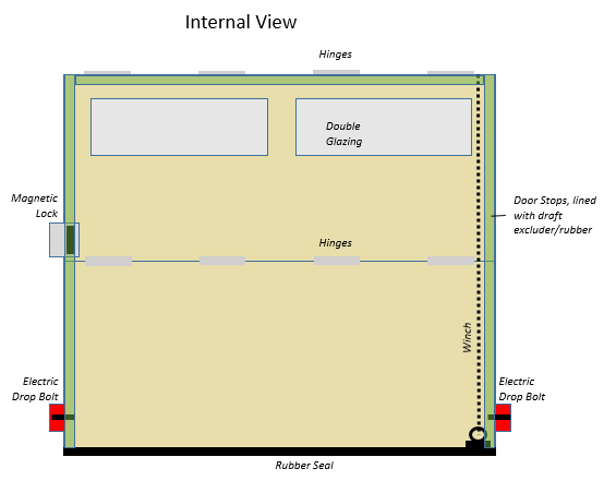

Hi All,
I need a garage door for a single garage that has been converted into a room. My use of the room is going to be a little odd - essentially I want to use it to house my motorcycle, tools etc, but also have it as a study. I therefore want the following:
  • To use an absolute minimum of ceiling space (preferably none) so that I can hang items from the ceiling.
  • To use a minimum of wall space when the door opens / closes (preferably only a small amount to support the automatic opener/closer & counterbalance mechanism)
  • To have a door with reasonable insulative properties to keep me warm.
  • To include 2 pains of double glazed glass to let light into the room
  • Ideally to be automatic (should have not a must)
  • Not to obstruct the left or right outside of the property when the door is open (as I need to angle the motorcycle so that I can ride past the car on the driveway)
Nothing on the market really hits my needs. Domina doors come close as they only use a small amount of ceiling space but it costs over £6k which is a lot of money: http://www.dominadoors.co.uk/
What I really want, is an externally folding hangar style door (like this) but I cant find anyone in the UK that makes them. Does anyone know where I might be able to source such a thing?
Alternatively, I consider myself an expert DIYer and I would consider making it myself. There are only a few concerns I have:
1. How to counterbalance the door properly (where could I get such a unit.
2. Where to buy a control unit for a garage door (which I would probably connect to some form of winch, and some electric drop bolts for security)
3. Are there any building regs against making your own doors? The room is still listed as a garage and it still retains a double locked fire door to the house and fire resistant ceiling & walls.
Thanks for your help,
Jon

I vaguely recall that the doors of this type I've seen have been worked with hydraulic rams & aren't counterbalanced.
What you'd need to consider is that there's a lot of weight cantilevered out when open - the typical up-and-over door doesn't really have much of that. So you'll need some substantial bracing if it's not going to pull the front of the garage off !

Expense is the problem, I wonder however whether this would be that expensive to make myself. I reckon 2 x 12mm structural Ply outside, 2 x 6mm non-structural inside, and a load of 44mmx69mm wood sandwiched in the middle with insulation. That would not be crazy expensive. Winches, electric locks etc are all fairly cheap these days as are the control units. I reckon I could build the whole thing for less than £1000, which would save me a fortune vs most other doors.
The counter levered weight is indeed the issue. A lot of the companies that make these seem not to bother counter levering the door at all. They just attach a winch to the ceiling and rely purely on electric opening. It would be nice to have a bit of cantilever just in case I did need to open it. I have seen some companies build a small cage to one side of the door, where they attach a weighted line. This is a single garage (2.4m wide) and I dont mind losing a small amount of space in the corner (it would be better than I would otherwise lose using a traditional door.)

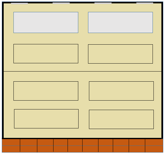

My wife and I would also prefer to to have side folding doors for looks and practicality. Mainly that with a car parked in front of the garage outward opening could be problematic, and inward opening means you lose space again. Also I think it would be more difficult to automate side opening doors. Anyhow, the wife vetoed the idea.

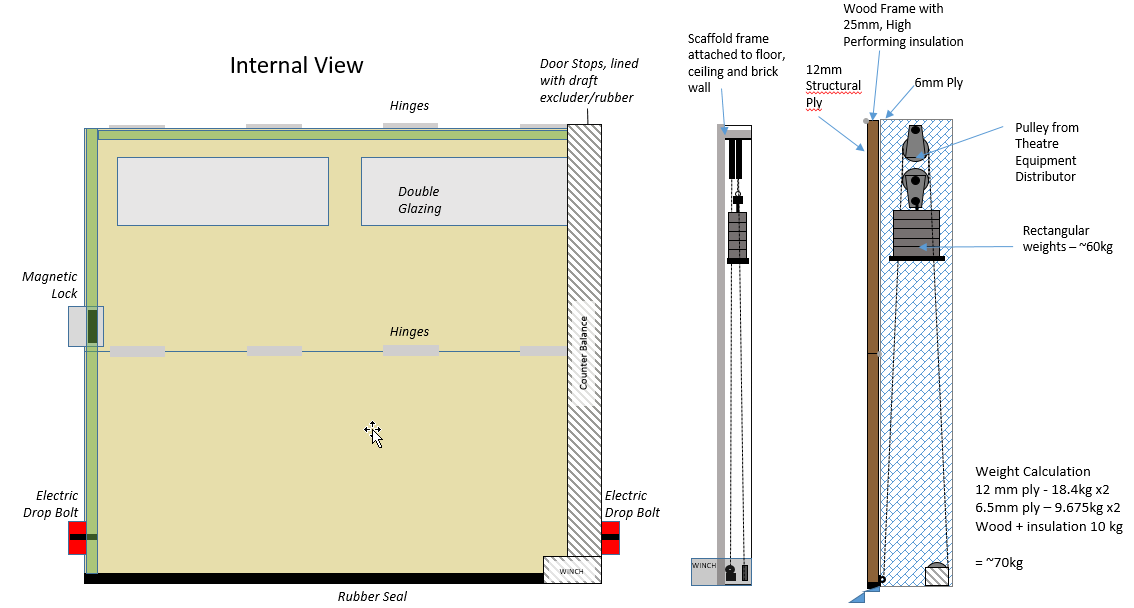

Here is another go at some designs:

For the bifold lifting door, I suggest you start with an estimate of the weight, then draw yourself a force vector diagram in the raised position. The higher you lift it, the shorter the moment arm between upper hinge and lower roller becomes. So you have all that weight of the doors, supported by an ever shorter lever - so the forces on the upper hinges lower track rollers increases.
That's why I warned about the cantilever forces involved. The upper hinge will try and pull the front wall off, while the runners on the bottom door will try and push the track indoors. So you'll have to restrict how far you open the door, probably losing considerable headroom.

As far as I can see you need two distinct mechanisms. the first is a bit like your third drawing , once you have a spring loaded idler to kick out the hinges, otherwise just pulling the wire the two sections will lock and try to lift up the lintel. With this mechanism only, the two doors will fold but only hang out by 20 degrees or so. You need a second mechanism to turn the top section outs to the horizontal.
Have you any experience with electronics? because I think torque controlled motors should be used rather then springs, much safer and easier to modify for an amateur. Loads of people sell chinese winches, mains operated, chinese rating is 220 Kg lifting weight, cost about £80.
Frank
If using a winch, take the cable down to the bottom of the door, round a pulley, back to the top and over another pulley, then down to a lever. When the cable is tensioned, it pulls the lever which can kick the centre out. You need to wind in a little over twice the cable, but only half the force.
The biggest issue I have with a winch is safety. You need two winches (one each side), or you need to arrange the cable run to operate on both sides at once. For this, you could run the cable from the winch, over a pulley at the top of the door, down to the bottom of the door, round a pulley, across to the other side of the door, round a pulley, up to the top, and potentially over a pulley and down to the "kick out" lever.
But, and this is a really really important issue, think about what happens when the cable breaks. I really do mean that, when the cable breaks, what happens. If you have two winches, then one side will drop "a bit", the doors will twist and jam, but it won't just slam shut at a million miles an hour. If you use one winch, then a cable break will let the door "just drop" which is a real safety issue - apart from it trying to break free of the fixings.
The usual way round this safety issue (and what's done with lifts and vehicle lifts) is to have brakes which will lock the door where it is unless there is tension on the cable.
