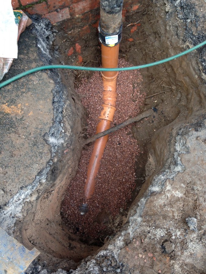

The cast can go down a bit though so you may end up doing a bit of a dig to get it out. They usually have a bit of a 'bell end' on them to to make them hard to pull out.
This one was about 12" down in Tarmac and replaced due to roots:
