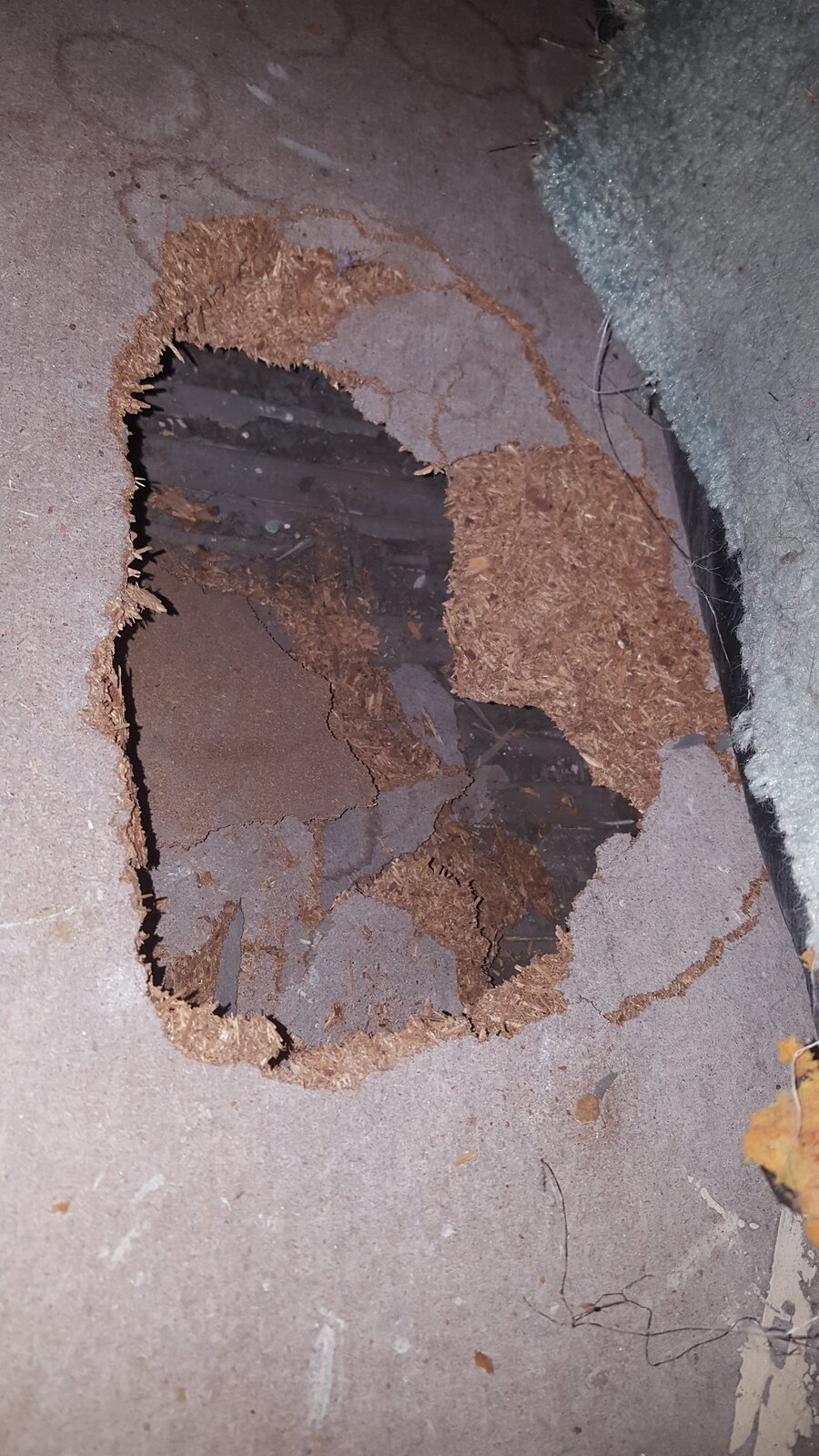

One of our lasses asked me to look at the floor in her spare room - there's been a hole in one place for a while which they put a sheet of board over, now another hole has appeared :
It's crumbly round the hole and easy to break more bits off - I can literally grab the edge of the board with one hand and pull more off it. It feels like two layers with nothing substantial in the middle which would make it quite weak to start with - very different to the high density flooring chipboard I'm more used to. While there are some water marks, I don't think that's particularly the problem. Also, from the bit I was able to see pulling the carpet up at one end, it's not 2'x8' sheets as it's definitely more than 2' in both directions to a join. I'm wondering if it's the wrong sort of chipboard to start with.
I'm thinking the only proper fix here is to rip the lot up (it'll keep her in firewood and kindling for a while :rolleyes:) and replace it with something else. As it happens, I'm planning to remove the Caberboard in our lounge to replace it with "proper" boards and level everything up - but my plans were that it'll be a while before I do that. May have to bring that job forward. Either that, or just shell out for new boards for her house.
I guess I already know the answer - but sometimes you just have to let off some steam when you've had your fill of fixing stuff that could have been done right in the first place.
i could be miles out but that looks like just basic 12mm chipboard
is there joins at 6ft and 2ft ??
If that is lath and plaster ceiling maybe vac and pva to strengthen then fill void with insulation before new floor goes down.
Maybe drinks spilt then stood on caused damage to floor
Is that board at least 18mm thick? If not, then it isn't flooring grade chipboard. Is the last 2 or 3mm below the surface on each face denser than the core? (FG chip should be denser at the the surfaces with finer material and it is very obvious visually). Older FG chip used to come in 8 x 4ft sheets with square edges, so no T&G. From your description it sounds as though shipping case chipboard may have been used - horrible weak stuff. It takes a lot of soaking to weaken FG chip, so I doubt that a few glasses of vino knocked over would weaken it
Very much so - as I mentioned, the core is so soft I could pull more off by hand, with the top and bottom coming off in separate layers.
I was thinking along those lines.
Did it break under the leg of a bed?
That particular hole is in the doorway, the other (older) hole wasn't under a bed leg.
The other possibilty I have wondered about is whether or not the failure is at an unsupported joint
