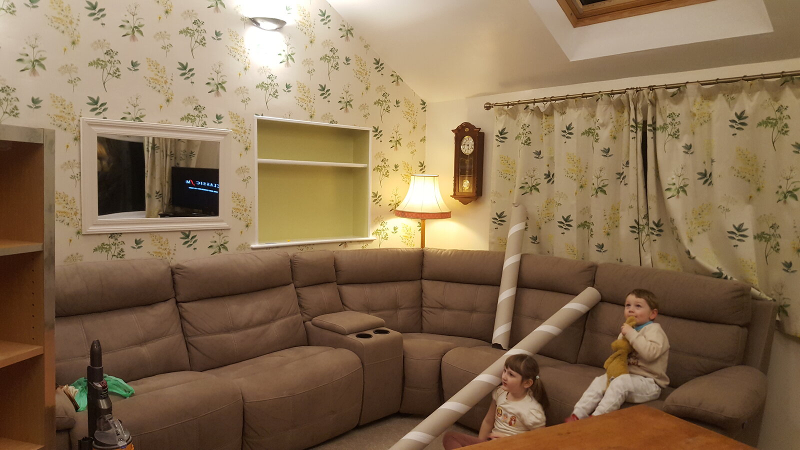

Finally, got it all painted/papered, electrics sorted, and the furniture back in place last week - so got it "done" in time for Christmas as instructed by SWMBO :D SWMBO is generally happy, but pointed out that using silk paint makes all the poor plastering show up if you look even a bit closely. As long as you don't look too closely, people are impressed.
