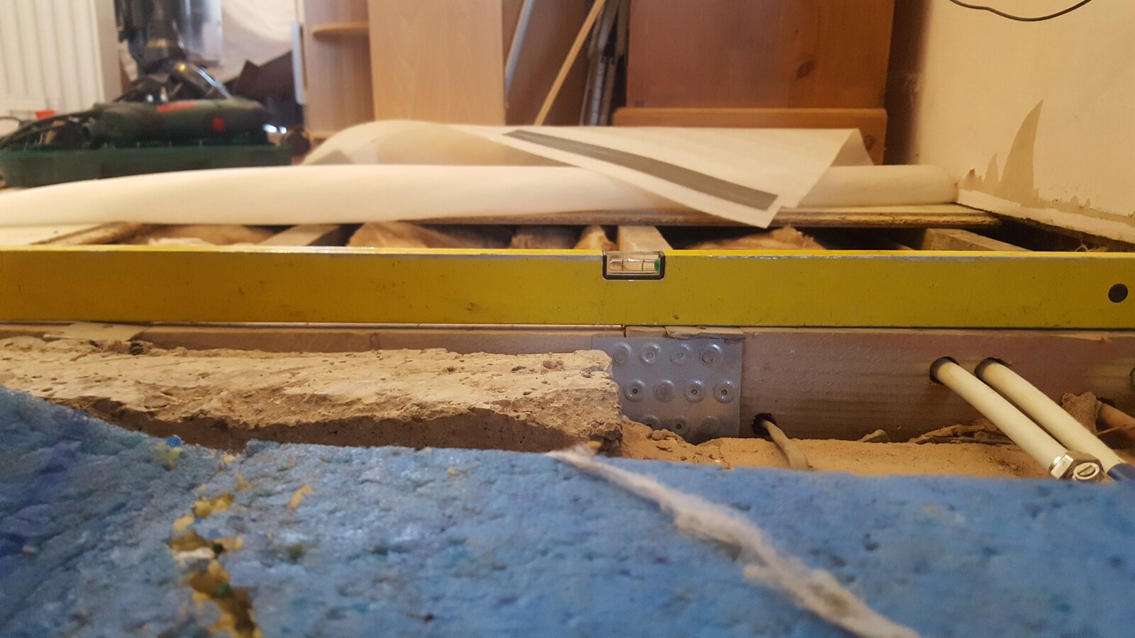

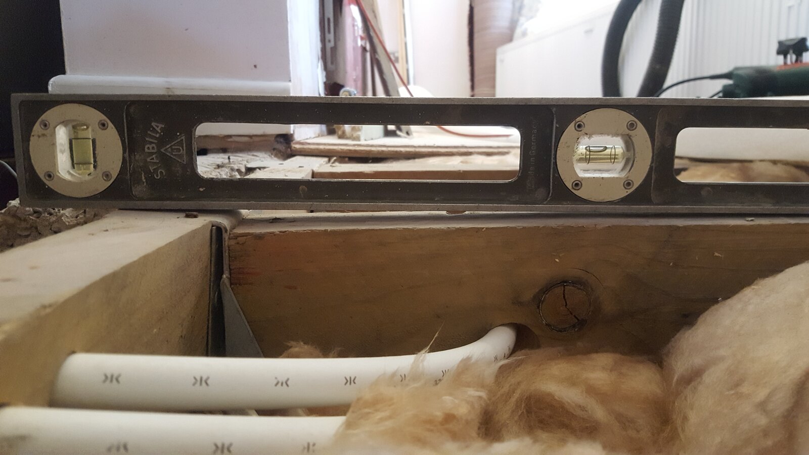

I got as far as lifting one corner sheet last night, and this is what I found :

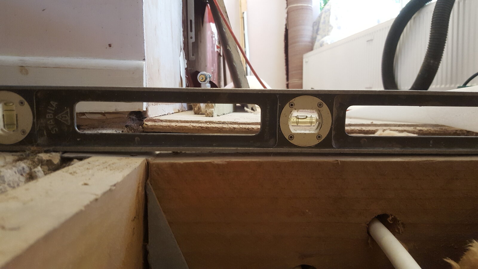

According to the tables I've found online, the joists are only just large enough - 8"x2" with 4.1m span, no idea of timber grade but I assume building control must have signed it off (or did they ?) But in this corner in particular, there's holes drilled every which way - you can't see the end joist (off to the right in the last picture) where there's at least two holes drilled diagonally and nowhere near the centreline :rolleyes: But just these bits show that the joist tops aren't level.
I don't know if it's just this end run of sheets where the joints aren't over the joists - the next run does have joints where they should be, I haven't uncovered any more yet. For good measure, I can't get the furniture out of the room so can only do one half of the floor at a time.
I'm thinking that without a lot of work cutting variable thickness shims (I had an idea last night how to make a jig for that), regular (120 or 150mm wide) T&G boards are going to accentuate the problem. I suppose I could just deal with the ends and leave the middle as it is (lets the boards follow the contours of the joists) - but I know I'll always feel that uneven floor :(

All I'll say is that his work has a certain je ne sais quoi about it - that and if you were to lay plywood or chipboard over it at least a lot of the dips could be taken out with self-levelling compound before the finished floor went on top. Not sure about the fall on the floor - it might just be one joist, as by convention "crowned" joists are always installed crown uppermost on the grounds that when loaded it will flatten the crown out. In bad cases it's not unknown for a power planer to be used to kiss the crown and reduce it a few millimetres. To be sure what is going on I think would take a laser level and a home made staff or at least a long level - a 1 metre level isn't really long enough (the black level looks like a Stabila brickies level and they come in lengths up to 1m) and can create a misleading impression, you really need a 1.8 or 2m level (or failing that strap that level onto the top of a piece of straight, planed 3 x 2 2m long CLS to extend it). Even a taught string line can work to check straightness (if not level)

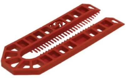

If you intend to plank that and get it perfect the shimming might also prove to be an exercise in frustration. But forget about the shim machine - plywood comes in 3, 4, 6, 8, 9.5, 12.5,15, 19mm, etc ex-stock from builders merchants and even DIY sheds and can be readily ripped into shim width stock then crosscut - all with a small circular saw (fitted with a rip fence), whilst thinner shims are could be just graduated plastic horseshoe packers, like those we used for door frame installation:
That's a Broadfix one - they come in 1, 2, 5, 6, 10 and 12mm from builders merchants (or SFX/TS) and can be used in conjunction with plywood shims.

Yes, the floor will be coming up for levelling. Borrowed a laser level from a friend and walked around the room with a stick. 1 1/2" variance overall - though I need to double check the level. But a good 1/2" between adjacent joists in the middle of the floor - that was the bit I could feel just walking around.

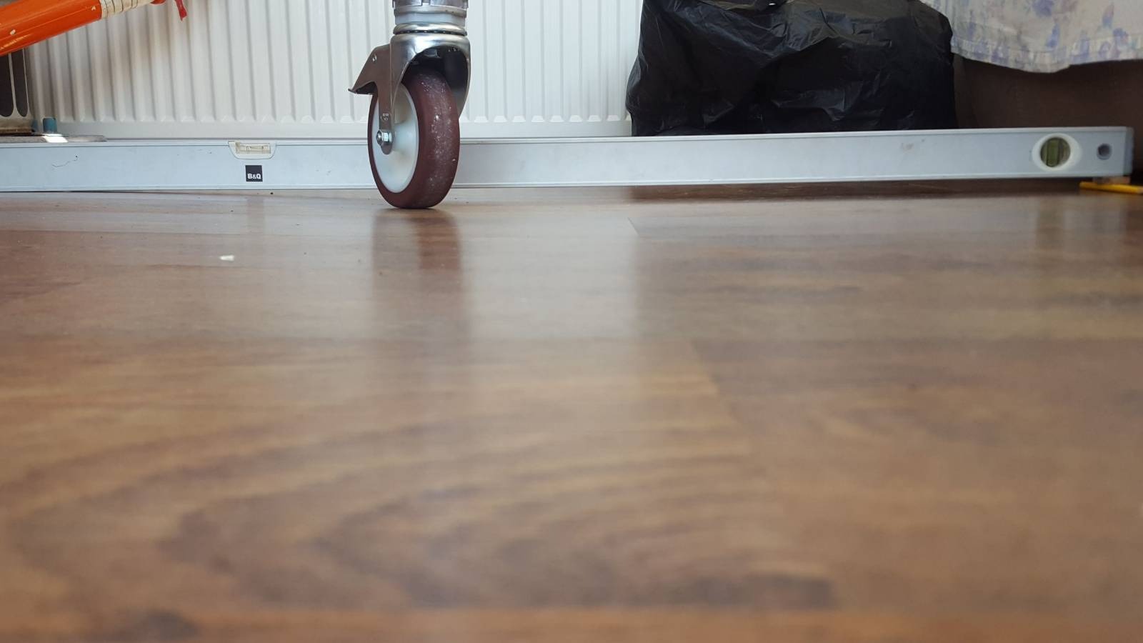

For good measure, I put the heavy rad that's in the background onto a dolly to wheel it around. Moved it out of the way, pushed it back to the wall, let go and ... it rolled away from the wall :rolleyes:

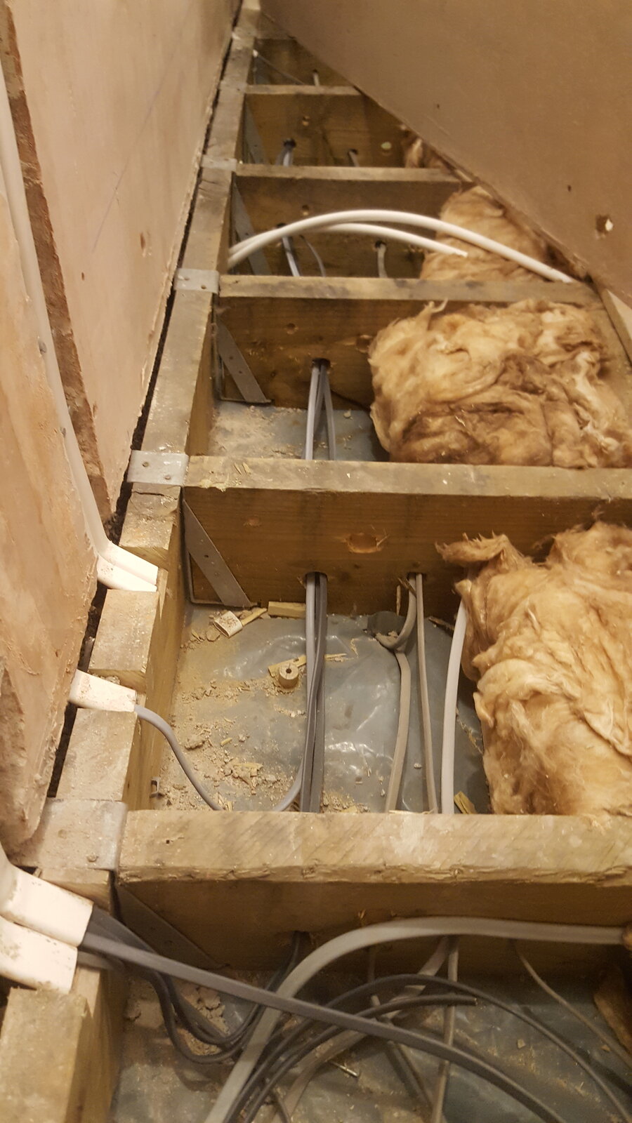

I've now had more boards up to do more of the wiring. I think I can see a "slight issue" here :rolleyes:
Might explain why the floor slopes up at the edges.
He also seems to have had a random position generator for drilling holes - they are every which way (including diagonally) except where BRs permit.
I'm adding some extra bolts (concrete screws) to the wallplate which seems to be an "interesting" shape. I don't think there's a problem there, but they are a doddle to add, I've some left over from a previous job, and I've taken a bit of strength out of the wallplate to get the conduits in.
Having fed some cables across the room, there seems to be 2 sets of noggins. The first is about half way across the room (to the right in this picture), and then there's another set about 3/4 across - and I assume that at the other end the joists are sat on the flange of structural steelwork, but I've not lifted any boards there yet. It's a 4.1m span with 8x2 joists - so from this end, hanger, 2m span, noggin, another 1m, noggin, another 1m, sat on steelwork flange (I assume).
Given that these hangers at this end don't provide any rotational control (they just hang from the top of the wallplate, and there's mostly a clear gap all the way down between hanger and wallplate), would you say the noggins are sufficient ?
And should I be worried about the holes, or work on the principle that the sizing tables for joists are "fairly conservative" ?
