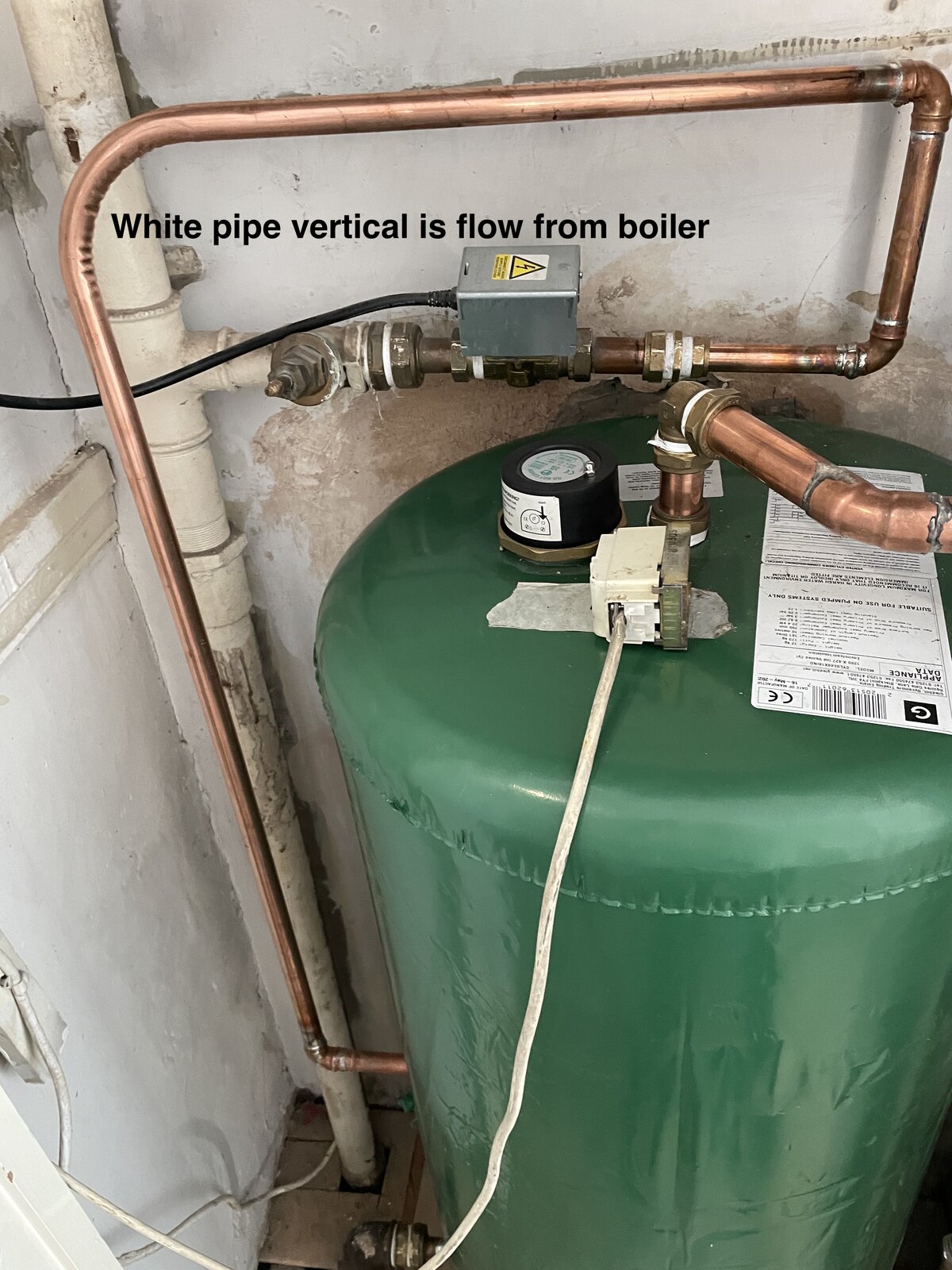

The new cylinder went in today - Here is a picture
I have not connected the thermostat yet to the cylinder and also switched the two port valve to always be in manual mode meaning it should demand the boiler flow first.
I notice two things which are puzzling but remember the pipework went from 1 inch steel pipe to 22mm flow to fit in the cylinder. I have left the heat only boiler to be always on
1) The water coming out of the cylinder is approx 50 degree - And not red hot - I would have thought that with the two port valve in manual the flow will heat up the cylinder so it becomes red hot (more like 80C). When the shower is switched on and it is at the maxmium hot setting it is warm but not red hot. The same from the tap
2) The radiators are getting hot even though the hot water cylinder is not been heated
I put this down to the volume of water from the flow being high and then restricted to 22mm so carrying on into the radiators (remember this is a one pipe system)

As above, the big loop you got from the MV going up, over and back down to the Primary Flow connection is likely to be full of air. Advise you reconfigure, flow needs to drop back down from the MV to Primary flow tapping, any air will then go straight up the Vent pipe and out.
The vent pipe is much much higher
I could not get the flow to come down the side because of the tight space
The flow pipe is red hot all the way through to the cylinder

I don’t think you are reading the situation properly!
How does the air get released from the cylinder flow?
Yo probably have a flow rate of 1 L/min. If you’re lucky!
Especially on a single pipe system! If that’s what you said it was.

Thanks - So firstly there is a vent pipe from the hot water draw off much higher into the loft. I am sure you know that
The air that is in the flow gets released through the F&E tank - When i filled up the system I saw a lot of air getting removed when the system was getting filled and I bled the radiators. Kind of like a gurgling sound.
There also was not a manual air valve in the last cylinder which I took out
Are you suggesting i need a bottle vent and if so would it sit at the highhest point of the flow from boiler which is in the loft or somewhere else.
It’s obvious you are not a plumber or a heating engineer now!
Yes is the answer! On the highest point on that dead loop!

I am a DIY man trying to do it myself because of funds and because I enjoy it - If there was air in the system would that not get pushed all the way up the one pipe flow and therefore the air vent needed in the loft rather than the hot water cylinder? Please educate me so I do not make a mistake
Do you mean the cylinder primary return is at 50°C? That's what I would have assumed, but then you refer to the shower, which is obviously on the secondary. You wouldn't want the 2ndary to be anywhere near 80°C, if that's what you mean.
Does it behave different from the old cylinder?
Have you tried throttling the rad pipe, at any valve as it's a 1-pipe system? To force the water through the coil. As somebody said, an air vent (manual) in the horizontal pipe would have been a good idea, but pushing all the water through the coil should push the air round the system and out via the vent (can't remember where that is).
