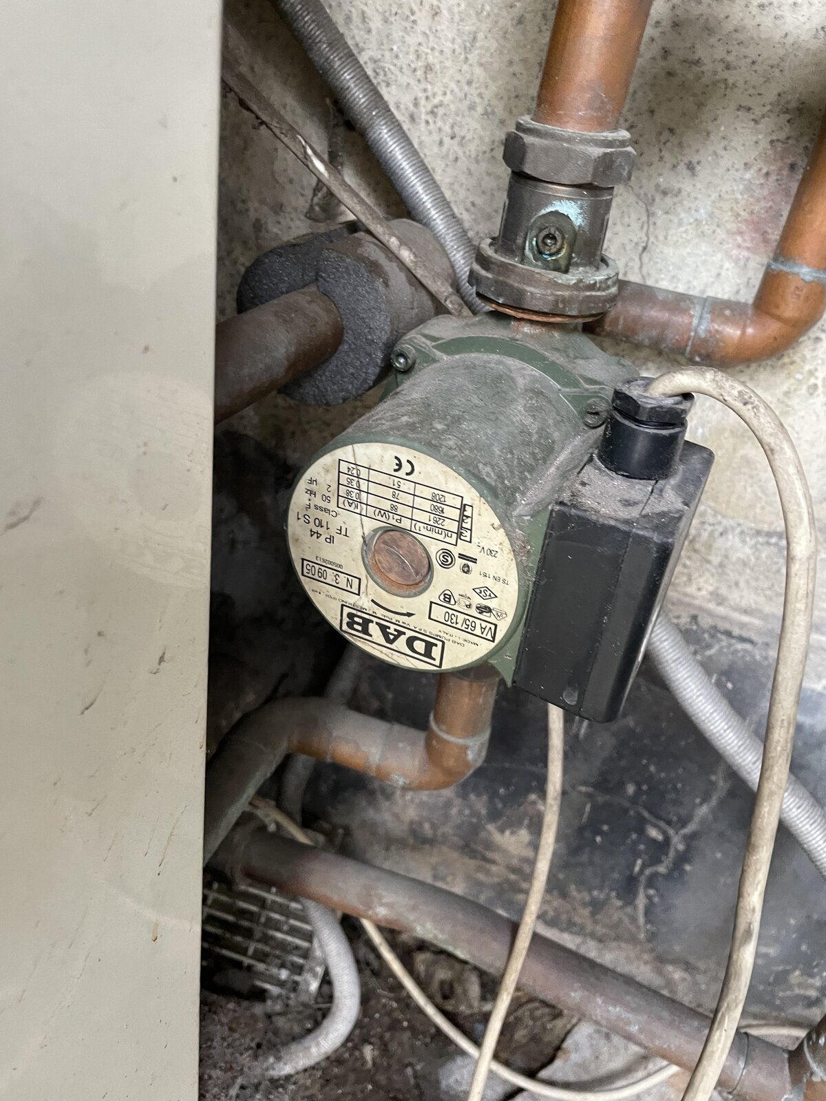

Thanks - I mean the water when you open the hot tap is only lukewarm and certainly not red hot - I normally mix hot and cold water to get a good temp whereas now I only use the hot water tap.
There is no way to throttle the radiators as there is one big flow pipe which then tees off for the hot water cylinder and then continues for the rads. Previously all the boiler flow water would go to the cylinder - Now it seems that the radiators are taking it as if the flow pipe is not getting round the cylinder
Is it an idea to adjust the pump speed? Here is the pump at the boiler - Is this set to max or min

Think you're missing the point made previously. Air will collect in that loop up and over the MV. Cut in a manual vent.
I am a DIY man trying to do it myself because of funds and because I enjoy it - If there was air in the system would that not get pushed all the way up the one pipe flow and therefore the air vent needed in the loft rather than the hot water cylinder? Please educate me so I do not make a mistake
Right mate. That vertical rise from the motorised valve and then down to the cylinder flow will be clogged with air apart from what is displaced by the system head pressure.
Fitting a manually operated vent will eliminate this but I would recommend an automatic air vent personally?
This will get rid of the trapped air and ensure it stays free of air.
Let us know how you get on!
Increasing speed would give a better chance of getting flow through the coil.
Can't tell, the adjuster is out of shot. But it should be marked for speeds 1, 2 and 3.

3) actually was thinking of reducing speed so it had time to get round the coil rather then flow up quickly into the hot water and then the rads
4) The pump pic is clear - I can post another another
Isnt it the dial at the front of the pump with an arrow on it that controle the pump speed?

22x 15 centre tee on top of the cylinder flow with 15mm automatic air vent!
Vent it S l o w l y if you go manual. It’ll work a treat

Air is lighter than water so rises to the top!
Look at your photo and determine the top of your flow pipe.
Let the air out and it’ll work!

Thanks - I can see what you mean - A 22mm tee soldered with a vent on top
I will put that in as soon as I can
