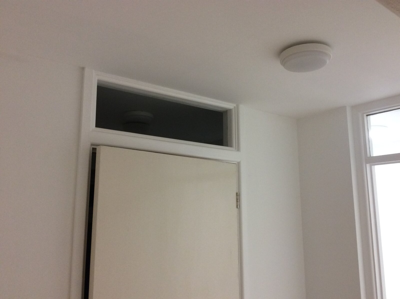

Just a quick question, I am thinking of replacing the current light in my downstairs toilet with a downlight, does it have to be IP65 rated. There is Just a toilet and sink

If you want a very small point source of glaring light which all it'll do is cast shadows & darkness in areas not directly under it, sure. Doesn't need to be IP65.

You may not be able to put DoWnlight in the same place as the existing (pendant?)..
it will be mounted either on a hoist or on a piece of wood (aka noggin).
You would therefore need to find a clear area of ceiling with no obstructions. And need to move the existing wiring to the new location.
Maybe easier to find a different surface light, and abandon the downlight idea.
272F42FB-280F-4732-A3FE-ED83789C5931.jpeg Have a look at SF no 601cc lap ip44 bulkhead light. Ive fitted a few and think a bargain at just over 7 quid
Edit: about 170mm Dia by 40-50mm high
