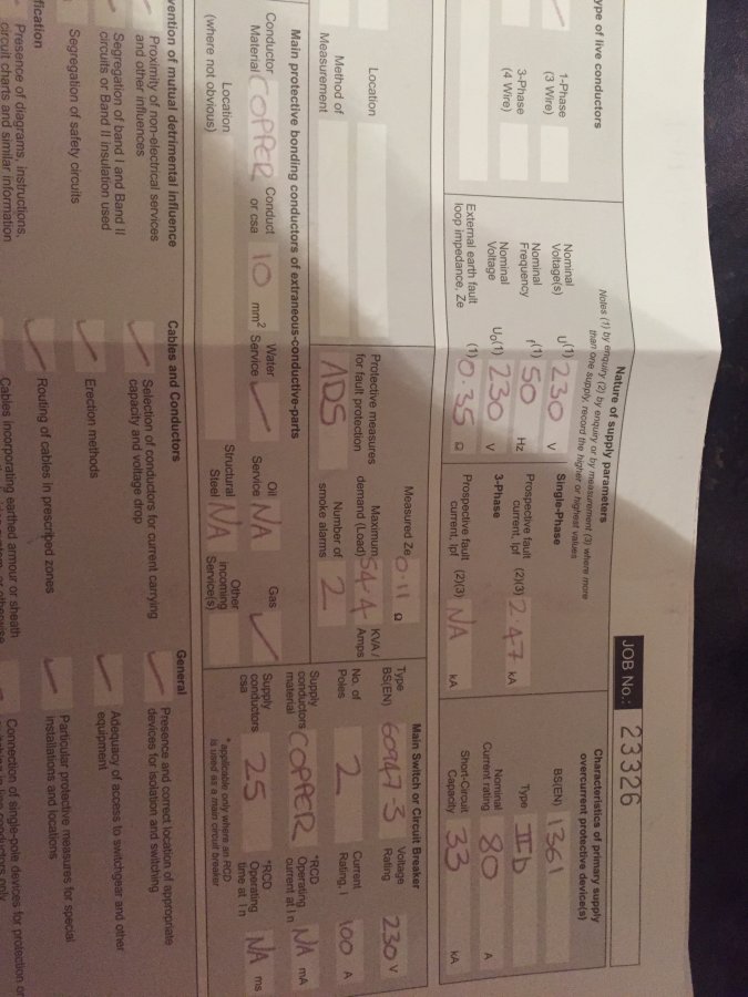

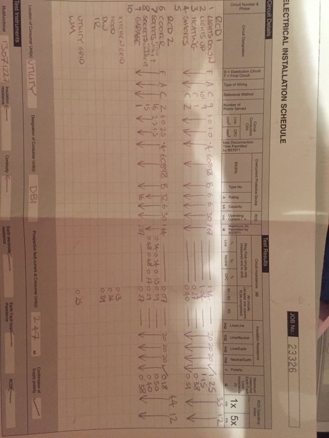

Whats that test sheet in the background, readings for the rcds should not be all the same, should they.
Need to see that to determing the burnt out cable size, for 32 amp it should be at least 4mm
Of course they should be! You test two RCDs, you don't need to test the same RCD from the end of each circuit.
The max measured earth is The test results R1 + R2 + 0.11 on everyone?
Nothing wrong with that. It's encouraged these days. You must do R1 + R2 before putting an installation into service. You may then calculate the Zs. It won't take account of parallel paths, but this means your figures will be larger, not smaller, which errs on the side of caution.
It is now discouraged by most trade bodies to carry out live testing where not required.
