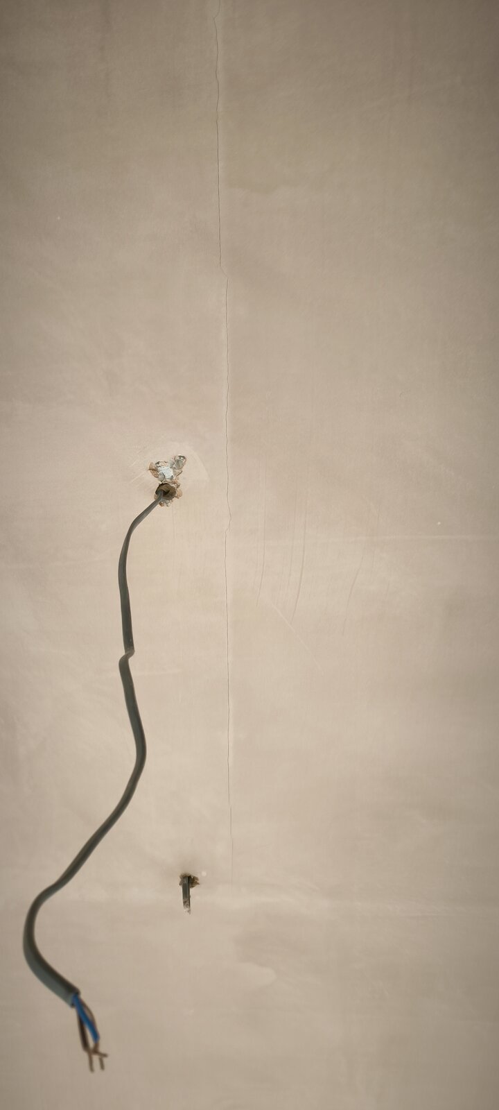

Send a picture if you can.
There's hairline cracks and there's hairline cracks.

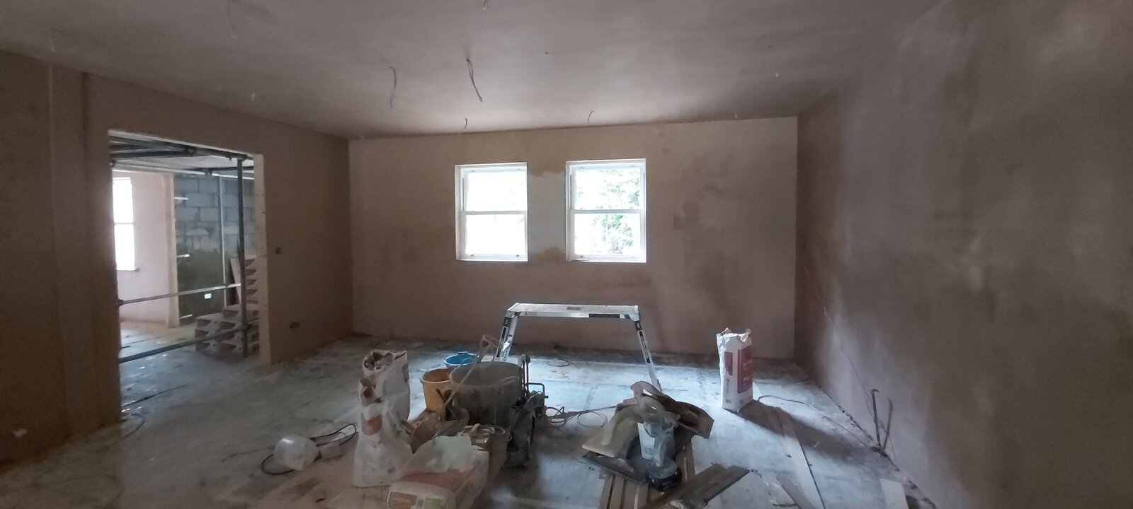

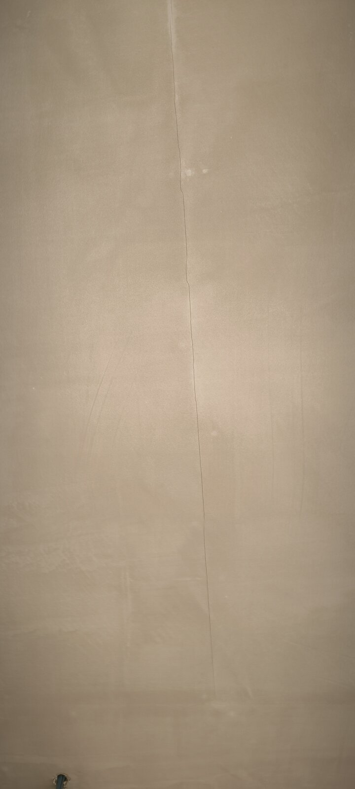

Here are some photos I took a few days ago. Maybe I will take some more photos tomorrow.

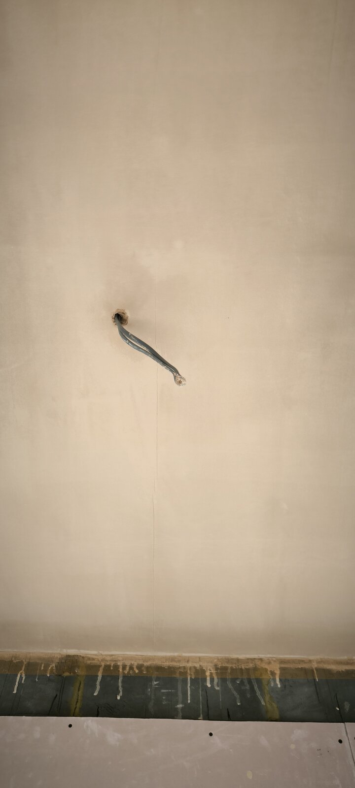

Same ceilings freshly plastered a month or so ago

They are quite noticeable, aren't they?
Had wondered if they were very fine cracks, filling may have the answer, but they are so long and wide.

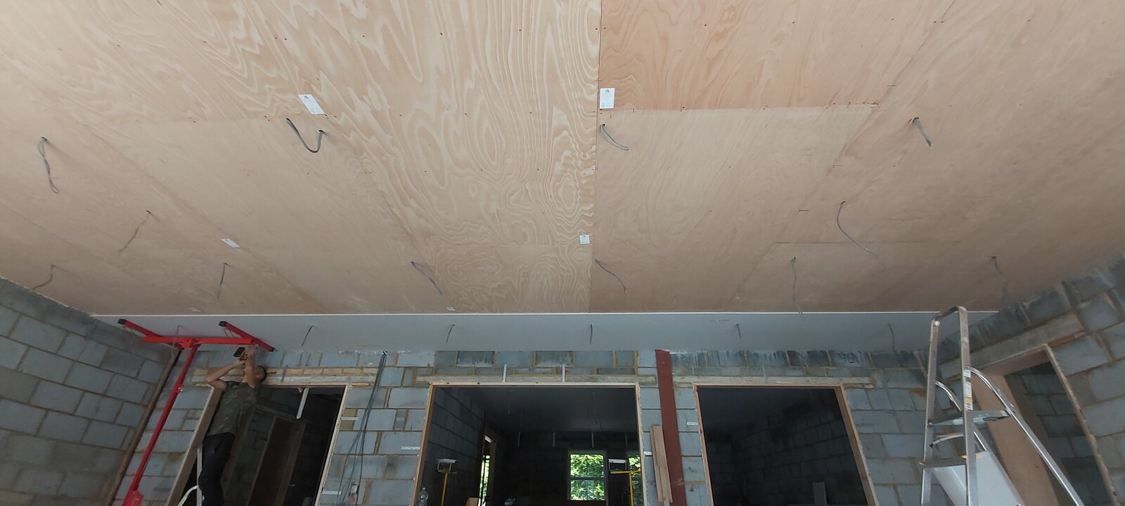

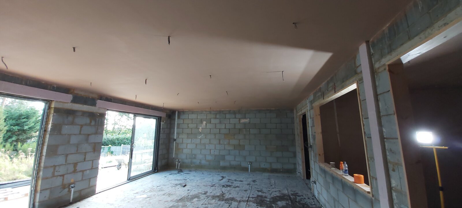

The joists have first been covered with ply. Then we placed the ceiling boards. About 30 screws per ceiling board and 30 screws per ply board. All ceilings in the house, in all rooms but 2, have been done in this way. The kitchen and living are the only two rooms with cracks and they were among the last rooms to be plastered. If there was house movement or similar we should have had cracks on the other 8 rooms. In addition, 5 or 6 of the other rooms had no tape in joints. So much so that I was promised to get cracks due to the lack of tape in joints. The rooms that have cracked, apparently were taped religiously ( I did not witness it and have no photo evidence ).

6) plastering conditions - first round of plastering ceilings was done in May and June, weather quite warm and dry ( no cracks ). Second batch was done in October, weather wet and cold at nights ( lots of cracks ). House is not heated.
7) tape used on joints: the ceilings that have cracked have tape on their joints. It was something discussed and agreed with the plasterer (he is meticulous and would have done it regardless). The ceilings that have not cracked have no tape in joints. Go figure.
8) Plaster thickness : the two ceilings that have all the cracks have visible (different colour) joints and you can clearly see the plasterboard outlines after the skimming, even now. The ceilings that have not cracked, you could not see the plasterboard outlines at all. Does this imply that the ceilings that have cracked have had much thinner plaster put on?
