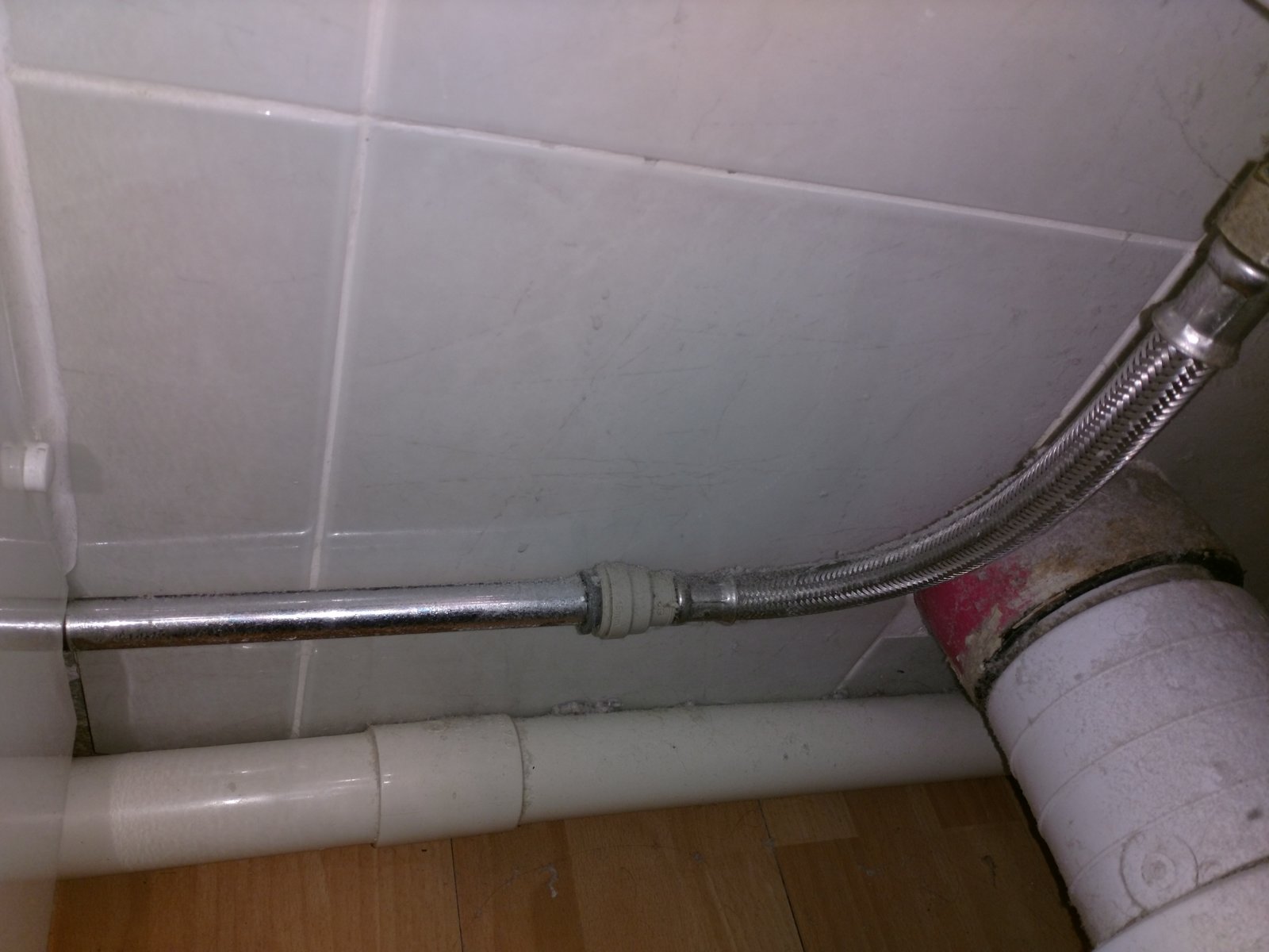

Oh dear ! Push fit on what looks like a chrome plated copper pipe . not good at all ,not good AT ALL. Could be in danger of coming apart at any tme.

One more quick question. Is there something I can buy to terminate the flexi hose in case i need to abandon the work. Otherwise I won't be able to switch the water back on.
I am thinking of leaving the current one on there as don't fancy mucking about with a push on connector.
Push fit connectors on chrome plated copper pipes are a big no ,no !! Unless the chrome has been filed off the end of the pipe ,before its inserted into the fitting , up to about 20 mm from the end of the pipe ,it is likely to pull apart. You should never use a push fit straight onto chrome plated pipe, it could blow off at any moment. The flexi with a built in isolator ,as linked above ,is a compression fitting ,to your supply pipe.and is fine to fit onto the chrome plated copper pipe that you have. If things dont go well with w.c ,you turn the iso valve off ,and the rest of your house water can be on.

It must be pushed onto copper as has been on for 12 years. (Not put on by me)
So does the push fit just pull off with a bit of force and the new flexi is easy to put on the pipe?
Thanks again
I think you are very fortunate that it has lasted 12 years cos looking at it ,I think it had just been shoved on . the compression joint on flexi to supply pipe is made using two spanners ,or one spanner and a good pair of grips.one holds the valve body to prevent it from turning and the other tightens the nut ,compressing the olive onto the supply pipe. To remove the old push fit flexi ,with water supply off obviously ,press the dark grey ring inward ,into the white body of the fitting,whilst turning the white fitting and pulling away from supply pipe at the same time.
Ha ha turns out it is just cheap chrome looking plastic on the pipe so assume the push on connector is on copper.
