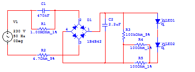

This is the basic wiring diagram for a cheap LED lamp, R3 the 100kΩ resistor is there to make the LED's switch off quickly and to stop them lighting due to capacitive and inductive links in the wiring. Designs will vary and so will the resistor size so fit one make and it will work fine, another will come on dim, and a third will flash. Adding another capacitor or resistor across the lamp will stop the flashing etc, but swap the lamp and you could be doubling up on the drain. Our whole aim when moving to LED is to reduce the power used, little point if we install with the LED's devices which simply use power for no good reason. Be it a glow panel, a PIR, or a timer it is very easy to reach the point where control devices are using more than the lamp.
My son was looking at some LED lamps with Wifi seemed very good until he realised the Wifi bit would use more power than the lamp, better to simply leave the lamp on 24/7.
I think we all need to re-think with LED lamps exactly what we need and want, with my lamps swapping the lamp for a slightly larger one cured the problem no need to fit bits inside the lamp fitting.
